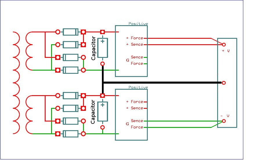

Salas, do you have a simple schematic on how to stack two positive supplies to make one negative?
Is it the positive of second and ground of first tied together to make it virtual ground?
Here again. Its also in the Ref-D pdf build guide. Take notice, two independent secondary and two bridges are an imperative. "G" are sense zeroes. This artwork was drawn by RCruz if I remember correctly.

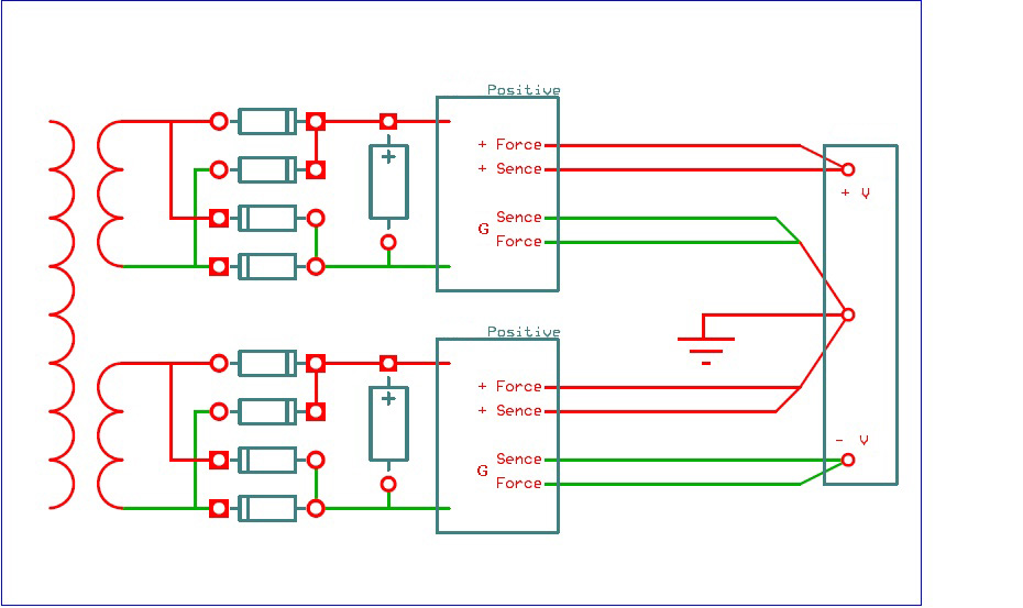

Wouldn't it be that more appropriate ?
As I see it, nope.. If you connect it like that, you are not really using the bottom ref-d. Your "negative" rail is unregulated and at way higher voltage than the positive rail.
Can't see why that should happen, done it with monolithic regulators. I don't know if it gonna pick up noise though.
This is not the same. Chips may have one sense terminal but here there are two. You have shown it sensing at the load but you don't do that for its zero return point also. So first thing is there are sense terminals that you have to short with their respective force terminals in your example. Isn't even working like that.
After having them all closed (two wire mode) its possible you transfer your zero returns node back near to the raw DC area but its dirtier when so close to the reservoirs and even further from the now at output connectors closed sense points. Creating a wider loop area for no benefit in other words. Increasing the possibility for noise pick up as you already said. To picture it better, when current is send down a physical path it wants to follow the closest distance path to it back for returning. Imagine if all that was a ground plane and you had a plus and a minus wire on the other side, the return to zero currents on the copper plane would naturally try to go flow themselves back directly underneath those wires.

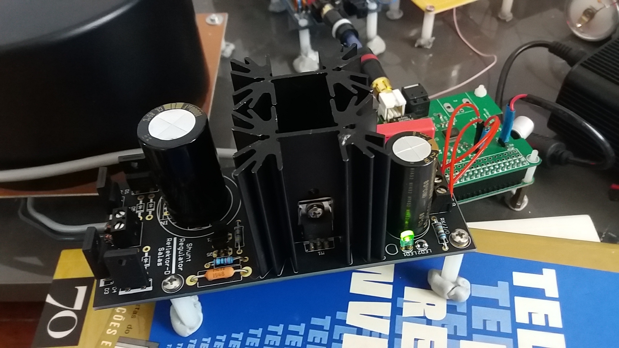

I conected one of my Ref boards I have since more than 2 years ago, to the Amanero board and I installed a 1ohm resistor in R1.
It significantly improved the sound, as before this Ref board had 2ohm in R1.
I also installed a Jupiter cap in C1, (0,1uF), the best of Jupiter range. It seams crazy and I know that many times better parts do nothing, but this cap improved the sound, adding more fine details and subtle sutff to the music.
What is an issue now, is that the heat sink gets to hot!
What should be done here?
