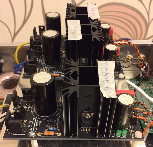

I've 3 Reflector D for powering my Soekris dam1121 board.
Two 5V with CSS 0.3 (R1 – 2 Om) for powering +-5V R2R ladder. Max current consumption – 50mA, typical – 20mA.
One 5V with CSS 0.6 (R1 – 1 Om) for digital line 5V. Мax current consumption – 350mA, typical – 250mA.
All lines have one common ground point in the vicinity of dam1121. 4 wire connection.
All works fine.

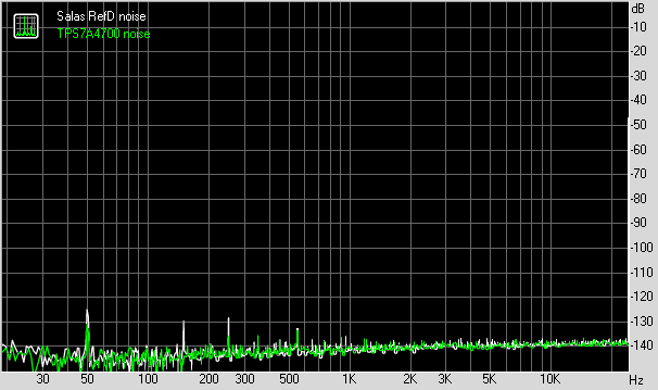

While experimenting with different power supply cards, I’ve noticed some strange and quite big spikes at 150 Hz, 250 Hz (see noise spectrum graf from RMAA 6.4.1 measurement software, output from R2R ladder).
They are quite big comparing with LDO TPS7A4700.
Is it my mistake or feature of Reflector D?

The white peaks are taller than the green by 5 or 6dB at 50Hz and 250Hz. Same height at 550Hz. Those are common between the reg cards compared powering. The 150Hz is alone to the white. The random noise grass is the same between them. Maybe its the measurement limit or the DAC's limit. Those very low level needles are mains frequency harmonics at around -130dB. Must be what is picked up by the voltage output cabling. Or somewhere else in the whole build. If they were residual of the two regs they would have been based on a 100Hz ripple spike. Try two wire mode too in case its the sense loop picking up. Or try shielded coax for the sense and compare to before and two wire mode. Keep the best looking or the best sounding if you can hear any change because those needles are way too low in dB for directly listenable. But they can imply some general little improvement if battled further (doubtful).

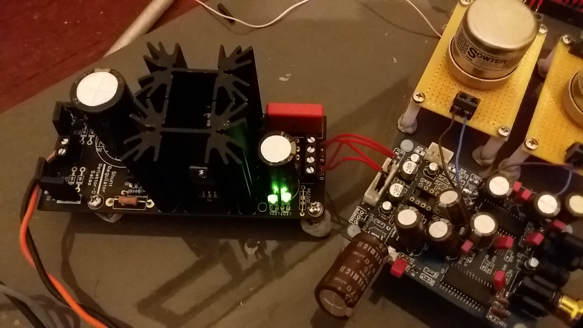

Hello, finally i fisnish one Reflektor for 5v.
rr-2ohm
it´s powering my lampucera board.
the sound is very good (only half an hour playing)... no moods only the stock parts with the resistor r6 in place.
i have more boards.. maybe a try another with different parts..
the sound is very powerfull and clean very very good
thank all!!!

Great. Nice to know! Don't forget to try JFET VS R6 mod also to see what you prefer better in your own application among other different parts.
i will do that... just listening for a few days like this...
i was using an double lt3042 from another member... was very good too... but...
i think this is even better... more dynamic and cleaner sound.
