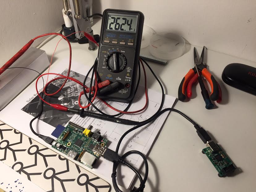

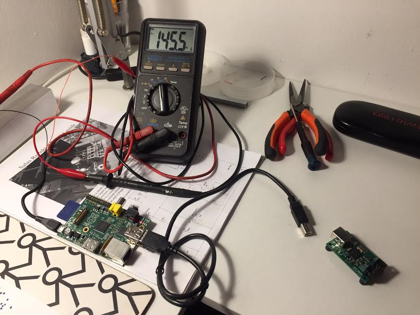

More test's...
I could not resist trying a PI with the Reg. -And good thing is, i figured out excatly how much the Xmos usb to i2s use. (~120mA)
Well i don't know how precise my DMM is, in the mA state, but 120mA sounds pretty good/normal for me.
Jesper.

Pi has pretty nasty and noisy usb port. Additionally in the pi model you have usb share bus with LAN. Pi also has jittery I2S signal without MLCK. Moreover from what I see your xmos model is the old one with low processing power compering to new xmos216.
In your case I would skip usb and xmos and use Hifiberry Digi+ Pro hat instead. It delivers MLCK (from two onboard audio clocks) to pi to generate bitclock and treat pi as slave in this regard. In return you get very very low jitter I2S signal (with MLCK) straight from hifiberry hat with which you can furtherly feed your AD1856 R2R directly.
First off here, thanks for all that acknowledge; i did not see a new pihat with clocks and i2s out before 🙂 -Sure i have been studing that today.
Anyway i need (for now) the xmos, witch will be externally feeded by one of my Reflector-D's... trick is to remove a little SMD resistor/fuse/cap. whatever on the pcb. https://hifiduino.wordpress.com/2013/04/16/got-the-xmos-384khz-usb-interface/; Case is that i would like to try the Tidal Masters https://support.tidal.com/hc/en-us/articles/115000397069-TIDAL-MASTERS; and for now only solution is with desktop application connected to an USB Dac.
Regarding the clock, i have not been studying this much right now, but i think that DAC will use the clock's on the USB to I2S interface ?
I think that supplying external power to the USB interface, i will get rid of most of the noise from the PI?

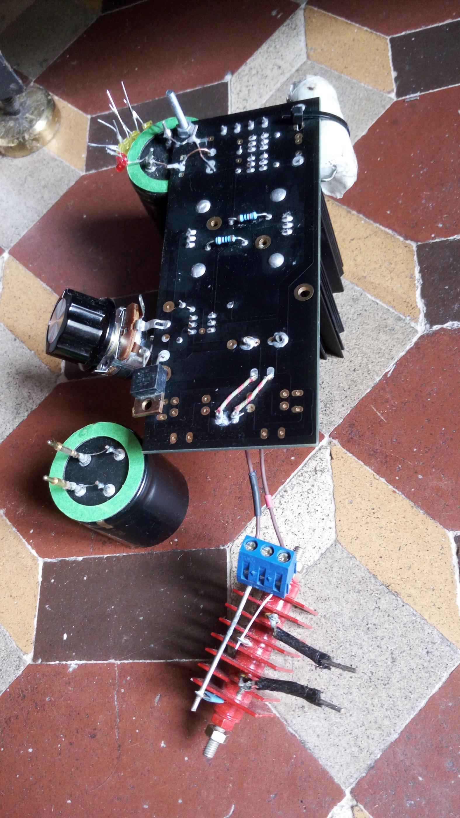

Thanks letting me share, please forgive me I must ask in advance.
On my last Ref-D build (12,8v supply for Class T chip amp) Ref-D has outperformed Bib light years ahead.
New additions are a second Mundorf (CM-6800uF) as seen in pic and a selenium diode bridge.
Resistor R1 is in series= Caddock MP 2R2 + 3R wirewound pot.
After adjustement while music playing, I set 4R9.
Pretty low power for a whole integrated amplifier! But further only to 4R8 is enough to downgrade the performance.
