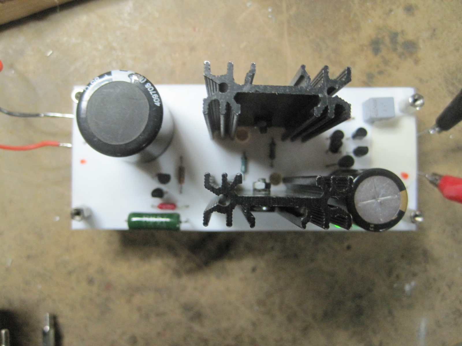

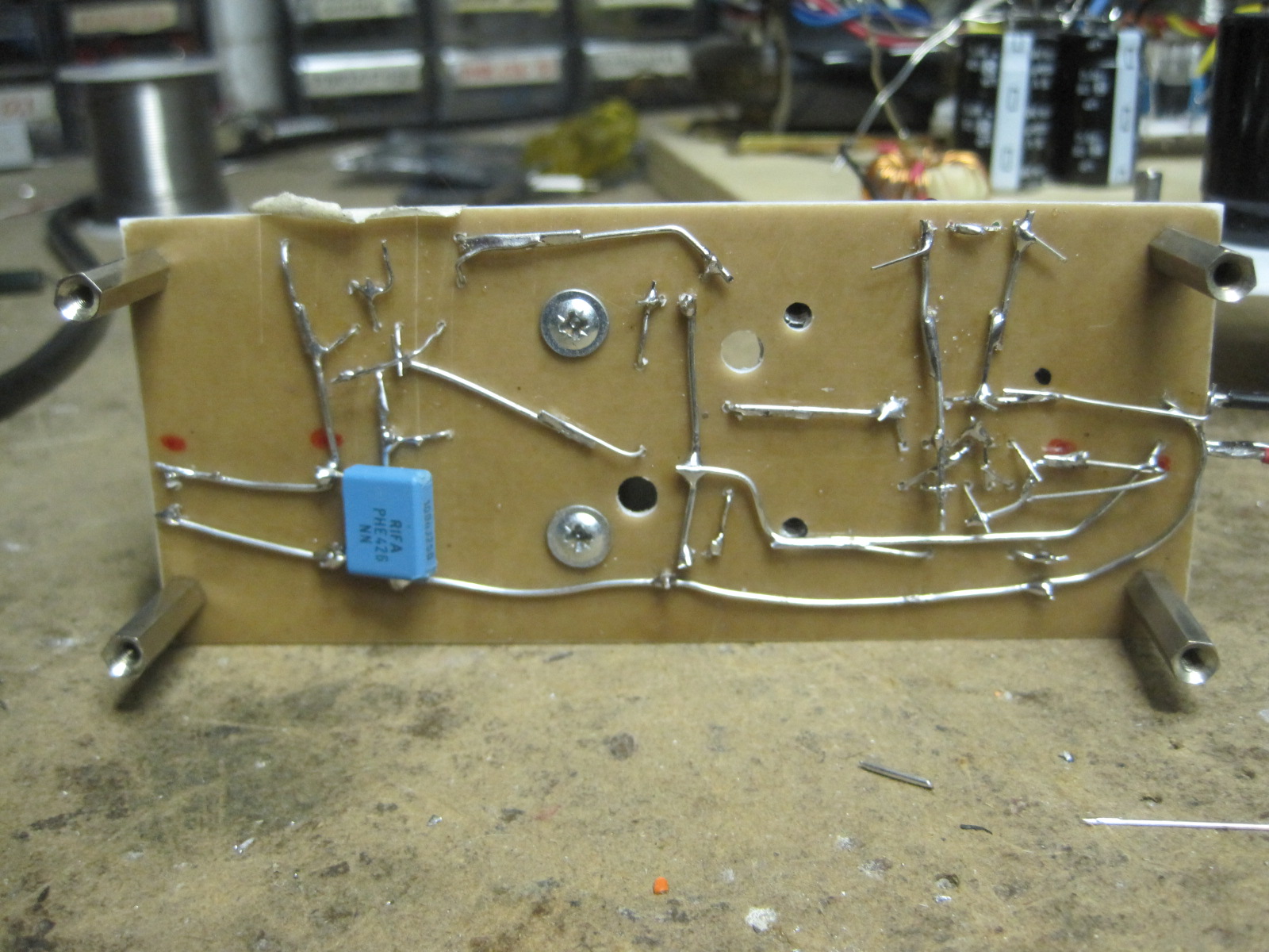

Hi all,I just build five reflektor d for all my digital items. SSD hard disk, Cubieboard, CDPRO 5v, TPA Metronome and BIII. I build them on teflon board point to point.
K 117 in place of 1k resistor .I'm very satisfied with sound quality. the clear voices and shining highs are the highligths. But also dinamic and sense of being there are outstanding.

Looking good. I remember alike Teflon handwork in SSLV 1.0 by a Greek member Marinos, and now I see from you, maybe there was another case or two, but its generally seldom to see.
I always work with teflon 2mm thick, cause is relatively inexpensive, easy to cut, don't melt at hi temps and at very hi frequency the dielectric coefficent
matter
matter

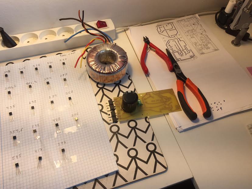

I am finishing my proto pcb for an "special" ReflectorD build for an RaspberryPi B.
The PI need's 4,75 - 5,25 VDC (Min/Max) voltage, and uses around 400 - 800mA depending on load.
Well i would use IRF9640 instead of the IRF9610 for this setup, and 0,56ohm for Rset for approx. 1000mA CCS according to the buildguide.
Those things was suggested, but i need to know, what the approx. voltage drop will be, when calculating the Vout. I would like 5.10VDC out, but maybe the regulator has to be calculated for 5,30VDC for giving this?
Hope somebody here can answer this?
Jesper.

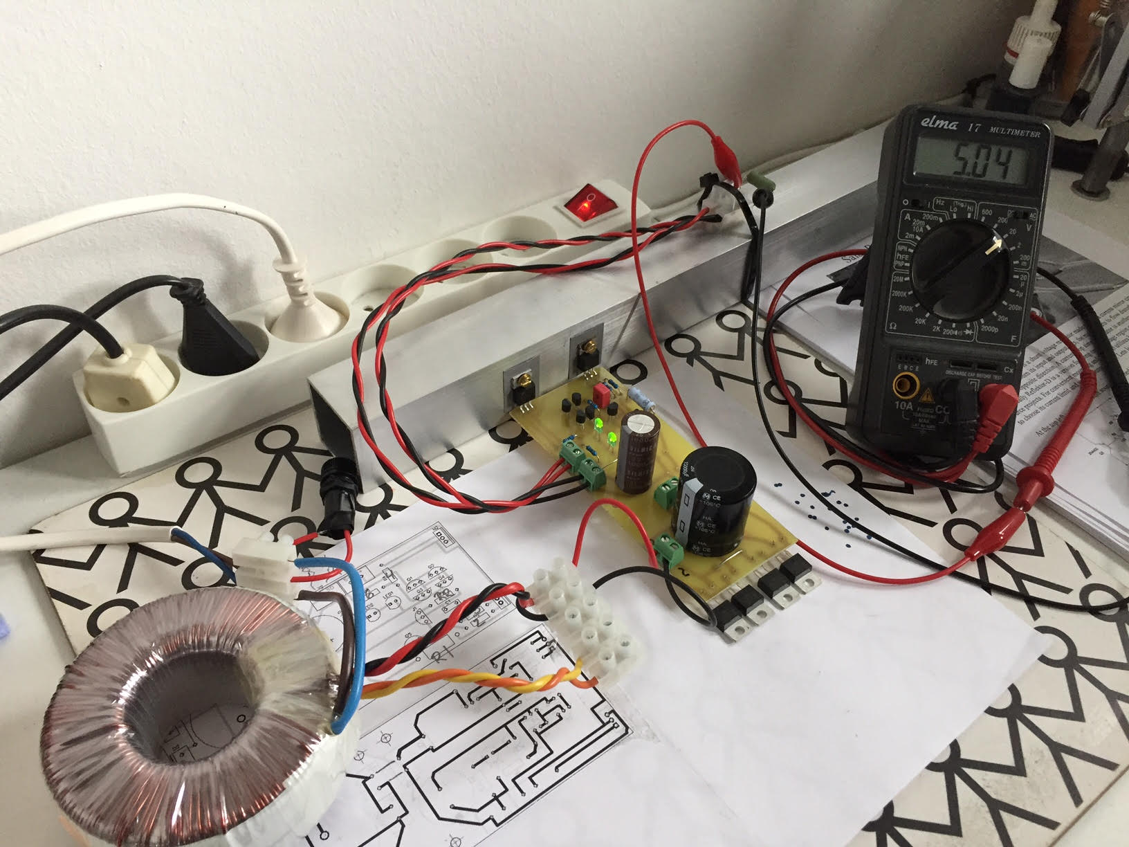

Hey here 😛
First fireup on this shuntreg. was success 🙂
First setup is loaded with 5.04 / 20 ohm = 250mA
The voltage (5.04 VDC) is excatly was the LED's *2 + 1.22 was giving me. I was not thinking, that there was no voltagedrop, but is it right that this voltage will be stable until CCS (0.61/0.56=~1000mA) is reached ?
I will find another resistor, and try to load the reg. a little more now.
But! --- It is getting hot
But with some good sinks, it will be doable i think; my transformer is delivering 12vac, which does not make things better.
Anyway i now know that my pcb is working, just wishing i had a scope right now 😱
Jesper.

Hey, its ticking. The more loaded the less heat from the output Mosfet. For output voltage drop don't expect a lot. Can't say how much in your arrangement, depends on heat proximity to the four BJTs mainly. Load it heavier and see.
