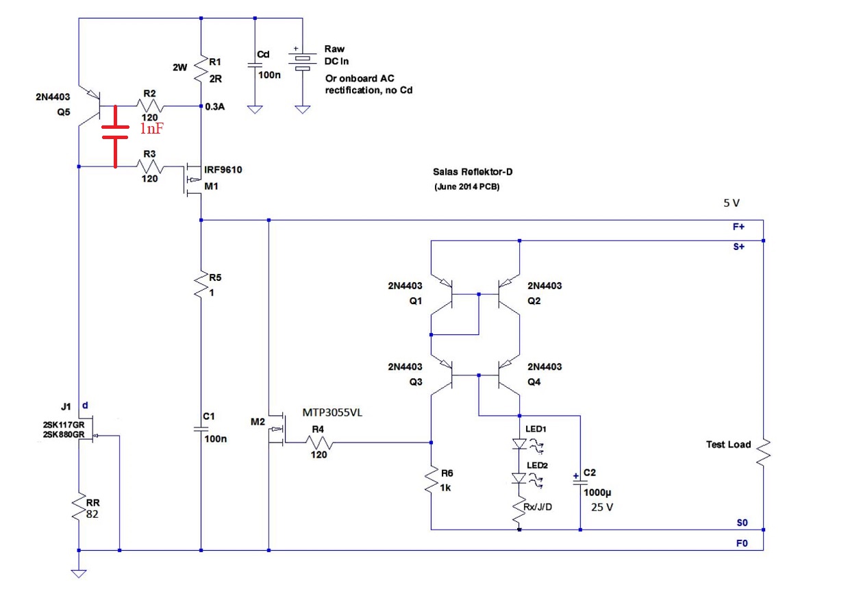

What would be the effect of a small cap in this position?
I am using a Reflektor-D, built from a Tea-Bag supplied kit, to power my Twisted Pear Buffalo 3SE board.
I plan to upgrade the DAC to TP's new ESS9028 based Buffalo board but it demands more current from its power supply, specified as 750mA. In my build I will only need about 720mA (because I don't use the Buffalo's onboard oscillator) but this is still well beyond the Reflektor-D's capability. Is it possible to modify the Reflektor D to deliver this level of current?
The Ref-D's current ability is a matter of sinking mostly. The spec limit is for the certain on board sinks. Its a conservative current spec not a break down spec though. If you have the bare minimum Mini version for example, which is externally sinkable only, you can readily bolt it to larger sinking. If you got the full version with the onboard rectification and sinks you can either affix a mini fan on them as they sit close together forming a hollow square top, or remove them and extend the Mosfets pins to sink them externally.
A quality mini fan can be used with under-voltage to 2000-2800 rpm where it should be quiet. If you will need set for more than 850mA, especially when without forced cooling, better replace the the IRF9610 with a Fairchild FQP3P20-ND. Tad slower by gate input pF number but significantly cooler in its core per dissipated Watt. Then you can go over 1A even. As a rule of thumb don't allow much more than 55C on sinks for good long term reliability. If they don't suffice for that make them bigger or cool them.

Thanks Salas, I have the full sized Reflektor-Ds with onboard heatsinks.
So, if I keep the board as is except for swapping in the cooler-running Fairchild device and changing the current setting resistor (R1 = 0R8 will give about 760mA total current) it looks like I might be able to get 720mA the DAC would need - I don't have space for a fan or off-board mounted devices.
The Buffalo 3SE DAC board obviously has its own local Trident regulators following the Reflektor-D
The dissipation of that Fairchild will be the same of that IRF. Because the voltage drop and the current in the circuit dictate that. Its just that the Fairchild will be safer on a pushed current and small sink situation because it has better θjc i.e. transfers heat from its core to its case mounted at the sink more efficiently than the IRF. Safer, but up to a point of course. For more on thermal design basics this is a good read: http://www.analog.com/media/en/training-seminars/tutorials/MT-093.pdf

If I use the Fairchild FQP3P20-ND and use large external heatsinks I should be ok if I set it for 800mah ? I would use aluminum angle iron mounted to bottom of aluminum case with the heat sink mounted to the angle iron.
