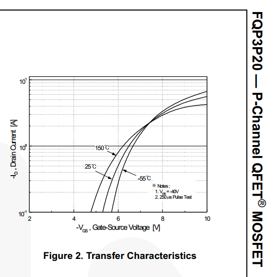

FQP3P20 you use for M1 shows about -6V Vgs at 0.5 to 0.6A drain current in its datasheet depending on its temperature, batches and samples also differ, so your reading is OK since your one Ohm resistor should be having ~0.6V across it. In other words setting circa 0.6A CCS. M2's Vgs is alright also.
The 3N50C uses up more voltage than the 3055 would but at 5.25V output and 3.8V Vgs there is still marginal threshold to the mirror transistors for the reg to keep its spec.

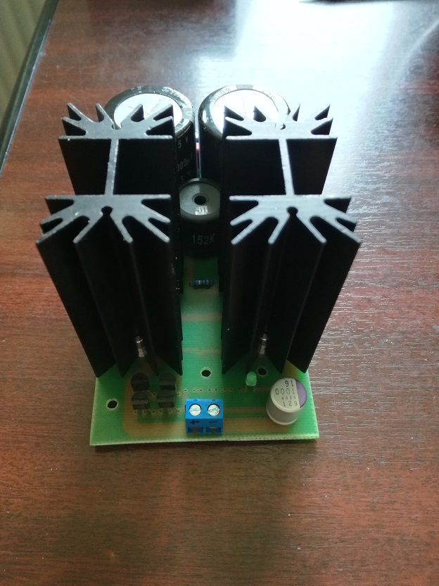

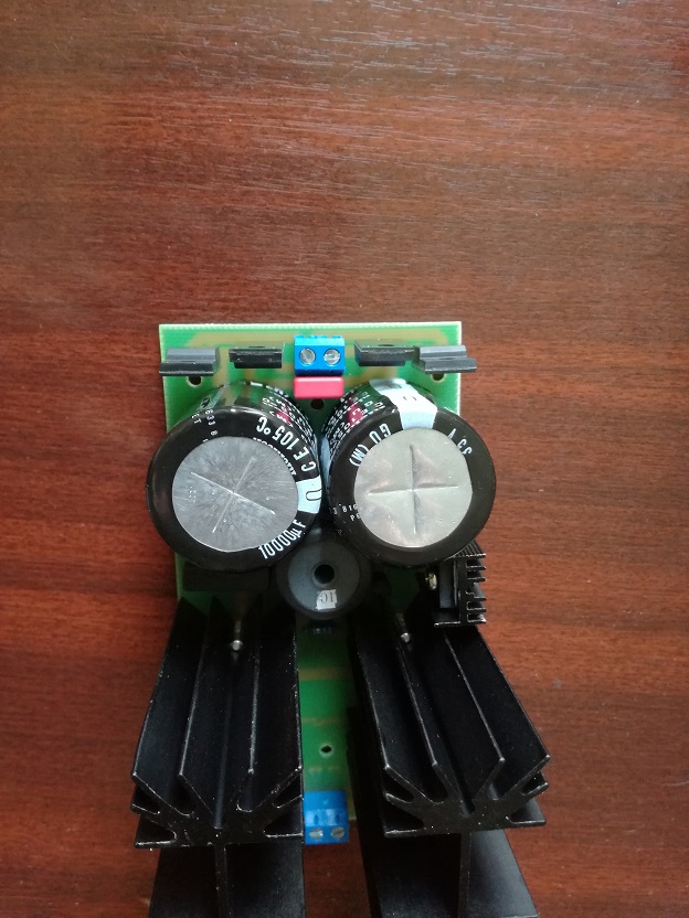

This is how my boards looks like, I am very please with your design.

Own design boards Using CLC pre-filter and 2wire output scheme only I believe?
Thank you !I just removed the links.
Yes you are correct ! 😀
What's on the small third sink? A thick film ceramic back CCS setting resistor?
It is a TO-220 style resistor

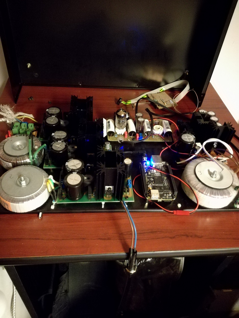

I have two boards with 1ohm Bourns resistor and one with 0,75 ohm Caddock.Caddock?
I know that Caddock is better but I can't find it in EU, so for testing purpose I use Bourns.

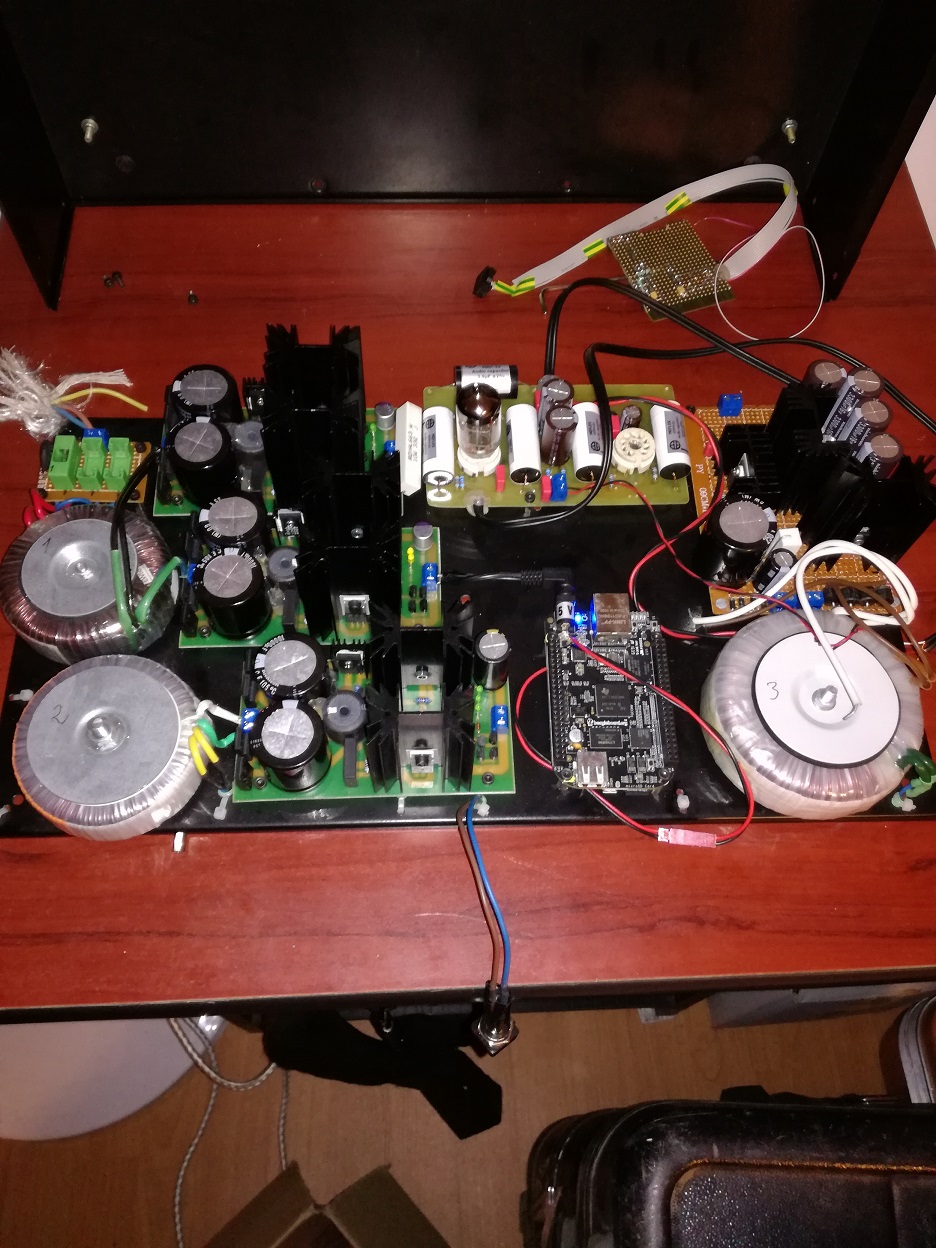

I use the 0,75 one for powering a BBB but the LED's is still flickering. I will try to turn of the BBB HDMI and maybe USB port to reduce power consuming, and if that isn't enough I will increase the CCS even more 🙁
I manage to disable the BBB HDMI and now the LED's on the board with 0.75ohm CCS is flaring only for 2 seconds when the BBB boot, even if I measure a maximum 460mA power consuming on boot. Despite that I am happy that now I can use the Reflektor-D with my BBB and the output voltage doesn't drop anymore.
What resistor load size I should use on this particular board so that I don't influence the performance of the regulator and if I shut down the BBB by mistake the Reflektor-D will not damage for not having a load ?
Put the DMM in Min-Max mode during boot. Maybe it can better capture the short current consumption peaks that are surely there. An oscilloscope over a sense resistor is best for that. The REF-D does not suffer electrical damage when not having a load. All the available current from the CCS is burned by the output MOSFET sending it to ground. It will just make its sink hotter, so if you see its too hot don't let it idle for very long without a load, power the PSU down. If you want to keep it idling for some reason just switch on a near 500mA dummy to its output like a 6.8 Ohm 5W resistor for 3.3V.
