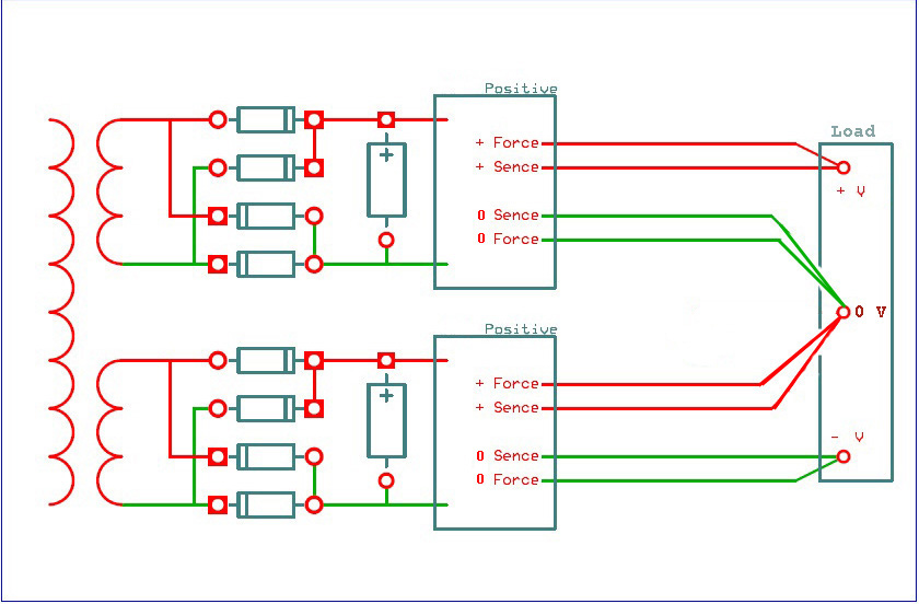

I'm considering changing power supply of my DAC based on old R2R 4xPCM1704 BB chips.
I need:
+5V and -5V DC for digital part and
+5V and -5V DC for analog.
I thought that for digital (positive and negative) I could use 2xREF-D.
Is it a good idea to use REF-D as negative voltage source?
What about analog positive and negative power supply. Is BIB v2 could be a good choice for my DAC?
I have two spare 'center tapped' transformers (8VAC). Can use these transformers and single bridge for supply symmetrical (positive, negative) voltage to 2x Ref-D (digital) and BIB (analog) +/-5VDC?
Is there any advantage/disadvantage of that approach (tapped transformer and single bridge) in respect to supplying REF-D and BiB?

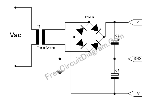

Ref-D although positive in itself can also be arranged to a good virtual minus regulator when used in pairs. But to make +/- outputs from two positive regulators it takes four wire independent secondaries from the transformer and double bridges. As in the attachment. Can't use center tap and single bridge as with dedicated minus regulators. BiB on the other hand has a real negative section that can be used with center tap and single bridge if its own diode bridges will be skipped and proper linking between its positive and negative section main filter capacitors will be made.

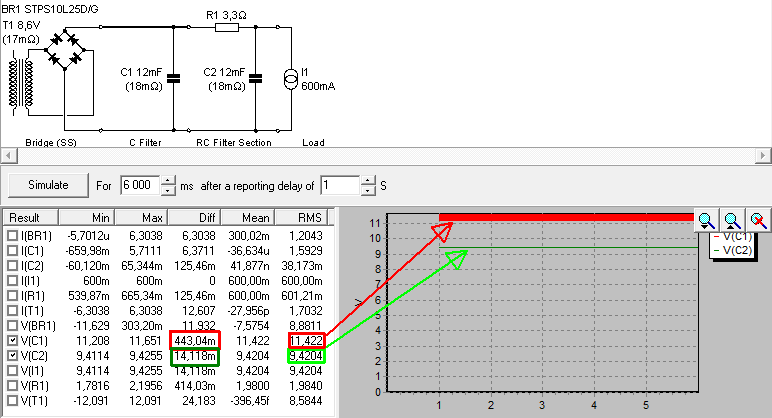

I tried a simulation with CRC and resistor R=3,3ohm. It doesn't look bad.
One thing concern me. Is 9,4V DC Vin will be enough for Ref-D with Vout=5V DC?
Not to drop out, yes it will be enough. Since some 100Hz rectification ripple will be eaten out by the filter, you got more leeway. For example in a target of 10VDC+AC at the last E Cap when 1V of that is ripple then 9V pure DC target is an equivalent.
