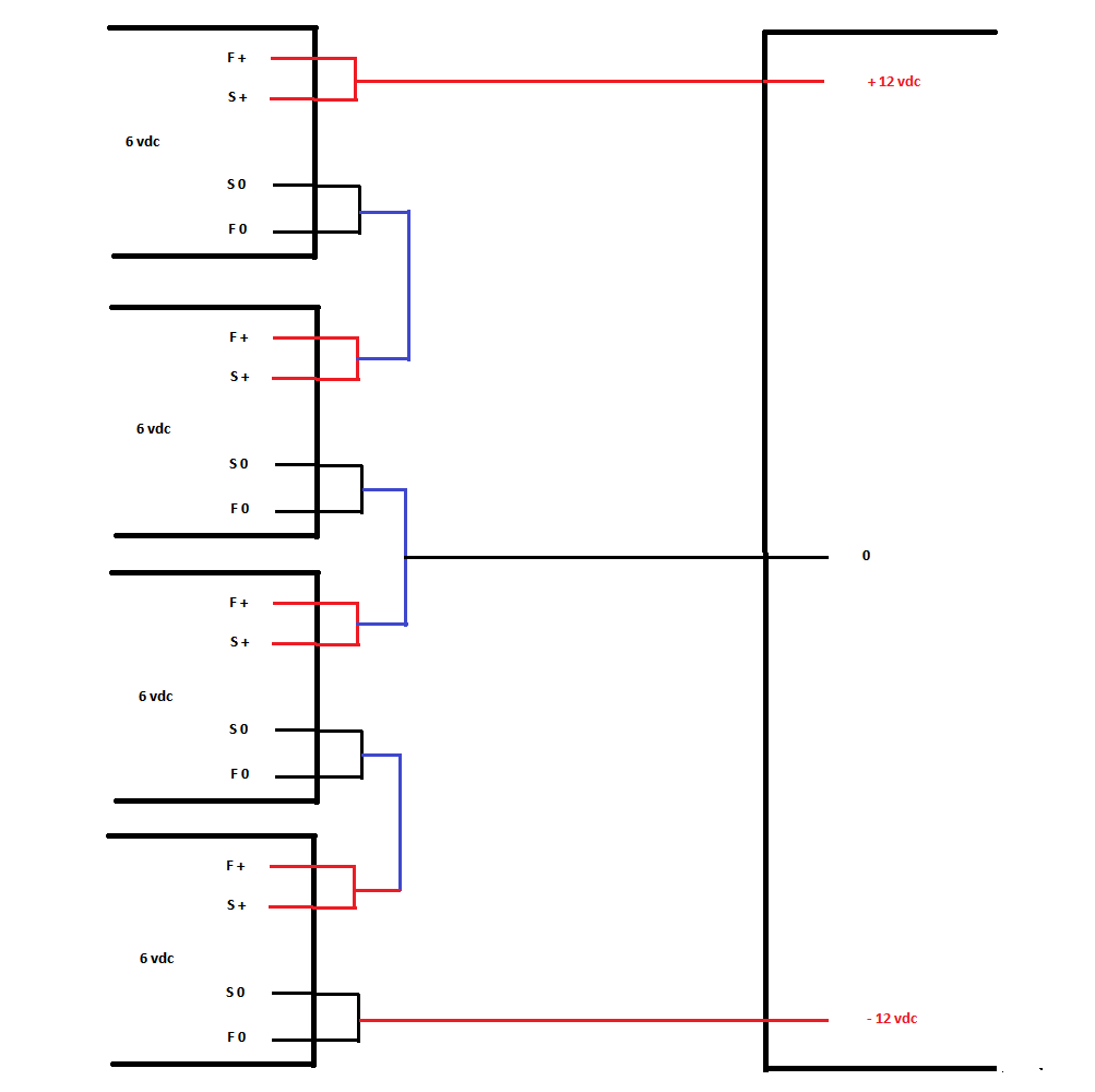

hi,
my dac needs +- 12 v in the digital side. can i use 4 x 6 v of ref-d in this configuration ?
(please see attachment)
can i use 8 vac from secondary of a transformer to get 6 vdc output from ref-d ? any drawbacks using this configuration ? does low output impedance matter for digital circuit ?

It looks like it would work. Better use Schottky bridge diodes when from 8Vac to minimize DC loss. But its tight. If you will read back there was a small discussion with formulas on how to calculate margins for ripple & filter capacitor value vs Vac.

That's 2x23VAC which is much and won't work anyway because when you stack supplies you want them independent so to behave like batteries. I.e. one secondary and one diodes bridge for each section.
In your shoes I would use one magnetically shielded 15+15V (four secondary wires) 50VA trafo and two big REF-D that have own rectifications,. Then I would boost their Vrefs with LM329 and two Leds (one extra in the place for diode/resistor) to get about 12Vdc from each and stack them. Less stuff in the box.
This is REF-D thread and I gave +/-12V simpler than 4x6V solution with REF-D also. We can chop off its no connection third leg and put the LM329 in Led1 position there with its cathode opposite to Led orientation. That could do for your digital section question. Bib can work to 12V with its trimmer, you don't need more than one breakable pcb of them and a 15+15V transformer. It has three sections, one bipolar and an extra positive. You break away the extra positive and keep it for another use. Max AC is one thing, power dissipation across the CCS Mosfet down to a much lower Vout from VdcRaw is a problem though. So we keep the transformer secondaries to enough for each occasion but manageable Vac.
