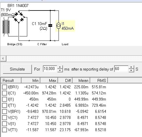

800mohms seems a bit low for a small transformer.
Did you use PSUD2 to calculate that source impedance for you?
Hi, that is just an arbitrary number. I suppose it is just the resistance of the transformer's secondary and can be measured. Am I right? I will do another simulation later.
By the way, I simulate with transformer with 9V secondary and with 10,000uf capacitor as the first stage of filtering (as in flexy). The voltage across the CCS is really not 11.3V and depends on the current level. See the two attachment with 150mA CCS and 450ma CCS respectively.
PSUD2 will calculate that for you. You just click the icons in the correct order and the software takes you through some dialogue entry fields.

the output of a choke input filter is roughly 0.9* Vac when the current draw is above critical.
I see you have 150mA through 10r twice, that accounts for 3Volts of drop.
Add that 3V to your 11.4V @ the output and you get 15.4Vdc, That's ~85% of 18Vac so you are in the same ballpark. PSUD2 should be about right for the values you have supplied.

I was trying to say that the raw voltage output of flexy (which use 10,000uf cap input) will differ with different CCS settings in the reflektor-mini.
I need to supply +-5V 20-50mA for soekris R2R DAC. So the CCS is set at 150mA. Need to figure out what is the optimal raw voltage supply for the mini. I may abandon flexy and use choke input instead.
