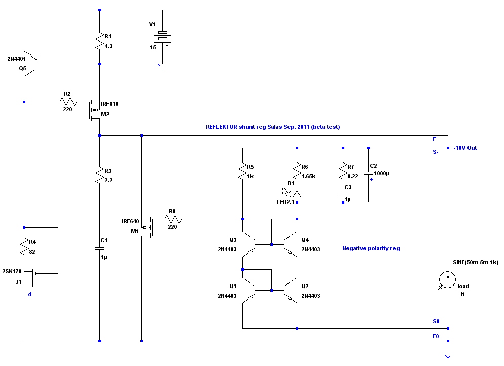

Salas for my amp I need 2x~28VDC (unregulated), 2x15V[30mA](regulated).
So I used trafo 2x20VAC and together with 2xSalas SSLV Bibs (+/-15V@100mA) I was able to do this. See the amp_sslv.png picture.
Can I do the same using Reflectors?
or
Since there is no negative version of Reflector I would have to do it this way: see picture amp_ref_d.png: two additional 20VAC transfomer secondaries and two additional rectification boards for stacked Ref Ds.
Thanks,
Salas,
Just technically and hypothetically. To build Salas Reflector D negative version.
Could one connect 0V from DC Flexy to V+ of Reflector mini board and V+ from DC flexy to 0V of Ref mini board to achieve negative version of reflector d?
Maybe with some modification like cap orientation on reflector mini and/or leds polarization?
diyAudio Chief Moderator
Joined 2002
No, to make a real negative one it got not only to use negative DC input but also NPN+NMOS in CCS. Like this:
