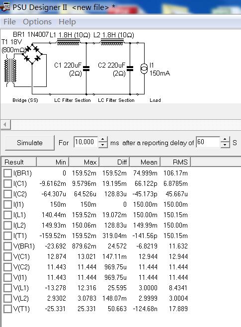

Hi, has anyone tried choke input (LC or LCLC) raw DC for your mini and what is the sound impression?
In PSUD2, if I want to simulate with choke input, I suppose I need to use CCS instead of a resistor load. In this case, how can I decide the correct component in the raw dc? Shall I found component that gives the CCS load a voltage of 5V or do I need more headroom? Thanks.

You use a CCS load in PSUD correct
Use 11.3V RAW DC (a 9VAC Tx will go about there after normal junction type diode bridge)

Hi, Salas, thanks. I did a quick simulation with PSUD. My target CCS is 150mA. My power transformer is adjustable in voltage in the range 0~20V. So I set it at 18V. After the voltage drop, the voltage on the CCS is about 11.4V. Does it look right? Thanks.
PSUD is normally accurate and 18VAC sounds logical for choke input which always brings a big voltage loss
