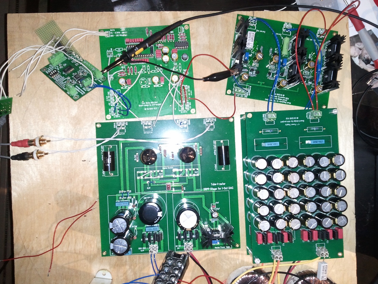

Concerning long slopes in the trace of BCK -IMHO the point is that your osciloscope PCSGU250 has too narrow bandwith - for clear shot of 3.07 Mhz BCK you need bandwith about 50 - 60 Mhz, not 12 Mhz as you have.
And sampling rate also can be too low - even with 25MHz sampling you will "catch" about 8 samples per 3.07Mhz period. So 4 samples per half period only... really bad 🙄
Thanks for the reply noizas. Is the rule of thumb for bandwidth not 5 x clock frequency? Tomorrow I will be able to take a look at it with a better scope.

Independent of your scope pictures, are there any sound problems with your setup?
yes, i'm getting digital noise on the audio output that comes and goes, most of the time there is silence.
What about your grounding scheme? Did you do it like in my blog?
Hi robots,
there we are talking not about 5x clock rate (MLCK), but about 20 x byte clock (BCK) frequency, as you want to see BCK trace on your scope, not MLCK
Concerning this multiplier, there are Fourier transformation rules - rectangular type signal consists of main sinwave and many of harmonics (repetative frequency sinwawes).
So if you need to transmit, receive or observe rectangular signal you need devices and cables with bandwith which can "handle" some quantity of harmonics also, else you will have distortion.
Does your I2S to TDA1541 come from Twisted Pear transceiver directly or through the chip, connected in between the TDA1541 pcb and Twisted Pear transceiver?
It looks like disconnected in picture, but what is purpose of it? Is it some buffer? Maybe here is the problem?

Thanks very much for the tips guys. I solved the problem.
It was just a matter of my cheap sound card not being able to switch modes without a system restart 🙂 .
I should have tried that first 😱
Also, for those interested, I had a look at the BCK today at school with a 200 Mhz scope. It looked normal. 12 Mhz BW is definitely not enough for that signal.

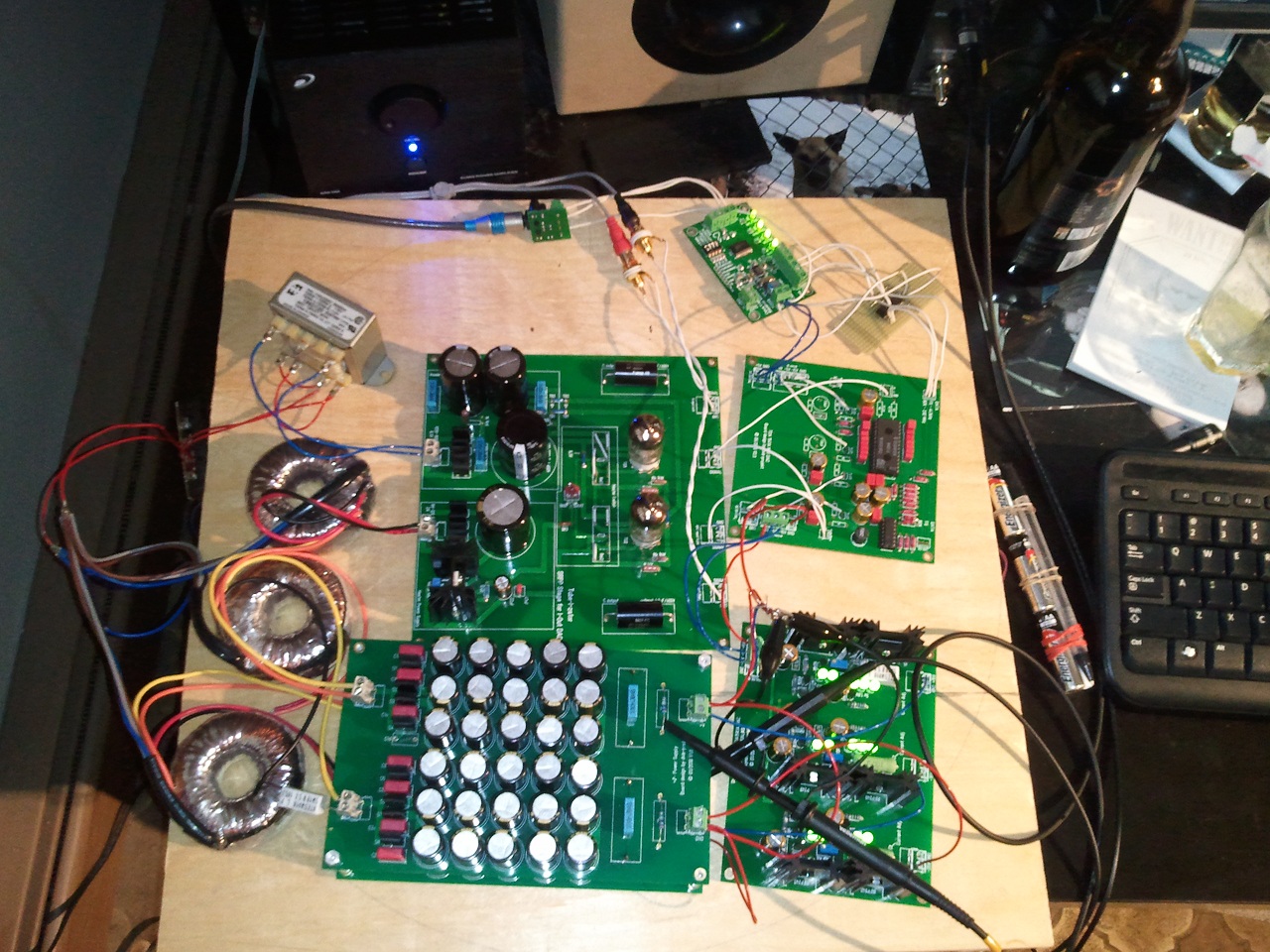

Oliver, looking at your current setup, it seems you are using both the X2 for USB input and the Twister Pear + buffer for SPDIF input. These seem to be powered from the same regulator. As they have different clock speeds, there will be noise on the power lines from the X2 when the TP is used (and the other way around).
Wouldnt it make sense to add a relay to switch power to EITHER X2 or TP (based on the same switch used to switch the I2S signal), so that only the one you use is getting power?
What you see is the 1st setup with both I2S converters. I hope that i finish my external Tube PSU this weekend.
If i have power again 🙂 i will test different power connections with the regs.
