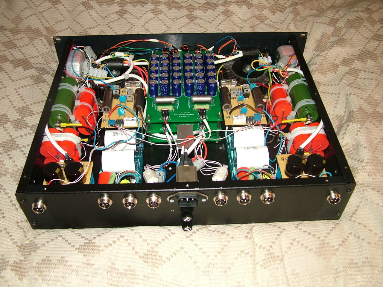

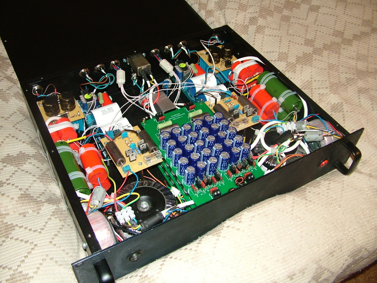

Next, at last I finished my PSU box - you can see photos in attachment.
It is 2U 19" rackmount box.
Here are two sets of LV and HV outputs for dual mono TDA1541 DAC and two tubed stages after it -2 x (25VDC, 20VDC, 17VDC, 300VDC and 11VDC) outputs.
Transformers are three per channel: one 65W from Analogmetric (0-12-15-18-24VAC[1A] x2, 9VAC[1A]x2), one 30VA Amplimo type 17070 (2x115VAC [0.13A]) and one TALEMA 25VA (9VAC[1.38A]x2).
All outputs were tested with load - LV outputs with 200mA load (first dummy load, later Salas shunts were connected) and HV output - with dummy load (about 40mA). Outputs for tube heating were tested with 2A dummy load.

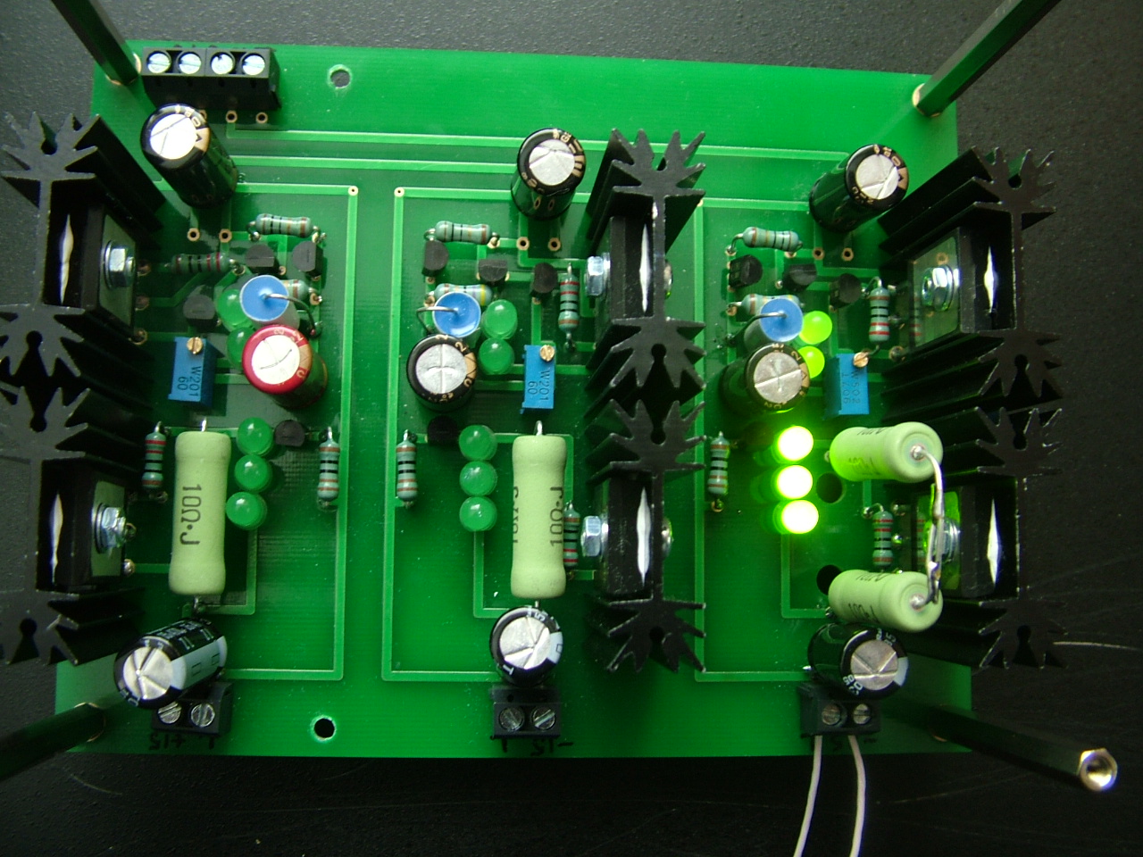

By the way, one of LV regulator (-15VDC) is non operational - I can not set output voltage - input is -24.8VDC, output - always about -9.4VDC.

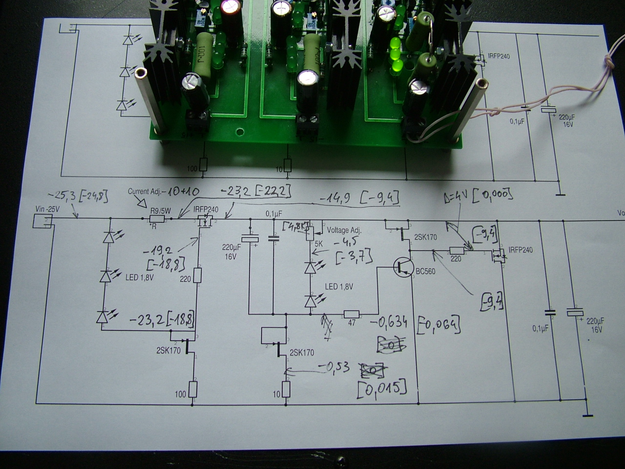

I have measured voltages in another regulator (it is ok) and compared those with non operational regulator's voltages.
In working regulator BC560 base has -0.628VDC on it, in broken - 0 VDC. Maybe SK170 or BC560 is broken. Any ideas?

Hi Saulius,
i can´t see the TDA1541A Shunt module on your photos. It will help if you could shoot some detailed photos of the reg. pcb.

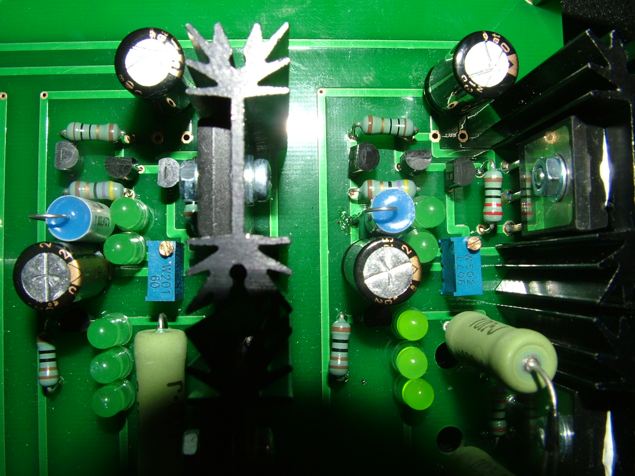

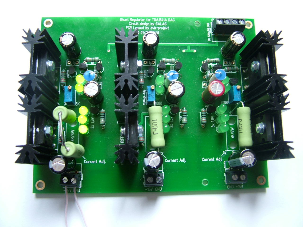

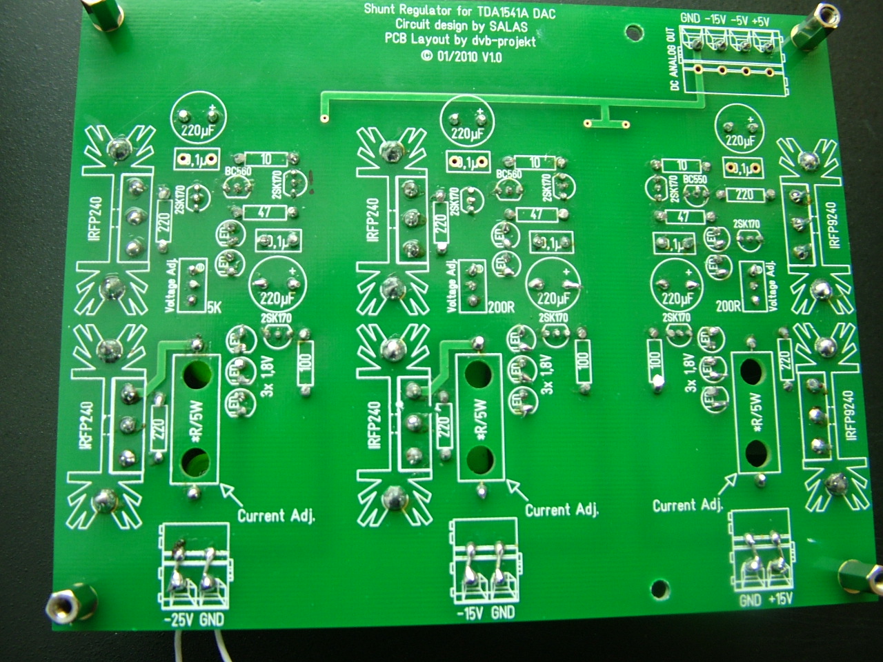

Hi Oliver,
here are attached few photos:
1 - this is operational SSLV -15V, -25V only connected (LED are bright on left side);
2 - broken SSLV -15V, -25V connected at right side (LED are lit on right).
On right side because all layout of components are mirrored. But mirroring is not problem - same layout -5V shunt is operational even if difference between -15V and -5 SSLV is only in trimmer value;
3 - bottom side of broken SSLV.
Data of measuring will be next message, as I can not attacth more than 3 pics here.

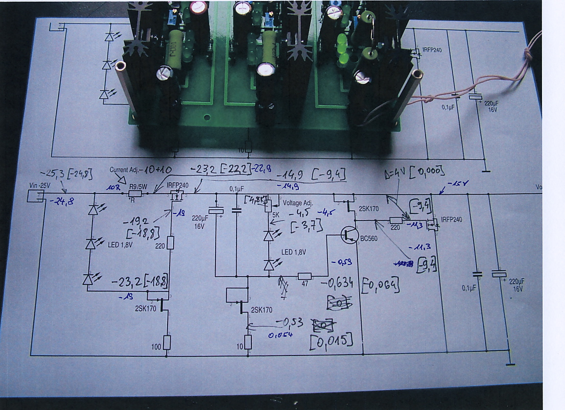

Here is more pics:
1 - near shot of shunt stage;
2 - my measurings on paper - values without brackets are from normal SSLV, in brackets - from broken SSLV.
By the way both IRFP240 in broken regulator are warm as in normal regulator - total consumption of current is about 130mA.
Saulius

Saulius,
i have attached my measurements at the same places.
Please look to the 2SK170/BC560. I think there is the problem.
Hi oliver,
thank you for fast reply and data of your measurements.
I already have replaced BC560 by new one, but no effect.
Now waiting for 2SK170 to be delivered.

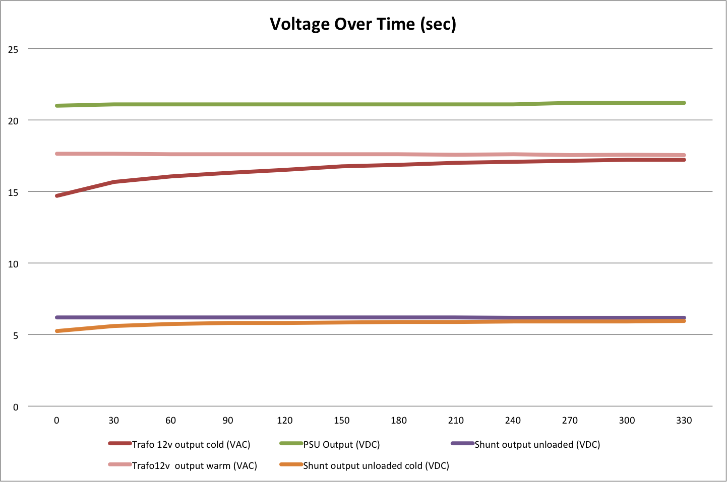

Interesting interesting... I did some measurements of the whole psu section.
Seems that the AE-Europe custom made transformer is way too high (but maybe according to their design specs, I have asked Kimm to get back to me). Also there seems to have been some oil leakage at the tranny....
Anyway, the measurements:
-The 12V tranny winding goes up from 14.7VAC (cold) to 17.6VAC (warm)
-PSU output (when warm) is stable at 21.2VDC
-Shunt output (when warm) is a stable 6.18V, this is the lowest I can set it to.
So... it indeed seems to be the high input voltage that is making the shunt too high.
