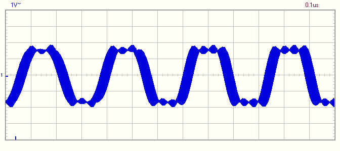

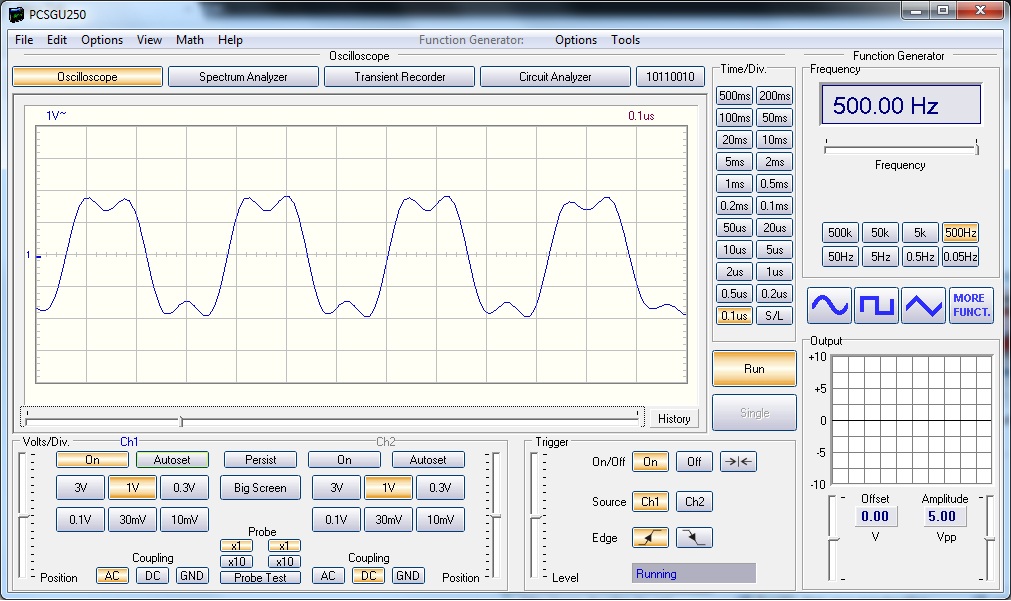

The BCK output from my Twisted Pear i2s converter is shown in the attached picture. Is it supposed to look that bad? Also it seems to have a fair bit of jitter. Also it is at about 3.07 Mhz instead of 2.82.
This trace is from the converter removed from the circuit and powered by 3 AA batteries, optical source. It looks the same while in the circuit.

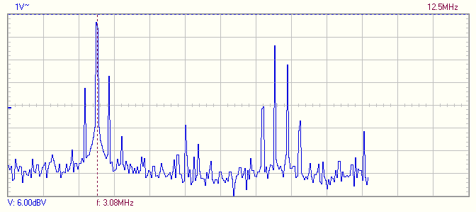

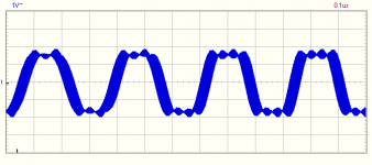

took some more screen shots, one with a persist trace showing BCK jitter and the second shows the frequency spectrum, which is quite messy. Lots of high order harmonics. Also the BCK frequency is 3.07 MHz.
So i think there is something wrong with my TP SPDIF board?

I don't think your SPDIF/I2S converter is damaged. 3,07 Mhz means only that it is running on 48kHz sample rate, not 44.1 kHz as from CD source.
Concerning long slopes in the trace of BCK -IMHO the point is that your osciloscope PCSGU250 has too narrow bandwith - for clear shot of 3.07 Mhz BCK you need bandwith about 50 - 60 Mhz, not 12 Mhz as you have.
And sampling rate also can be too low - even with 25MHz sampling you will "catch" about 8 samples per 3.07Mhz period. So 4 samples per half period only... really bad 🙄
There are some data of your oscilloscope:
◦bandwidth: two channels DC to 12 MHz ±3dB
◦time base: 0.1µs to 500ms per division
◦sampling frequency: 250Hz to 25MHz
