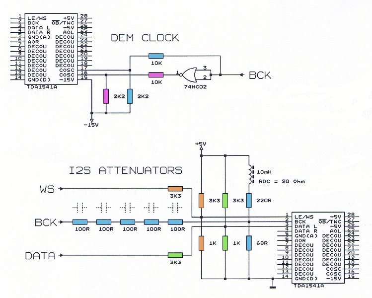

Hello All,
I am building the TDA1541A dvb-Projekt board, v2.3, and I am having some difficulties in determining why the signal levels are very low on BCLK. I have attached the diagram from Oliver's schematic with some points marked A to J. I would very much appreciate if someone could scope those points and tell me what the peak-to-peak voltages are?
The signals from the Teralink are all coming in at about 5V p-p, so there doesn't seem to be an issue there. I have tried shorting the inductor and that did not help. Here are the input signal levels I am seeing:
Pin 1: 44.1KHz, 740mV p-p
Pin 2: 2.82MHz, 424mV p-p
Pin 3: Data
Pin 4: same as pin 2
I also have all the other pin DC voltages. I have done the mods on the PCB, feeding the Salas shunt regulators directly in to where the TL431 regulators were. At the IC pins, I am getting exactly -5V, +5V and -15V.
Any help would be appreciated! Thank you!

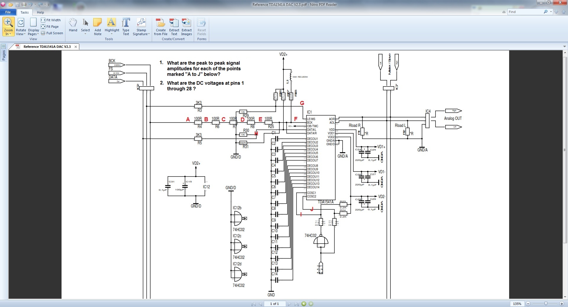

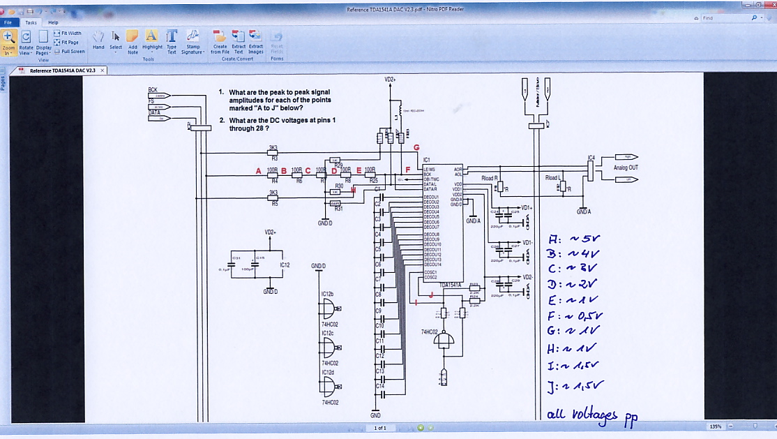

Hi Gary,
attached the voltages pp from A to J.
You repoted that the DC voltage on the lower side of the 10mH inductor are 4.75V.
That´s curious. The voltage must be stable +5V from the injection (TL431 pin) to Pin14 of the 74HC02.
Perhaps it would help if you post some detailed pictures for an overview.

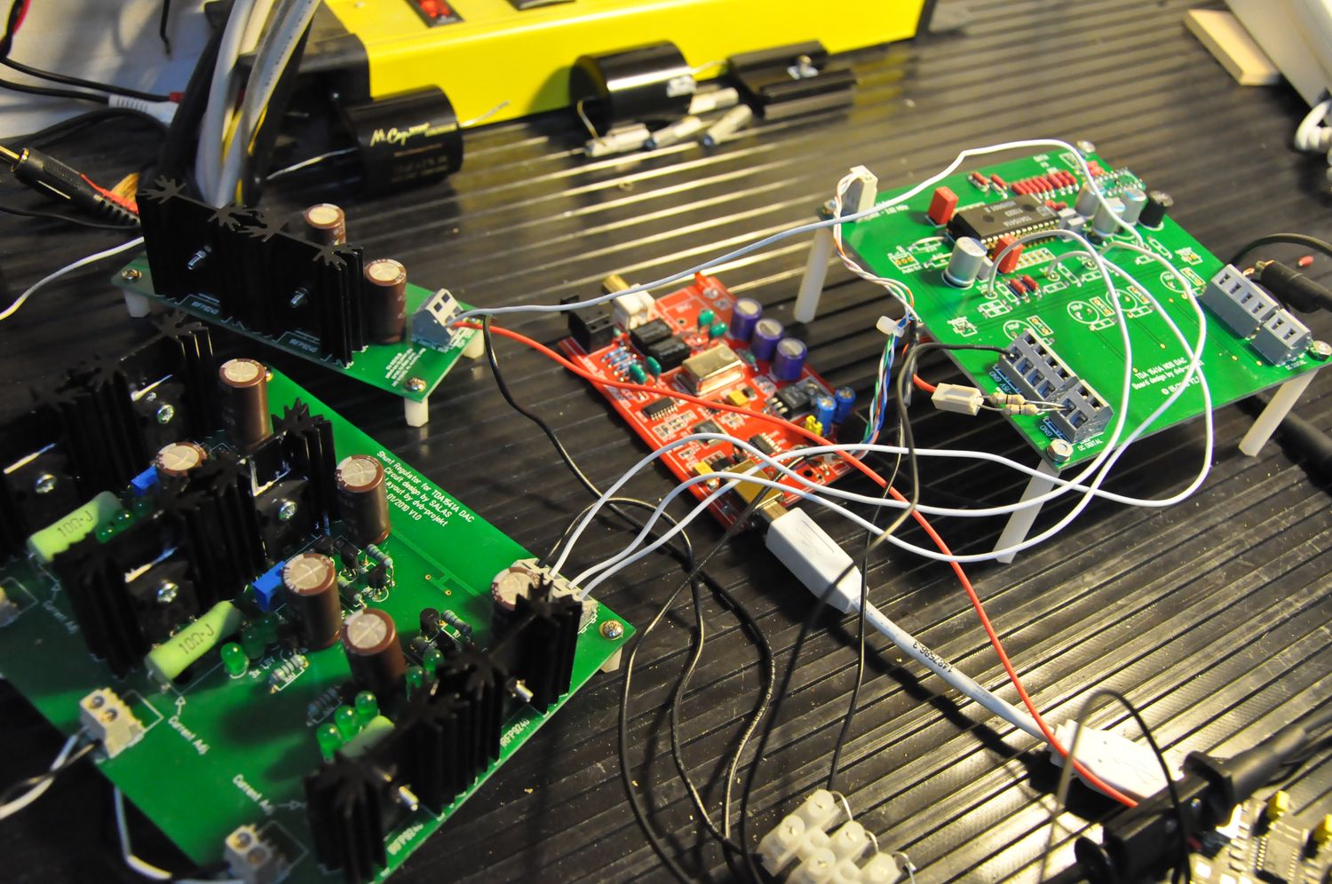

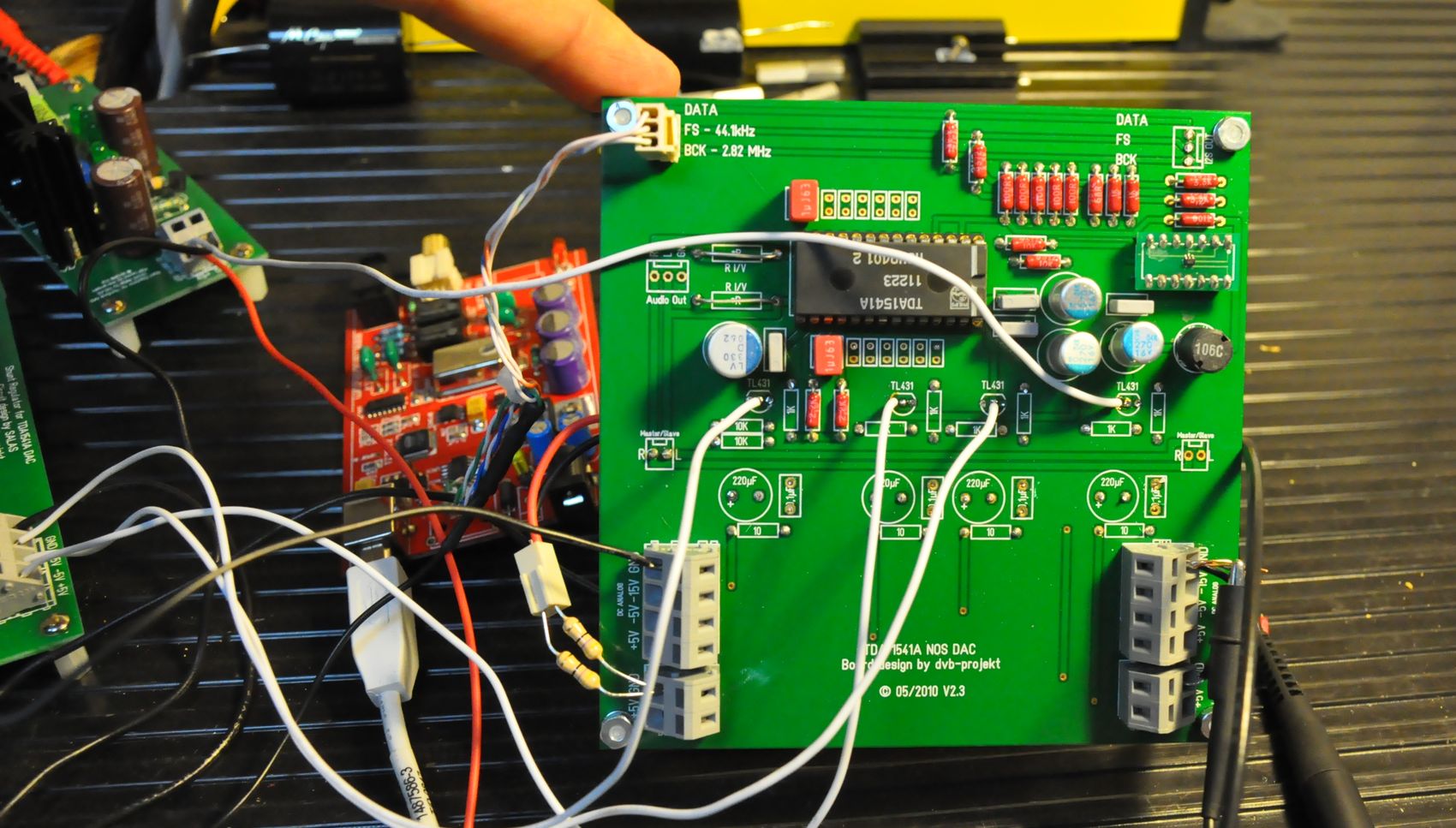

Hi Oliver -
Thank you for taking time from your schedule to assist me. By the numbers you have given, it looks like SCLK is just a little low - you measure about 1 Vpp, I measured 0.760Vpp. This is about the same proportion on BCLK.
I've attached 2 pictures of the PCB and layout. Just for quick testing, I'm using a couple of 47 ohm resistor to ground from the current outputs. They're connected from GND to the red/black wires that go to the master slave. This is actually the upper PCB of the 2 that I will use, set up for testing on this issue. If you're curious about the I/V resistors, I am doing the conversion on the tube out PCB.

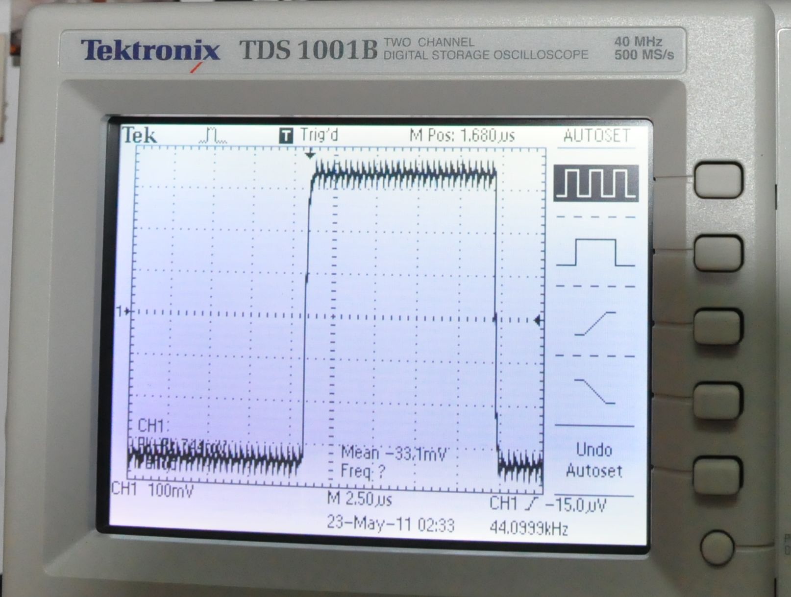

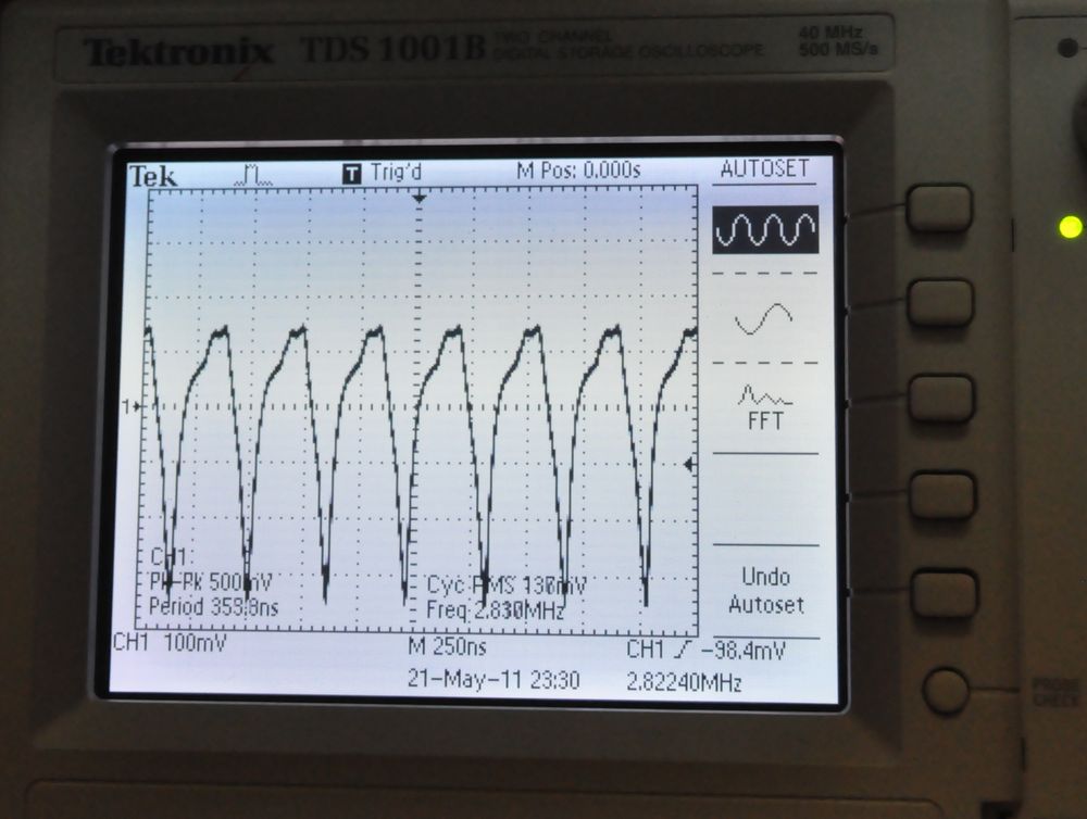

I've also attached a scope shot. The picture shows the BCLK on the OUT side of the resistor that is CLOSER to the electrolytic capacitor (either R21 or R22?) This waveform looks very bad. Does yours appear the same? Or it does not matter going into the Cosc pins? 😕
BTW - The voltage I mentioned previously on the bottom side (toward the TDA1541) of the inductor should be lower - it has a DC resistance so there should be some drop. I provided that to perhaps compare what you were seeing. Are you not getting about 250mV drop? It has a 23.8 ohm resistance, meaning about 10.5mA of current were flowing into the Pin 1 node. does that seem high?
Thank you,
Gary

Gary,
😱 you short the Iout lines (I/V-Resistors on the PCB) to ground.
Remove the two bridges and you got your missing signal. I think that´s it...🙄

Hi Jens,
i appreciate that you would help to find Gary´s failure, but as you wrote you don´t know the circuit you are talking about.
R3, R5 & R26-R31 are part of -ecdesigns- I2S attenuator
and not part of the problem why Gary has no sound output! 😉

The only odd thing I can see is the FCLK signal looks a little noisy on the flats, I have attached a picture. Does your signal have a similar noise?

Oliver,
Thanks for the schematic. Now I can see what is going on! Interesting way of doing things, but not exactly standard practice.
I do think that this circuit is part of the problem though. With very low voltage swing on the digital lines there is a big risk that the signals do not represent valid logic signals to the inputs of the IC. The logic threshold on the inputs can vary from one device to another (and with emperature) and with a very small difference between high and low level there is a risk that the input(s) will see the signal as being either high or low all the time. With proper logic levels there is usually a good margin. With this circuit there is no guarantee that it will actually work.
I suggest to try my initial proposal first to get things working. Then perhaps modifications can be made later, one at a time.
I am not convinced that the I2S attenuator will improve the sound though. I would start by making sure the wiring is correct and that ringing and overshoot etc. on the digital signal lines is eliminated.
Gary

Oliver,
I do think that this circuit is part of the problem though.....With this circuit there is no guarantee that it will actually work.
You do realise that this circuit has been tested to work, not only functionally, but spectacularly, numerous times. 😉

My voltages are set right at the chip pins: -5V, +5V, and -15V. I am getting proper FS/FCLK (1Vpp), BCLK(0.5Vpp) and DATA at the chip pins. I am using a 1KHz test tone into the USB. I think BCLK is a bit low, but Oliver confirmed his is about that level as well. I have checked the inductor by shorting it out. No difference.
There is no sine output, just noise...not sure where to go next. It's certainly not the chips either, I have quite a few and have swapped them.
