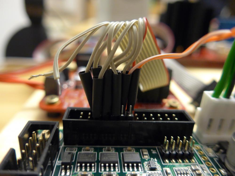

Attached is another picture of the connections from the WaveIO. It does not use the same pinout as dam1021. But I still would like to get one isolator out of the way. I have seen u-fl adapter boards in other projects (acko, ian ?), may be one of them can be used here as well or any of the usual suspects is willing to help out

Short somewhere ? What is connected ?
Min connected, rs232, toslink and rca out.
Thing is I started out with the power led and input power, and it already doing the blink once.
Just doubled check and nothing short any where.
Appreciate your kind advise

It might help if you connect a GND at the power connector.

It looks like you have not read the power supply requirements and have hooked up a +10VDC to one side and GND to the other.
You must have + and - DC supply and GND connected to middle pins of the power connector for the board to work.
My fault diagnosis : User Error.
+ and - DC are connected but not ground. Will give it a try. Thx!It might help if you connect a GND at the power connector.

Added the ground lines and I hv blinking lights now. Now to get a lock on the toslink input+ and - DC are connected but not ground. Will give it a try. Thx!

1) As already said, power is incorrect connected and it can't work without correct power, both + and - referred to GND.
2) You can't connect a LED directly, you need a current limiting resistor in series.
3) And you can't connect the RCA plugs like that, you have to connect them between OUT+ and GND.

Chrisnew : the output for the RCAs is the 4 vias in the middle between the balanced output ! You connected the Single Ended on the Balanced output ! Look at the shematic : link in first page of this thread !
