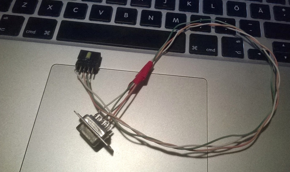

Have it running with WaveIO.
The WaveIO has its own isolator, so I had to power them both.

Just want to make sure that I can flash the new firmware to the dac with the Amanero still connected without damaging the Amanero?
My motto is better safe than sorry. There’s already been a few members on this thread blowing up their equipment 🙁
I have done it with the Amanero connected with no problems. I don't see a way that a firmware upgrade could damage the Amanero.
