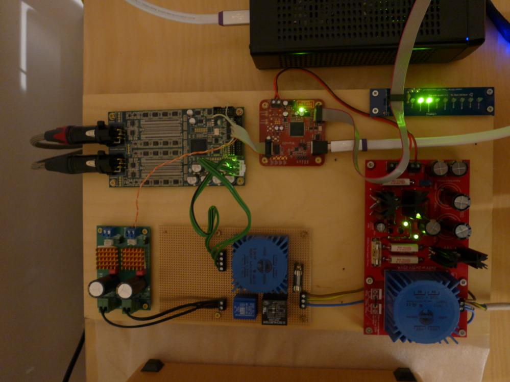

Did a bit of a dress rehearsal with a diyinhk
I've no plopping noise either
done no comparisons or critical listening as of yet but it certainly doesn't sound ordinary
I used direct ac in and pc power to the diyinhk i2s and still manages not to sound ordinary
will try amanero next
sounds encouraging~
