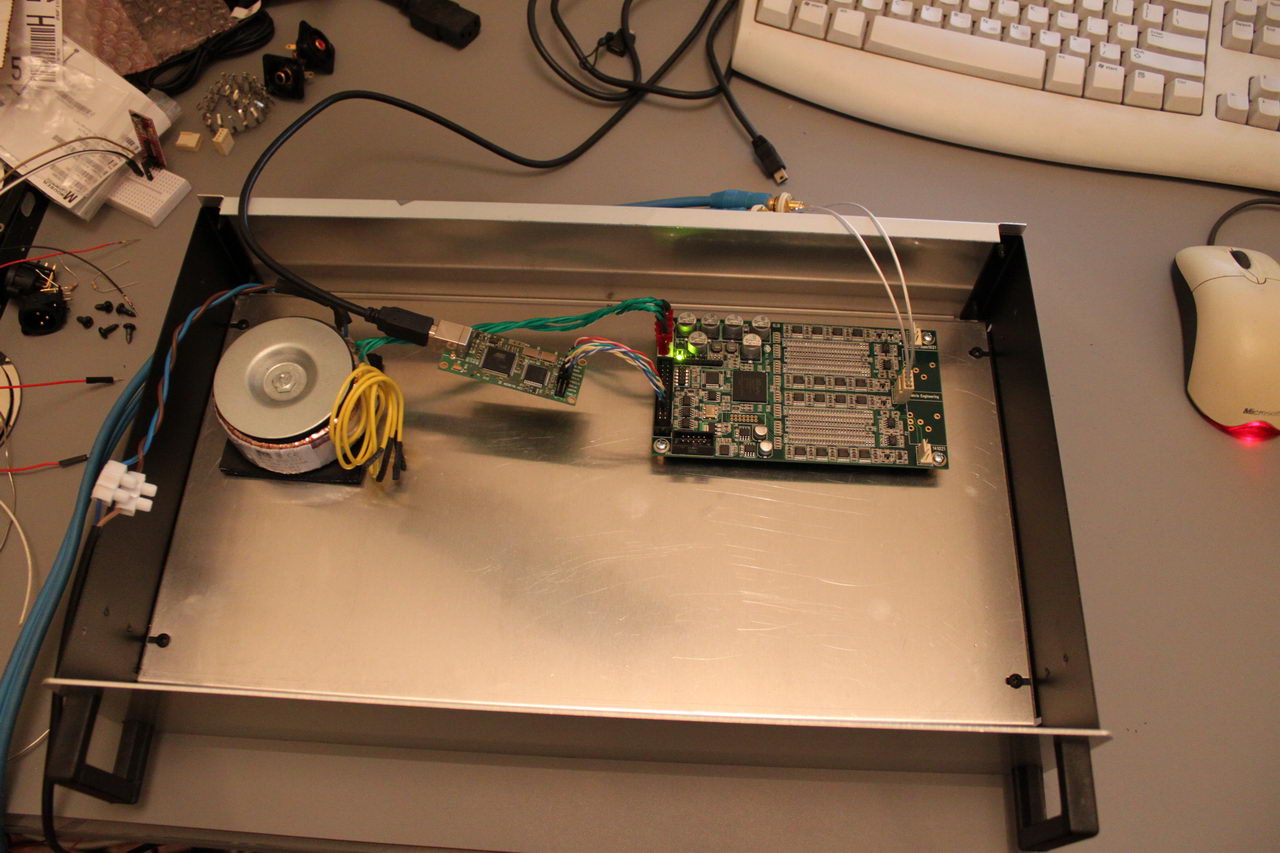

It's alive! 🙂
attachment.php
The ugly case is of course temporary..

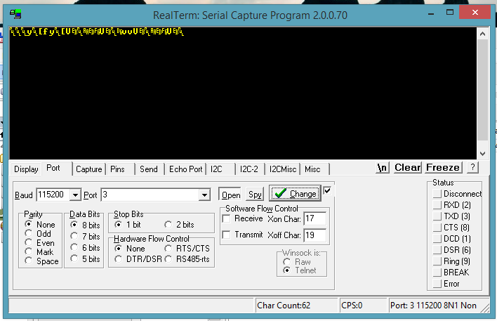

Everything looks fine, except that I can not get the serial connection to display correctly on my machine. No matter what I do, I can't get anything intelligible out of it. All I get is this:
attachment.php
When I detach / re-attach the Amanero I get a few more "words" so I suspect that the serial connection is OK. I have tried as many different character sets as I could with no result.
I am obviously doing something wrong, I suspect in the software side.
I tried it in a second PC with the same results.
Any ideas?

115200 is kinda pretty fast for RS-232, make sure you have a good but not too long cable, and if using a USB-Serial dongle, check if it can actually run 115200.... Also, quality varies at lot between USB-Serial dongles.
Be aware that the serial port transceiver on the dam1021 R-2R DAC has power saving enabled, to reduce noise, it need valid RS-232 level on the RXD line to power up. If your USB-Serial dongle also have power saving then you have a problem....
Best is running directly to a real PC serial port, but those are getting rare nowadays....

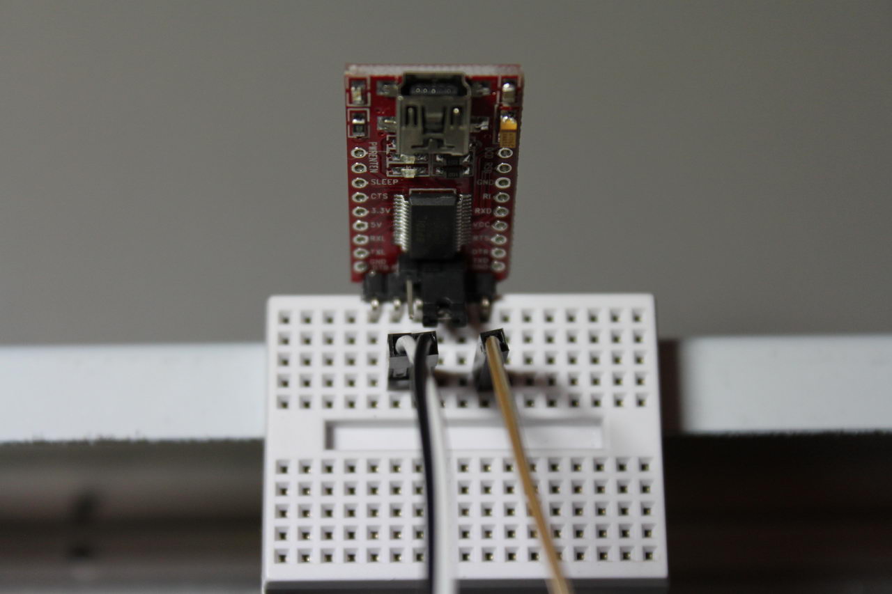

I am using a pretty standard USB to serial interface with an FTDI chip:
attachment.php
I have used it with success in the past to connect to an Arduino at 115200, so it can do the speed. I am using a few centimeters of cable, so that is probably not the problem. But I am using 3.3V signalling, which (come to think of it..) might be a problem. Since you are suggesting a "classic" PC serial port I can assume that your port has no problem running at 5V or even more. I will try that.

I believe that the dam1021's serial port is powering up, since it is transmitting data, it's just that the data is either corrupt or is not recognised by my terminal software (I have tried 3 or 4 different ones, btw.. none of them worked).
The dam1021 serial port is at real RS-232 level, not 3.3V CMOS levels.... That might be the issue.
