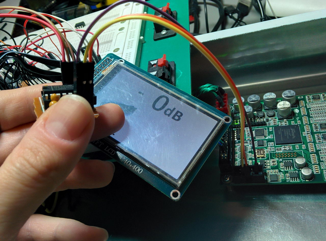

I have managed to interface my Arduino to the DAC using a MAX232 IC.
attachment.php
However, I am getting erratic behaviour. When I power everything up, everything works just fine, but after a while (a few minutes? I'm not sure) the communication seems to break down. I am not able to either send or receive data. I suspect that it has something to do with some "power saving" feature. Is there a way to disable power saving on the DAC's side?
My arduino has no problem communicating with my PC through my MAX232 and my USB to Serial adapter with no such problems. Also, my USB to Serial adapter has no problem communicating with the DAC. I only have problems with the Arduino talking to the DAC.
