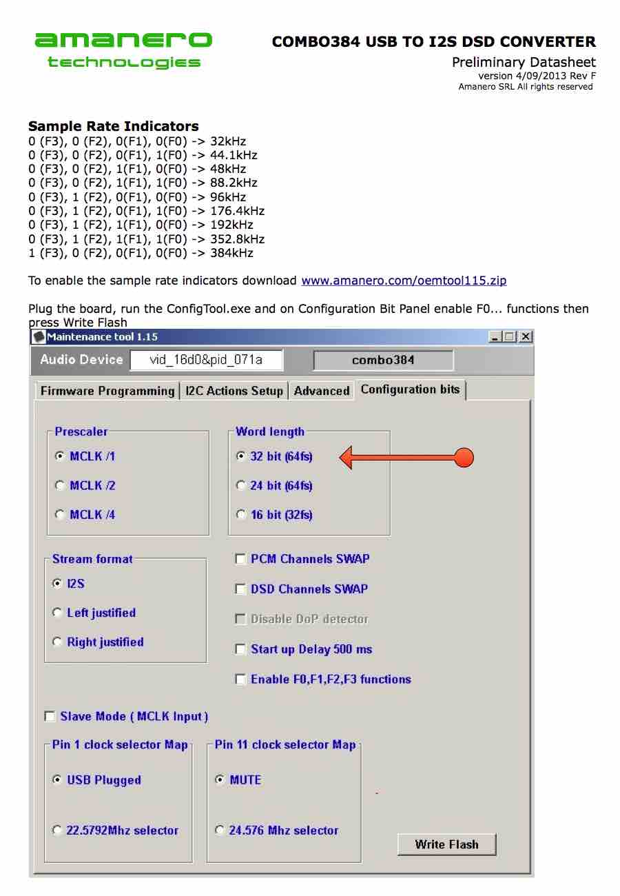

For newer versions of the Amanero pins 17-20 are no longer ground but the sample rate indicator, see attachment at post (http://www.diyaudio.com/forums/vendors-bazaar/259488-reference-dac-module-discrete-r-2r-sign-magnitude-24-bit-384-khz-91.html#post419713).
As far as I can see from your pictures you seem to have conneted one of those pins to the I2S inputs of the DAC.

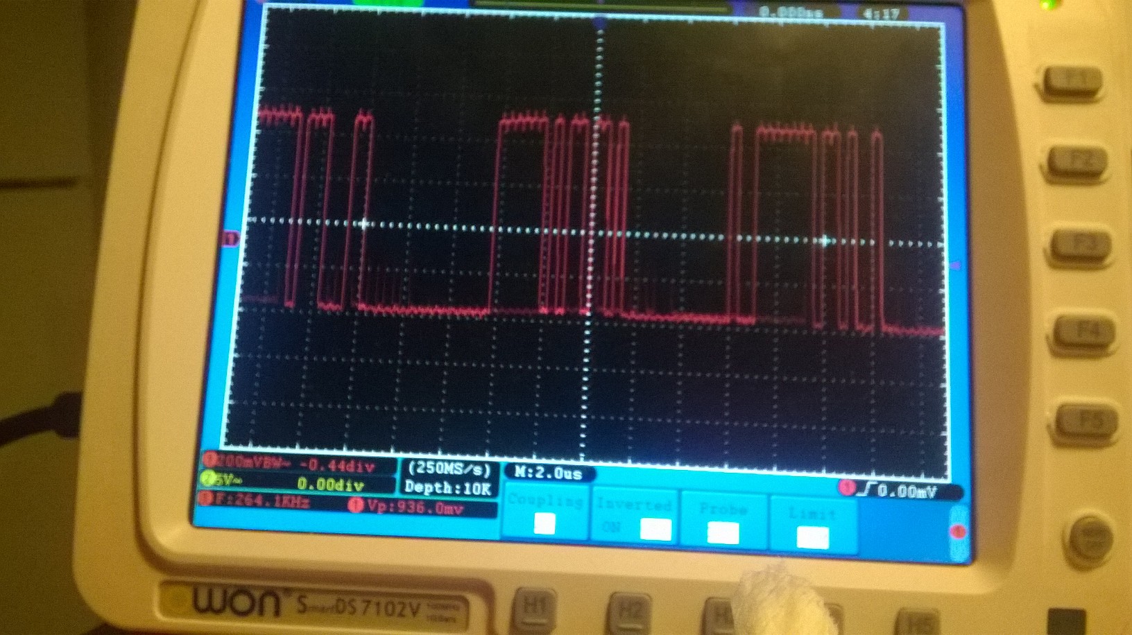

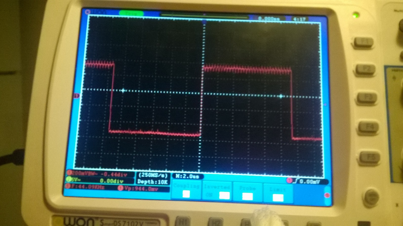

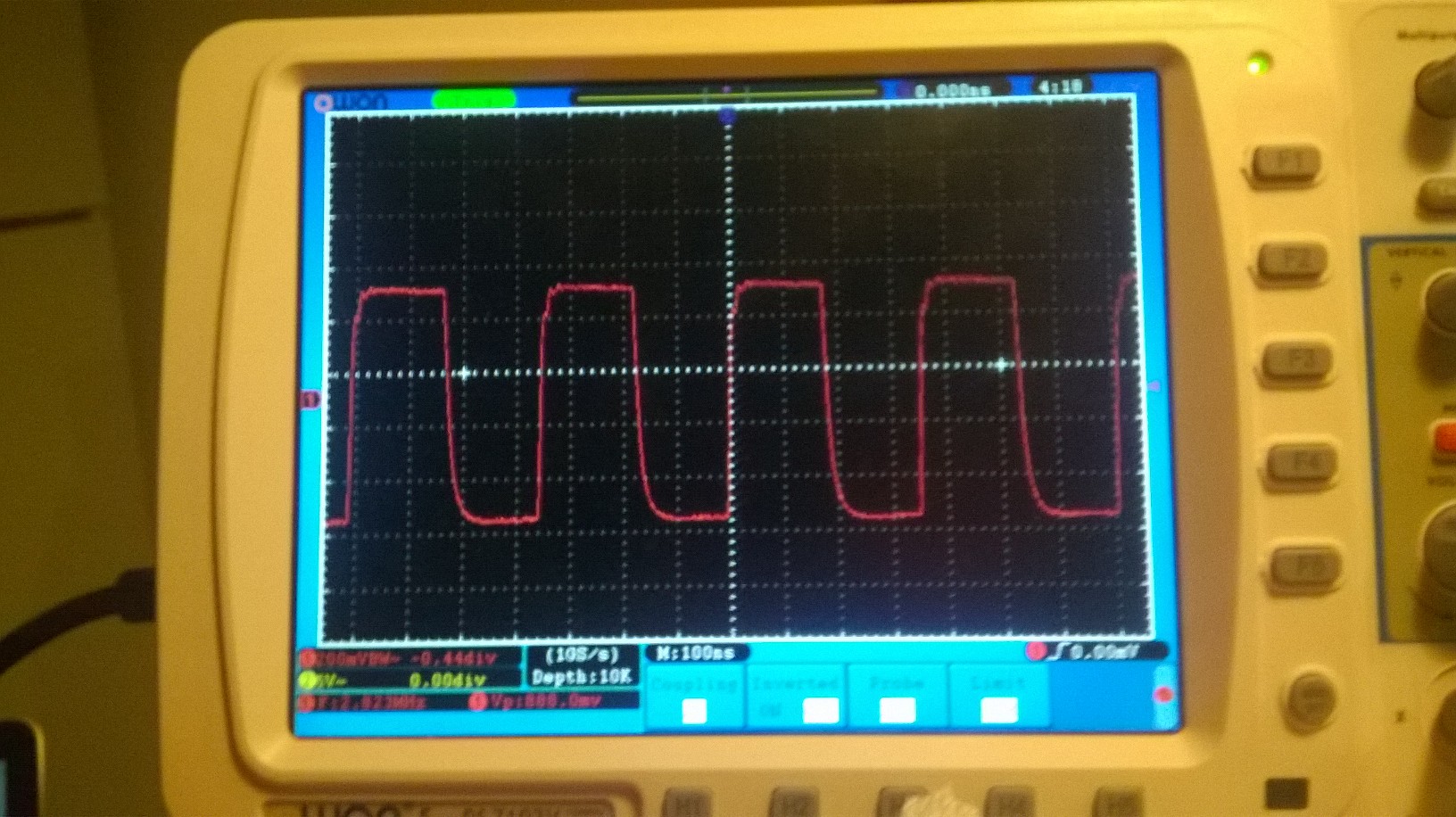

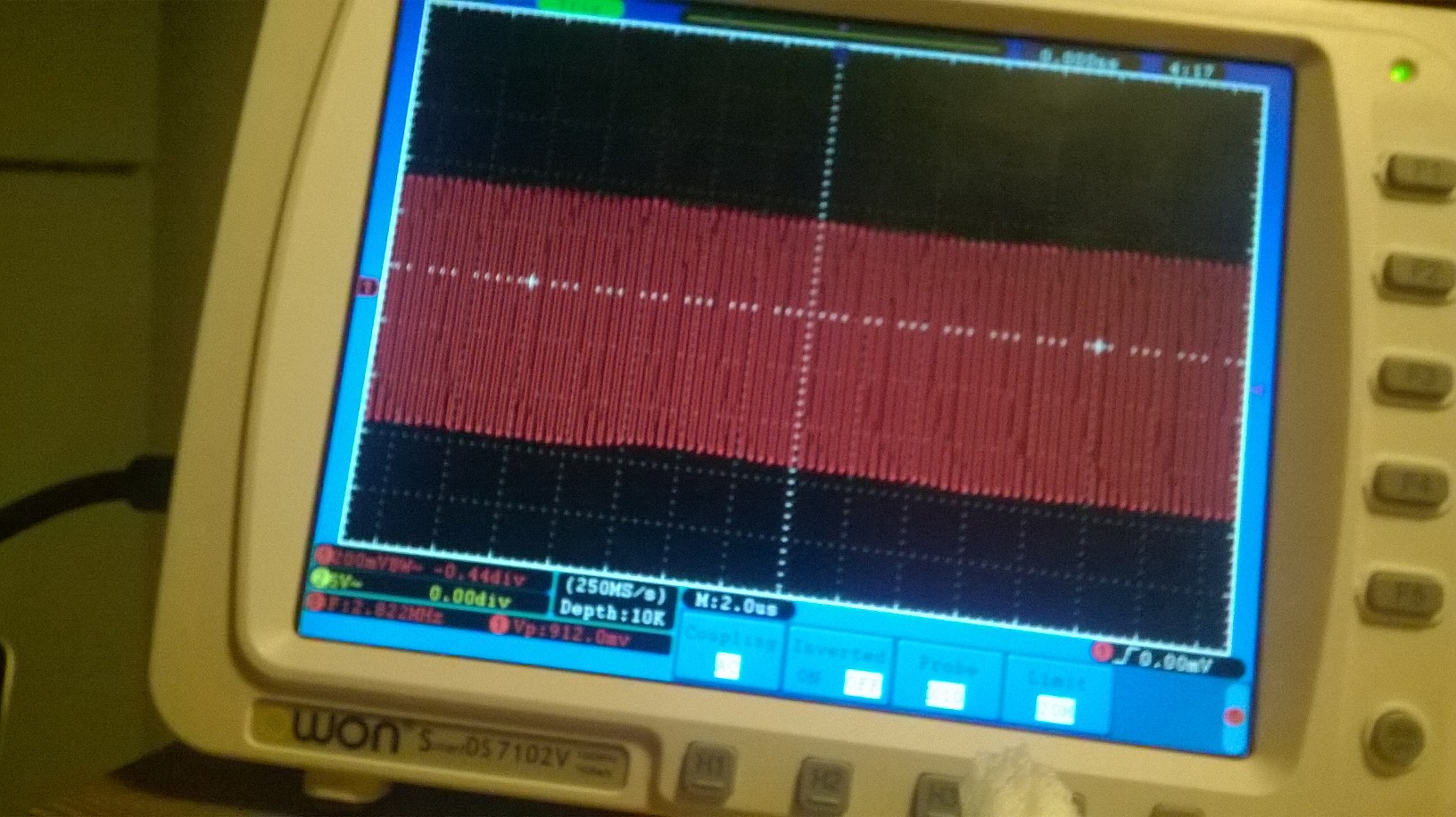

What I have on the signal pins:
in rising picture no order...
data ...7
lrck ...8
bclk ...9
bclk again ...10
data ...7
lrck ...8
bclk ...9
bclk again ...10
Data stops when hitting pause.
Setting says:
44,1 khz 32 bit integer.
Cant seem to change 32 bit integer...
Setting says:
Can it be default Amanero Firmware configuration? (Red arrow in the attached screenshot.)
