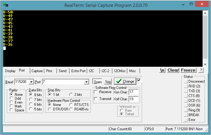

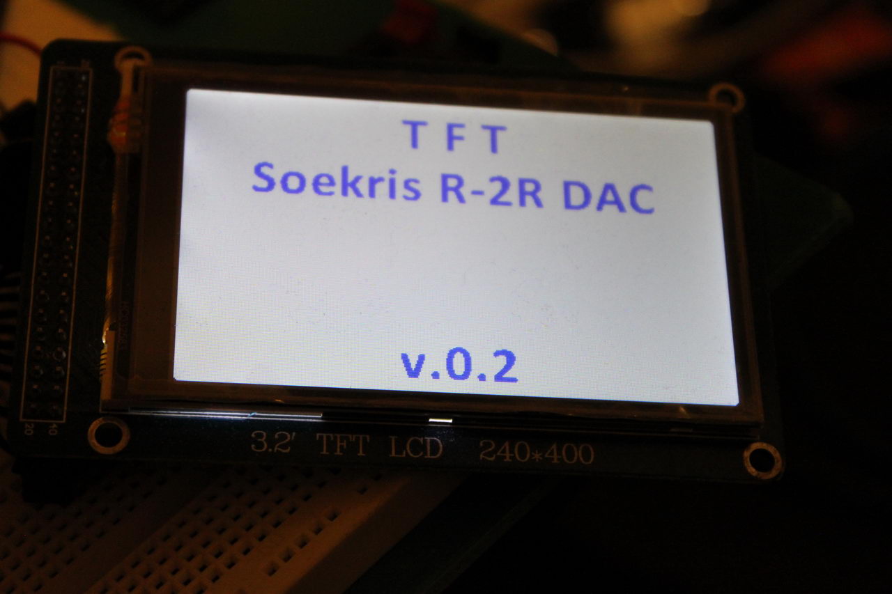

Just letting you know that I have began work on adapting my TFT HiFiDuino Arduino code to control the Soekris DAC. I do not have my board yet (I am expecting it this Friday) so for the moment I am just getting the basics right.
I am using an Arduino DUE with a 3.2" TFT screen. I will be interfacing to the DAC through the Serial3 port of the DUE. So far I have implemented just the volume functionality, since it is the only thing Soren has hinted to ("volume will t.ex. be "V-30" to set the volume to -30 db") but serial is easy, so it will take very little time for me (or anyone for that matter) to implement the rest of the functionality.
Of course it is fully IR remote controlled, has input memories, etc etc (all the goodies that TFT HiFiDuino has).
Here is a teaser:

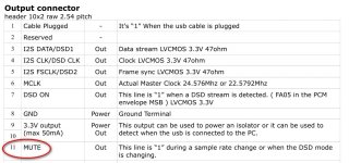

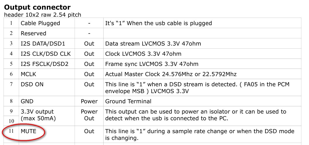

Does it related to this (from Amanero datasheet)?

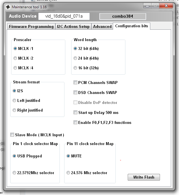

Thanks - looks interesting. How does one manipulate this settings?
Hi TNT,
It can be set up in the software configuring the Amanero (config tools - I use vers. 1.16 but there are newer).
There's an output that can either be used to indicate 24.576 MHz clock or Mute condition (see attachment). Since there's another output that can be used to indicate 22.579 MHz the first one may be used for mute.
BTW: In my experience the Amanero is prone to clicks & pops when changing either sample rate or tracks - mostly so in foobar and less so in JRiver (although it's still there to some extent). I'd like to note though that I haven't tried using this mute option so could be that this changes it - which would be very attractive actually ...
