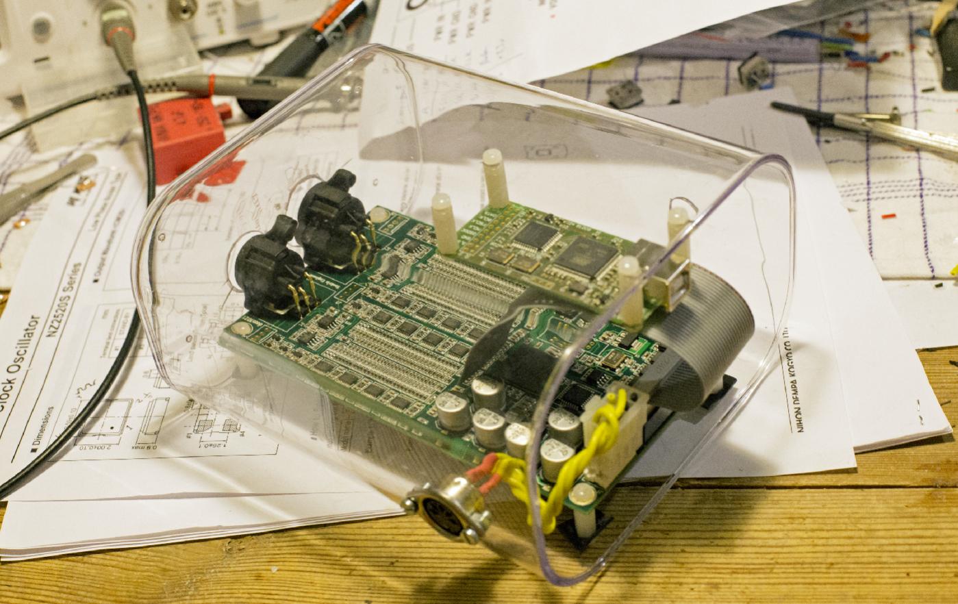

Half way. Not maybe last destination for boards. Anamero USB. Still some way to go...

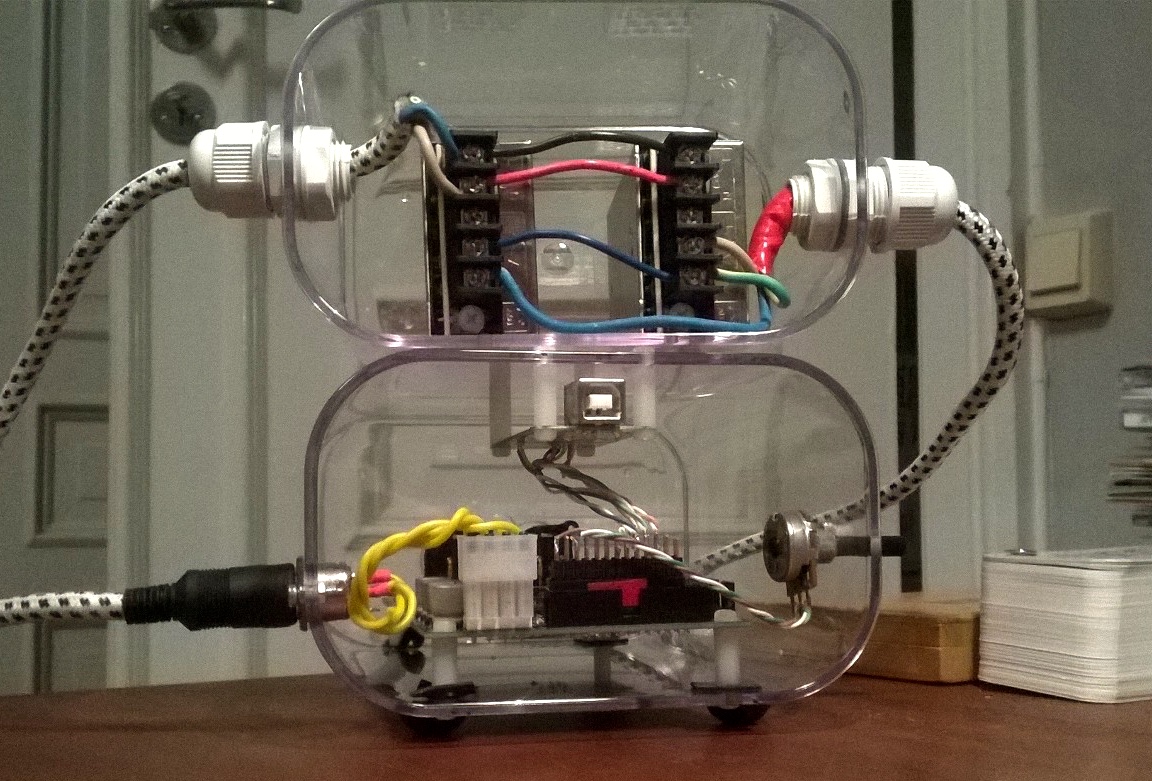

Only power unit left to do. 45 min? Skipped the ribbon cable as it was too hard for me today to sort out what is what :-/
Good ol' DIN for power ;) gives me a varm fuzzy feeling.
"Concentrate on assembly please, typing takes time..." hehe :)
