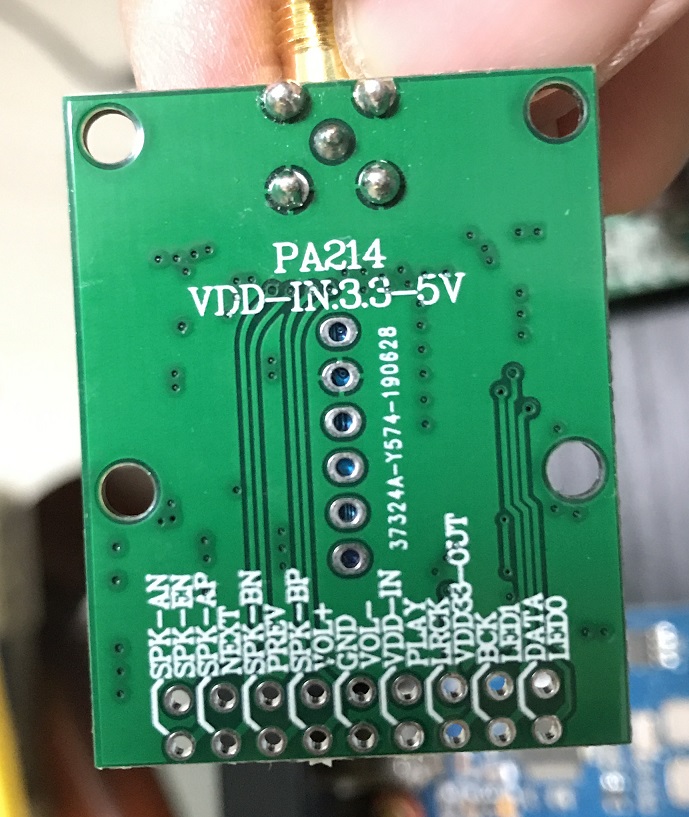

I’d be happy to repurpose the USB input? As that uses I2S? The BT module needs no firmware support, it is completely standalone, merely needs to interface with a I2S input.
Online Shop PA214 Bluetooth 5.0 Audio Module CSR8675 Fiber SPDIF I2S IIS APTX-HD | Aliexpress Mobile

It looks like the module supports S/P-DIF out. Why not use this?

That’s pointless, might as well use an USB streamer.
Regarding BT receiver, I have added it to my dual dam1021, and I share with the BNC input with a relay switch.
The BT receiver card supports BT 5.0 and it can output SPDIF signal. There's another receiver card which can output I2S but I chose SPDIF one because I want to share the input with BNC.
Either BNC or BT receiver signal is selected by a relay, then the signal will be passed thru the digital transformer as isolation before going into SPDIF1 of dam1021.

Can you perhaps post a pinout for the J3 connector? It seems to have pins that route directly to the opto-isolators from the USB input. I.e. if I'm not mistaken this is the I2S output of the USB input? If so, I should be able to hook in the BT > I2S module I have purchased, disabling the USB IC if needed.

Sorry, but no. the dac1541 is not a DIY product, and J3 is something I was planning to use for some special testing, do NOT use J3 for anything.
You might consider selling your dac1541 and get a dam19x1, that have an extra I2S input....
