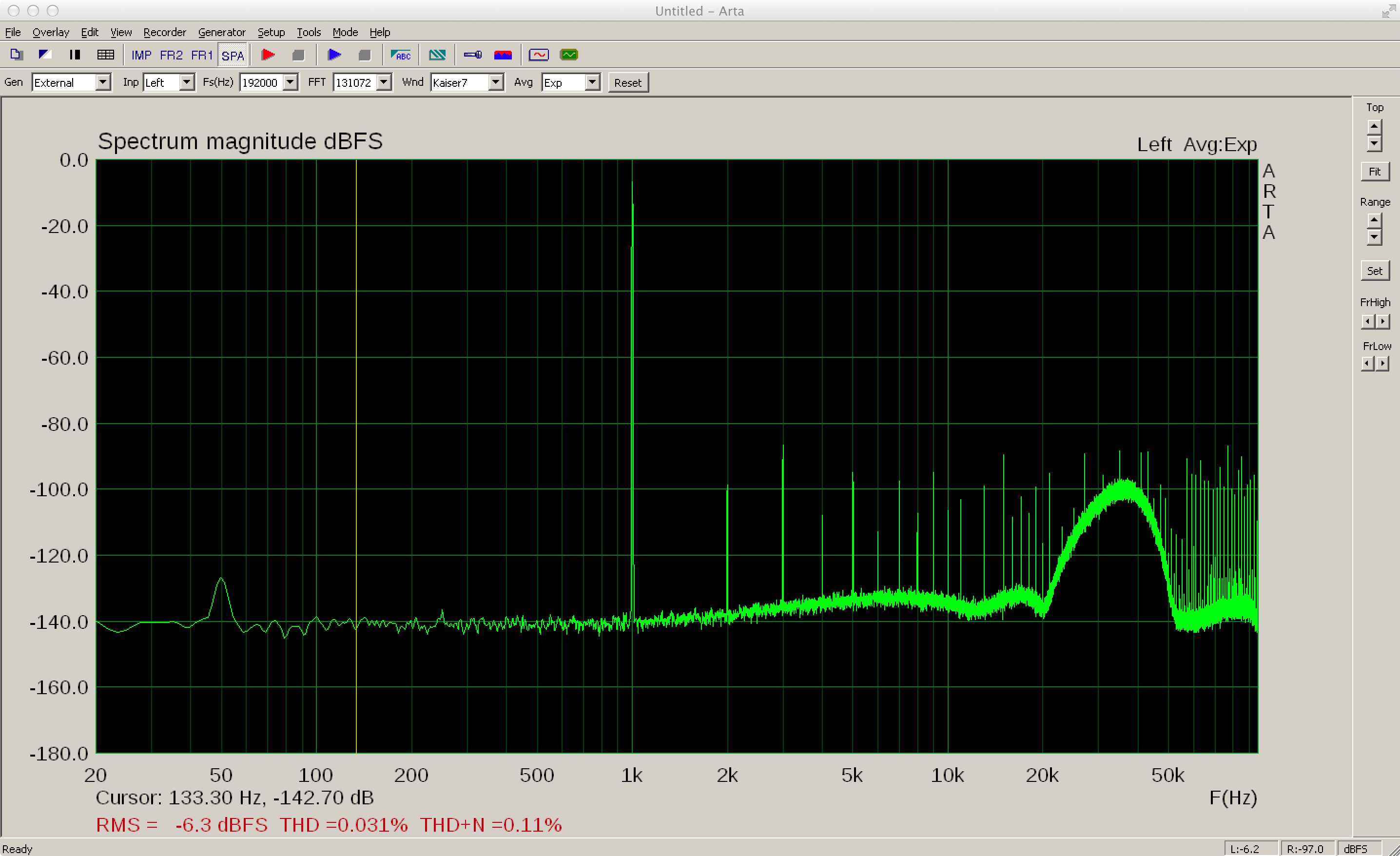

I think the DSD FIR1 stop band should start at lower frequencies. There is a quite noticeable bump from the noise shaping artefacts (also noticeable with music in the quieter sections). All my examples are from SACDs ... maybe the situation for other sources may look different.

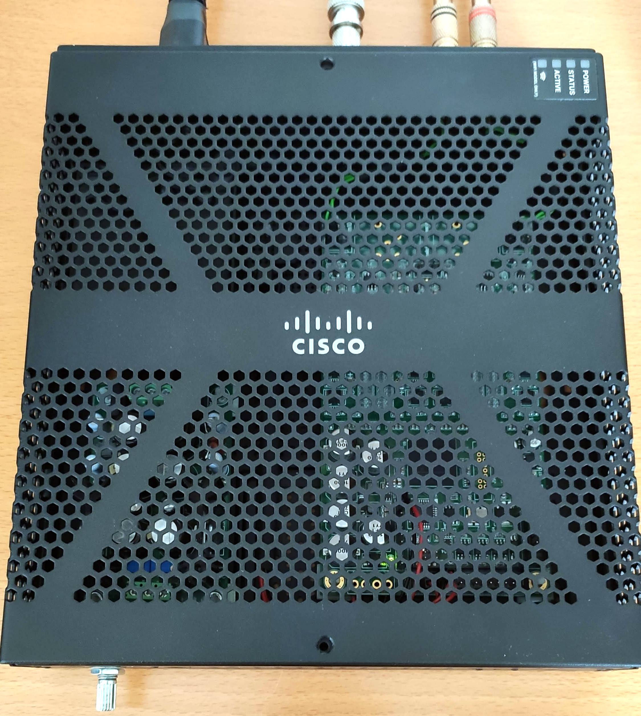

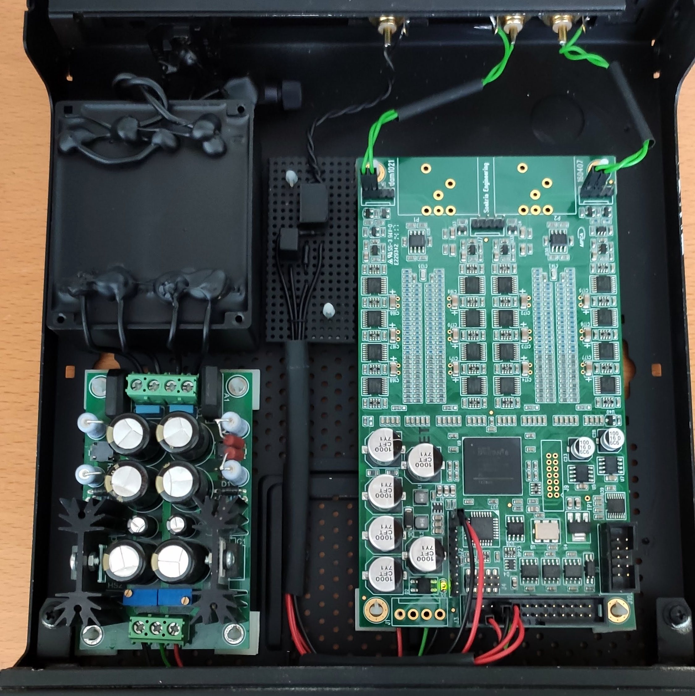

Finally - after sitting on a piece of MFD from day one playing every day - "she" finally got a house of her own.
Søren, if only I had had one of your previous cabinets - unfortunately I hadn't - had to use a second best 🙂
