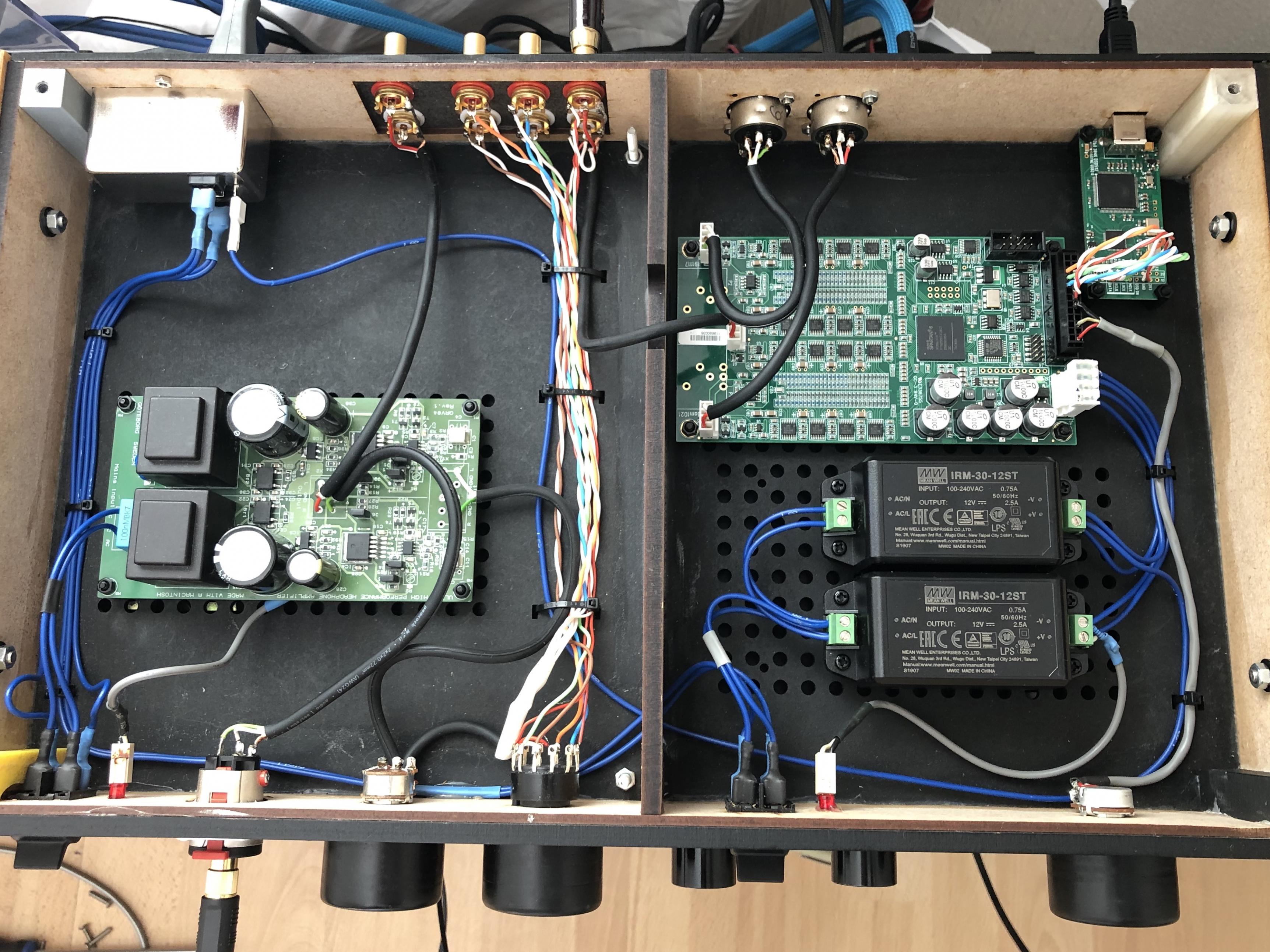

A Cisco Faraday cage!!
Am I seeing right, you spray painted the xfmr and coax board? 🙂
Sure I did 🙂

Ha! Were they rusting? Or did the colour-scheme offend you? 🙂
I fear you might not get it. It requires a well developed sense of esthetics 😛
