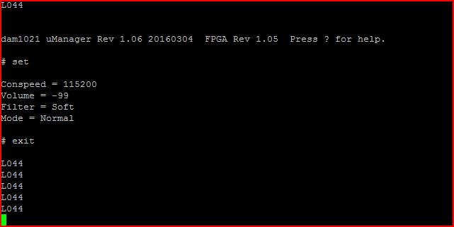

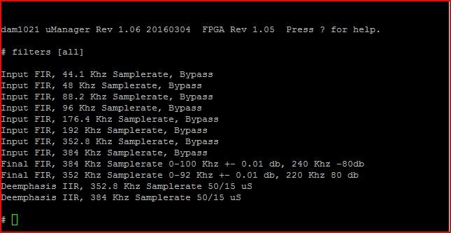

No SPDIF lock after uploading NOS filter
Thanks to several threats here I was finally able to get the proper USB/RS232 cable connected to the dam 1021. Right after that I uploaded the NOS filter published by Spzzzzkt back in 2015 but after power cycling the unit the SPDIF signal doesn't lock anymore.
I reverted to the original Soekris filter and the signal locks OK again.
Has anyone seen this problem before?
Thanks.

From what I remember, if the filters used are not compatible with the fpga firmware, you can "break" the dac, and that might cause it not to lock.
Those 2015 filters might be for an older firmware.

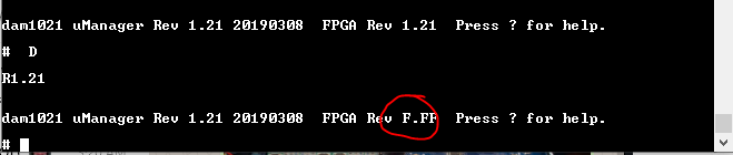

Hi everyone,
I got a problematic dam1021, it always jump to prompt when I connect the serial without pressing +++. Moreover, the input always set to I3, and the firmware revision is incorrect. I have upgraded the firmware to 1.21 (latest) still no luck.
(The first one is a normal dam1021, which can show the revision correctly. The lower one is the one with problem)
Before upgrading the firmware to 1.21, it was v0.8
If it shows rev F.F, then the FPGA image is not downloaded correctly. The uManager should always work, even with incorrect FPGA image.
The image get downloaded directly to the FPGA Flash, it's not like it get loaded afterwards.... I'm using the same source code as for my line of embedded computers, so it should be ok.
I'm using HyperTerminal on Windows, that I never had any problems with.
The same issue was mentioned in post #1434.
The rev F.FF means problem in firmware...
I tried to flash the firmware to 0.9, then to 1.06 then to 1.21 but still the firmware is F.FF.
Soren, is there a way to reset this thing? Thanks !
No need to reset anything, if uManager runs, you can download new firmware.... Are you remembering to use the "update" command after downloading new firmware and then do a power cycle ? The 2nd picture still show rev 0.8....
