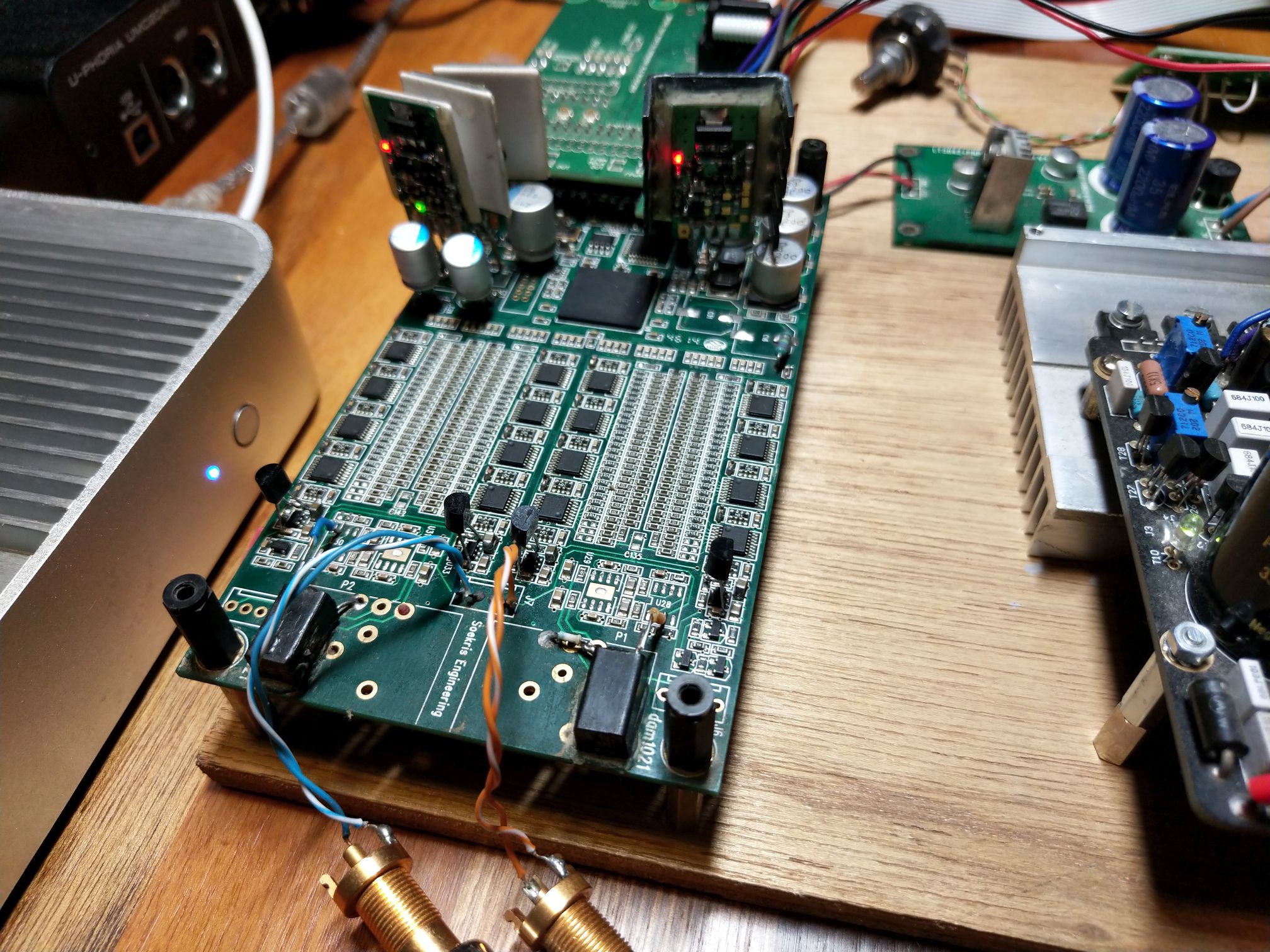

Here's the latest mod on my Soekris DAM v1: the BC550/560 transistor mod
This DAC has come a long way from the unmodded original v1 that sounded just mediocre and 2D,
to now full modded where it sounds sublime and in 3D 🙂
It's still my reference now, even against the es9038pro.
Nice build, is there any improvement in dumping the switching 1.8v regulation? That's about the only mod I haven't done, simply due to space considerations.
Thanks, I can't tell you anymore.
I think that I replaced the regulators all together if I look in my previous post.
What you can't see in the picture is the backside with plenty of vref caps,
see this old post.
see this old post.
