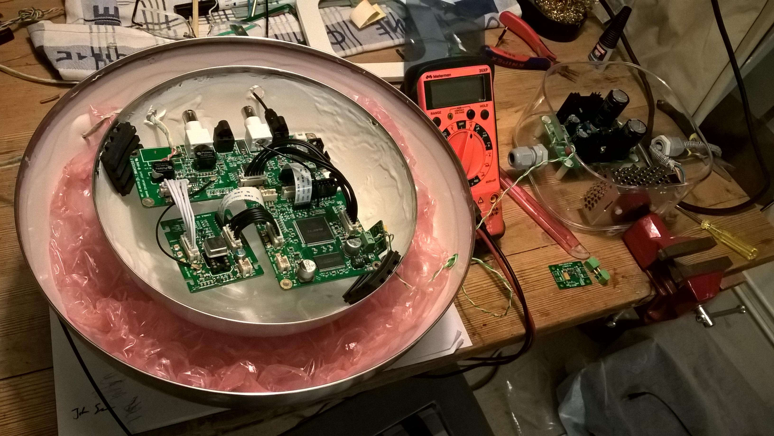

And not only re-clocked - but buffered. I have at least 1 second delay. The clocked I used has a very low close-in noise so it is really stable - this should mean less need for adjustment in the DAM digital PLL and this less DAM clock adjustments.

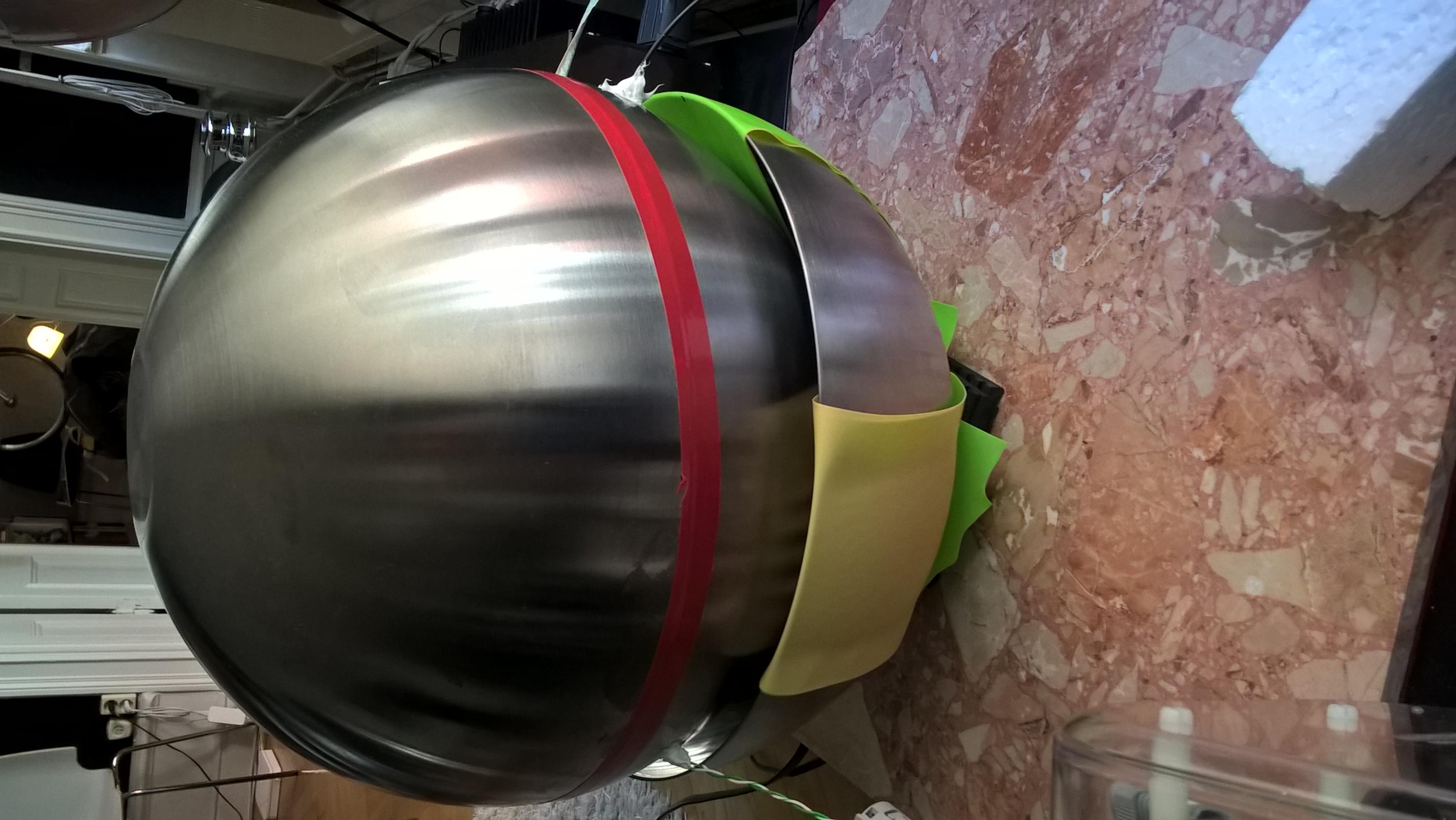

The clock boards are built into a sealed sphere which in turn is put into a selad sphere which in turn is suspended like a turntable in half-a-sphere. All in 🙄

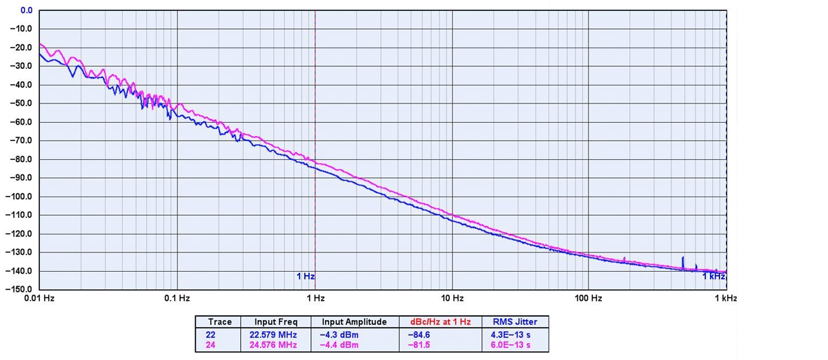

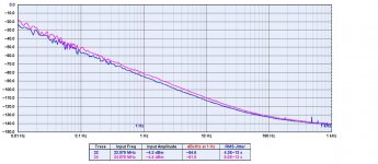

... The clocked I used has a very low close-in noise so it is really stable ....
Where have you found info on the close in noise of the NDK clocks? (You use the NDK NZ2520SDA?)
I got them from analog_sa - he had measured a lot of them. as it seems. 🙂
You just pay for every dBc at 1 Hz you want 😉
Uh-oh. Now i am revealed as a clock pusher too 😀
The only way i could have measured those would be by comparing them to the stop clock on my Casio watch 😛
IKEA forever 😉 The inside has a quite thick layer of the sh*t they make face masks with :-D
