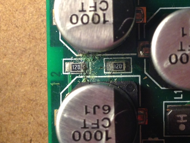

The other positive power supplies are ok, but if had a short on PWR+ the series resistor between two electrolytic capacitors could blow.... It's the 12R 0805 closest to the PCB edge, let me know if you have trouble locating it.
Yep, it looks a little stressed...what are my options? The inner resistor also looks...distressed...🙂

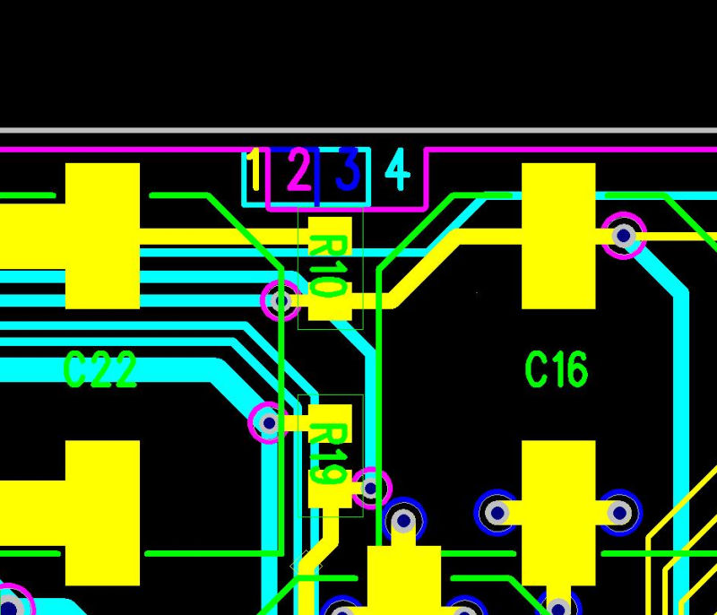

That resistors seems to have exploded, haven't seen that before, but the inner resistors is probably fine.... Even the PCB trace seems to have vaporized so the easiest is probably just to replace it with a 12 ohm leaded (or 10 ohm, not really that critical) part, just connect one to the plus poles of the two capacitors it sit between, closest to the PCB edge, see picture.
