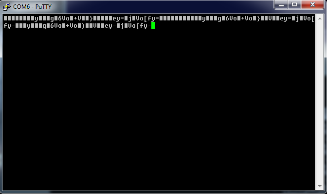

Assuming that is correct, are there any scenarios where the serial interface could be ruined? As of two nights ago, I was able to bring up uManager via doing "+++" over the serial interface. Last night, I could not bring up the uManager, nor get any output from the serial interface. I'm pretty sure nothing changed. My dam1021 board is not modified (other than soldering on standard pin headers).
I have tried the J3/isolated serial connectors via Raspberry Pi connected with Normundss switch board. Also tried J10/non-isolated to my PC using a cheap FTDI FT232RL serial to USB converter (like like one).
Not sure if I have inadvertently harmed my dam1021 board, or if it's just a matter of operator error. But if the latter, I can't figure out what I'm doing wrong, as it definitely was working. In general I'm pretty comfortable working with serial interfaces.

See attached for what I'm getting on the serial port when the board is powered on. Basically a bunch of garbage, but it appears to be consistent garbage. The image represents three or four power cycles of the dam1021 board with serial console attached. Most of the garbage prints when the board is powered on. Looks like this is the string that prints when the board turns on:
Code:
y▒▒▒g▒6Vo▒+Vo▒}▒▒▒▒▒ey=▒j▒Vo[fy=
So while I'm getting garbage to print at power up/power down, I can't get anything to print after power-on. So in this state I hit "+++" and wait, nothing. Or if I try "I0" (runtime command), nothing.
Thoughts?

Update (just missed the 30 minute edit window): Looks like this cheap FTD1232 doesn't work on the 5V/J10/non-isolated serial port. But it does work on J3/3.3V/isolated serial port. (There is a jumper on this thing to switch between 5V and 3.3V, and I triple-checked that the jumper was set correctly depending on which dam1021 input I was using.)
But I have yet another USB to serial cable, and I got this one working on J10/non-isolated! But I still can't get my Normunds board + Rpi to communicate with the dam1021 via serial.

Eeeh, the isolated digital 3.3V serial port and the real RS-232 port have different polarity, all RS-232 buffers are inverting.... So check your USB to serial cable for what kind they are....
The 5V mode of the FTDI is still TTL signalling with no inverted signal, its either high or low and you need to use the 3.3V mode on the isolated port. Remember that true RS232 serial can swing anywhere between +/- 12V which is entirely different altogether than the simple TTL converter.
