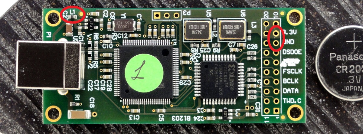

When I use external 3.3V for Amanero I only have to cut 1 trace as described at post #878. How to connect external 3.3V to Amanero board? To C27 as the post #878’ picture says or I can use GND and 3.3V output of the Amanero’s output connectors, does it matter?
According to Domenico of Amanero just remove the resistor at L1 and connect external power to GND and 3.3V output of the Amanero board. I did that and it works.
