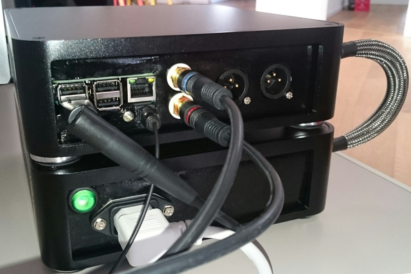

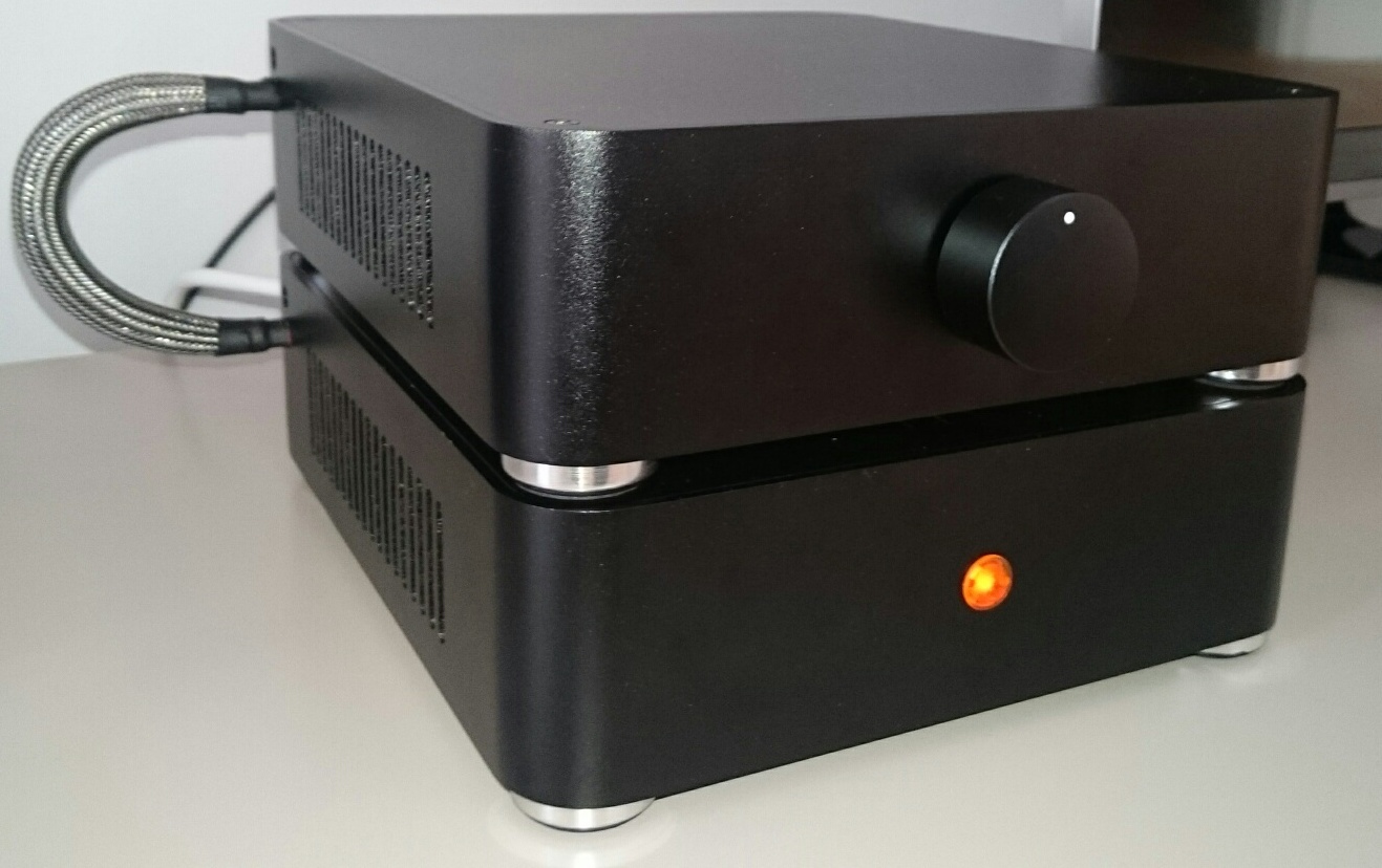

I decided to go with Volumio but have tried archphile and others as well. I like the web-based player option, so that everyone can use its own mobile w/o any set-up to control the full music library. Ease of use was important, since I wanted to come home, press play and everthing is working (auto-on at the mackies and automatic server start of the Freenas box).
How can you control the rs232 via RPi2? I have seen the Arduino set-up. Right now, I used a USB-serial converted and integrated it into the existing 2 USB slots of the case at the right side (the other USB for the Xmos USB Input). Since I do not want to change the filters each day it should be fine but would be interested in the RPi2 set-up.
Since the Xmos and the RPi2 is using the same I2S pins, have you seen a good way to switch beweetn the inputs? Also can the RPi2 make the insput selection?

RPi uart is GPIO pin 8,10
Be sure to turn of console : UART Pins – Raspberry Pi Projects
Have a look also at the python scripts to control DAM1021..
https://github.com/fortaa/dam1021
https://pypi.python.org/pypi/Mopidy-dam1021/0.4
Odroid C2 looks promising for USB and i2s as RPi 2 will have 192K limit (onboard oscilator)
Squeezelite v1.8.4-720 compiled (aarch64) with DSD works good for DSD128/DOP (352,8/384K)

Too much HF from the RPi to reach all the way would be my guess. Only a simplistic, but not too simplistic solution, would be the best.
For the higher end files, I have included a XMOS DSD DXD 384kHz high-quality USB to I2S/DSD PCB, that can be connected through an adapter to the USB socket in the case, so you can plug in an external USB source and play your DSD files (not test with DSD yet but with 192khz flacs.
