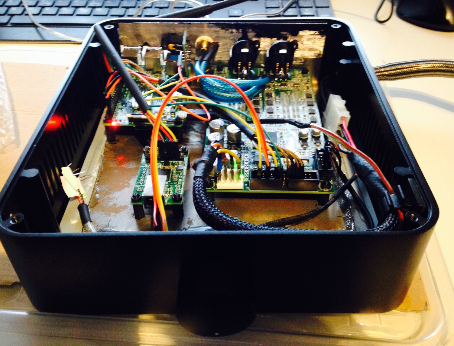

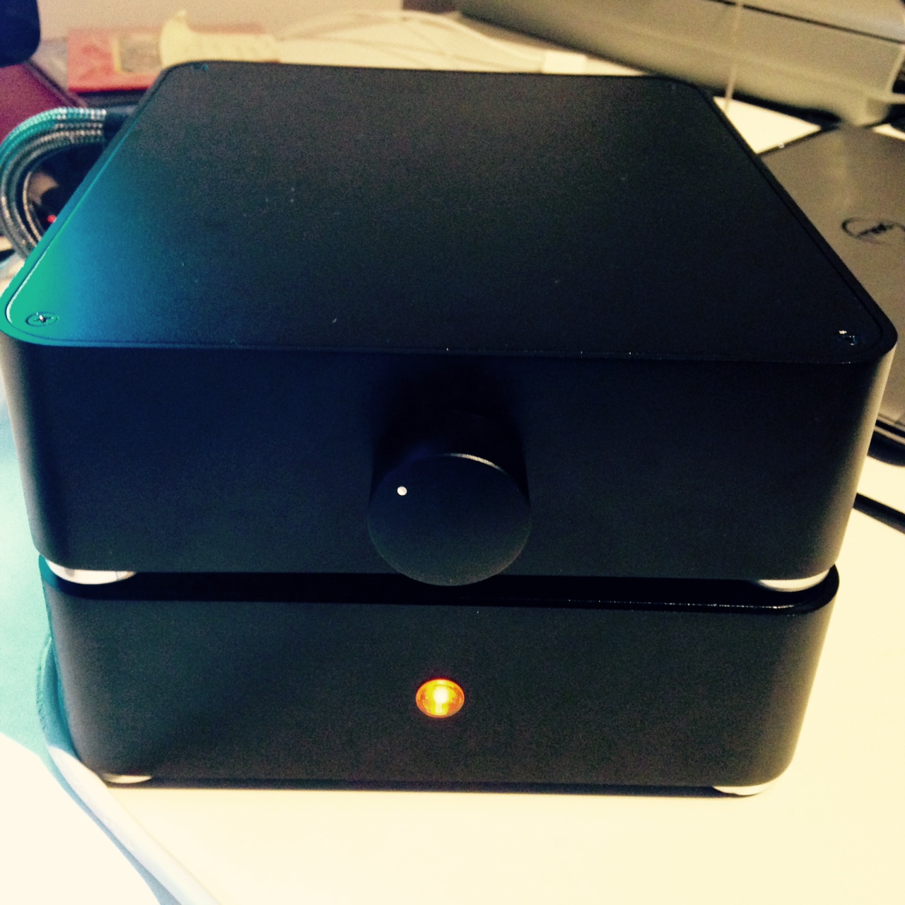

Hi everyone,
after the last months reading through various forums, my plan was to built a reference DAC/Streamer on basis of RPi2, Soekris DAC, hifi power supply (in seperated case) for low costs and without any prefessional equipment (living in an appartment). Goal was to have a reference DAC for 500-600 EUR, that everyone can build w/o any knowledge about electronics.
- Rpi 2 with Volumio 1.55 (I2S to Soekris Dac)
- Toslink input (automatic switch between RPi2)
- Xmos USB input
- 2 x 12V DC ultra linear power supply (for DAC)
- 1 x 5 V / 3A power supply ( for RPi2)
- 2 x Mini ITX alu cases to separate power supply from DAC (2 x Realan w60)
- Integration of serial port to USB
- Power switch and 230v filter
- Wlan n-Draft
- Hardware volume control
All is connected to a selfmade Freenas box.
Sharing of parts list and questions welcome since this is the least I can offer after getting all the information from this forum.
Sound is superb, runing the system directly with 2 Mackie HR824. More to come.
