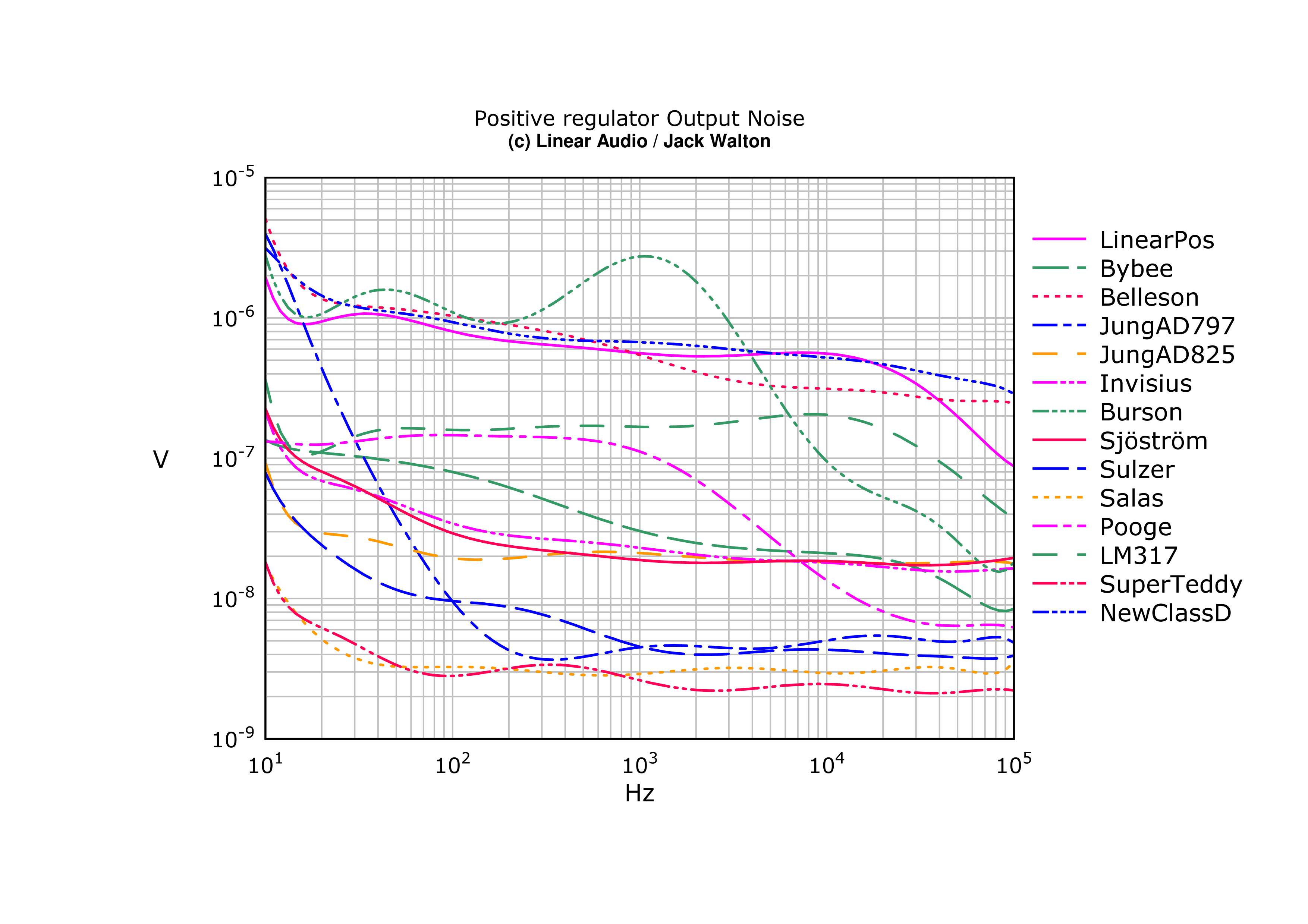

No problem here, but out of experience it just sounds a lot better. Interesting comparison:
There is a reason that so many folks in this forum use those regs. To me it turns a very good device into an outstanding one.
So you're assuming this comparison on a test jig translates directly to this specific application? I.e. you're taking the chance of buying a set of new, and more expensive, tires for your car, having no idea what size they actually are, and assume they'll just be a perfect fit and will improve your ride?
Are you familiar with the terms trace and cable inductance and capacitance? And ever wondered why local regulation is far superior to having an outboard regulator that's wired in with flying leads?

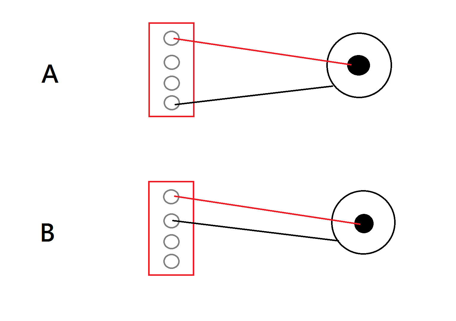

2. About balance (dual dam), if I want to connect to RCA output, should I just connect the first pin (as +ve) and forth pin (as GND) rather than the first and second pin?

2) RCA is single ended, should connect to signal + and gnd.

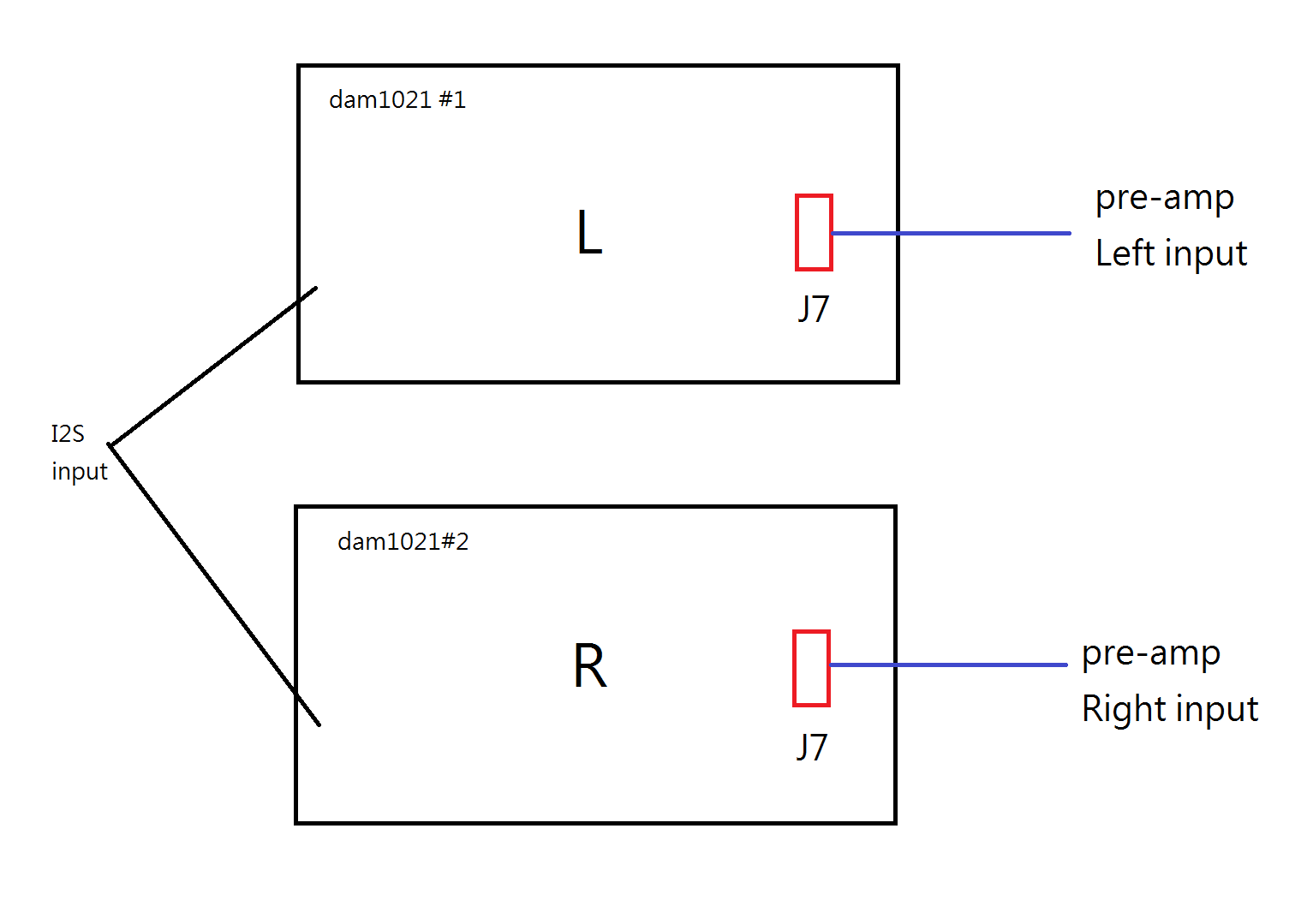

My case is like the figure shown. So it must be connected like "B"?
