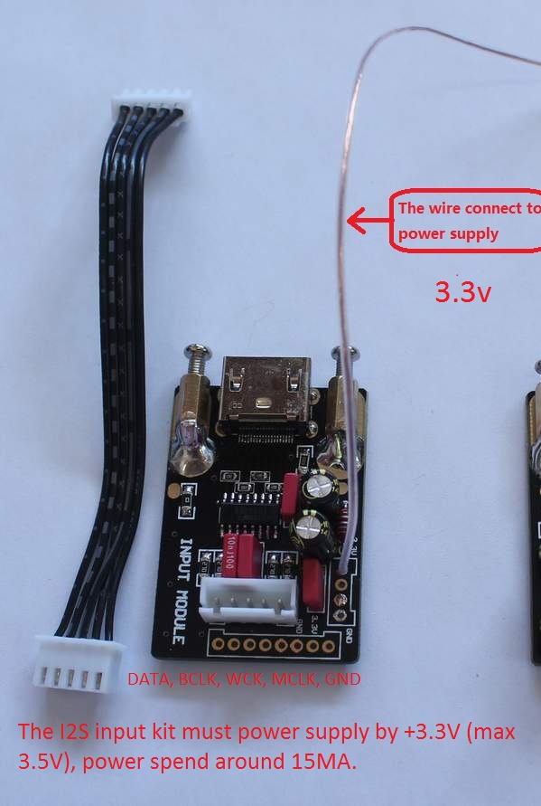

Has anyone tried direct i2s connection? Based on what configuration (the I2S source) and how's the result compare to isolated I2S of the same configuration? I'd like to explore the possibility of such and know how to connect the 3 wires. Thanks
I also would like to know more. as i'm going to be installing an HDMI i2s module from Audio-GD
the input module. I plan to feed the soekris from my DIU8 (xmos)that I modded with NDK clocks. and will output via hdmi output to the soekris hdmi input. I hope this is possible? proper wiring? wondering where all the pins would go on the input board, or ? i'll be using two dam1021's
I would love to compare direct i2s HMDI vs my waveIO
plus it's just nice to use my DDC to control all my dacs
http://www.audio-gd.com/Pro/diy/I2Skits/HDMISOC.JPG

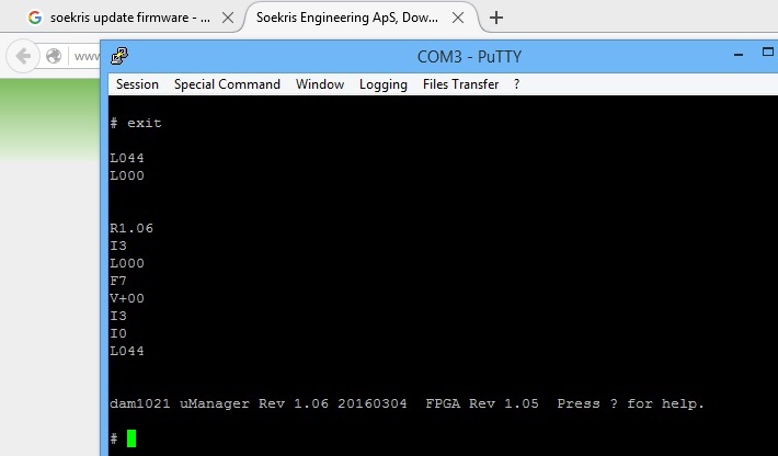

I have just downloaded the newest firmware ver. 1.06 to the dam1021, but the uManager says that the FPGA firmware is still rev. 1.05. How could that be?
Isn't 1021full_106.skr supposed to the full monty including uManager, FPGA and filters?
I have even done the whole process at least three times just to make sure I got it all right.
It might not be that clear, but if you read a little more on the download page you would notice that only the uC firmware is updated to 1.06, the fpga stays at 1.05....

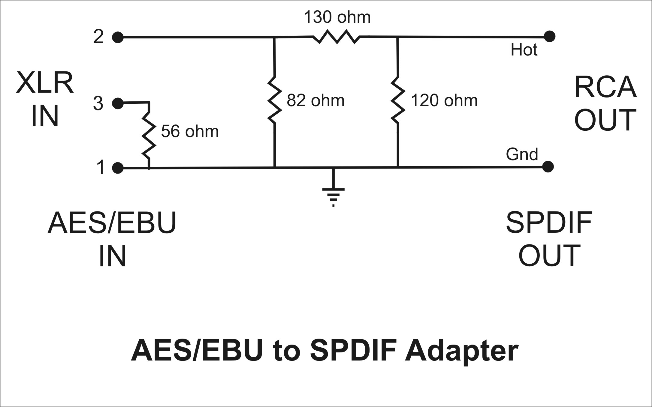

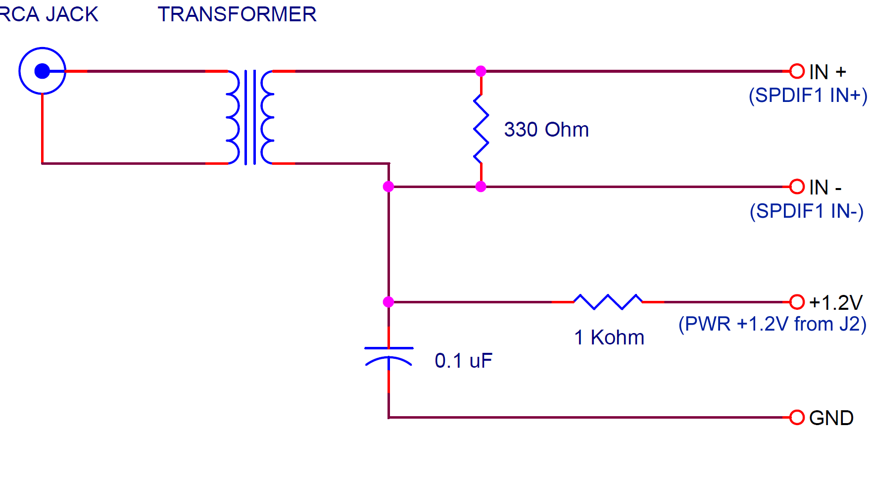

Hi Soren,
If I want to connect AES SPDIF connector to dam1021, should I add a AES to SPDIF circuit before the circuit you mentioned in official doc? Or is there a better way?
I am running dual dam1021 as balance, is the connection for SPDIF the same?
