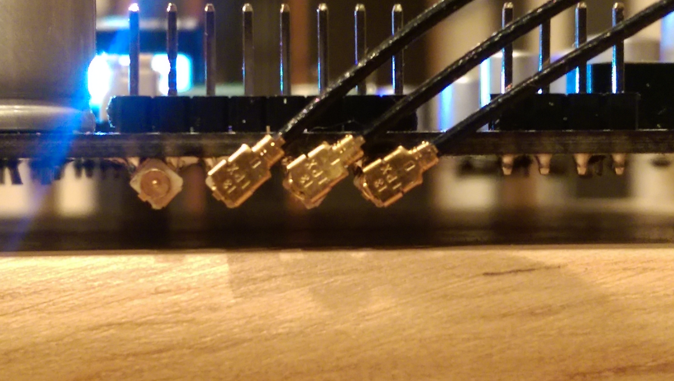

Thank you Greg for sharing your experience.
The SD Trans board has also uf-l plugs outputs ?
I remember even Supra member having said it heared a difference with a Pi and I2S when feeded by battery despite all the IanCanada Front end!
All those FIFO, isolator stuffs, reclocking if clock is good are a big plus to the sound but the quality of PS supply stays important and introduce some changes ! I'm testing that with TS7A regs myself on such FrontEnd with for instance a different smoothing cap before the TS7A chip : changes can be big enough, mainly the highs are changing on my setup : being more or less relaxed, harscher, etc ! That's I thinked from the whole beginning of the first Dam DAC : supply could be dramatcly improved as some made it after. I assume Soekris dac can certainly be good with all the effort on filter and supply as the base is good enough... I'm asking myself how it can sound now side by side with a full moded AYA 2 for instance in real life ?
Haven't tried LiFoPe4 yet... some did already.

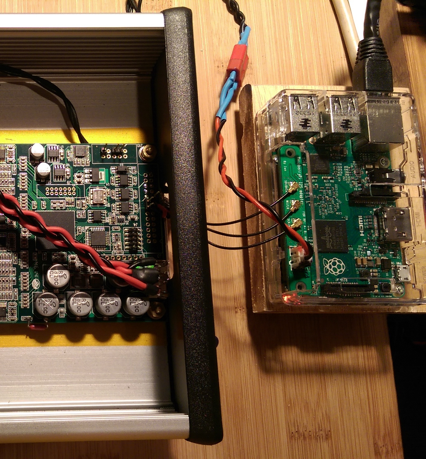

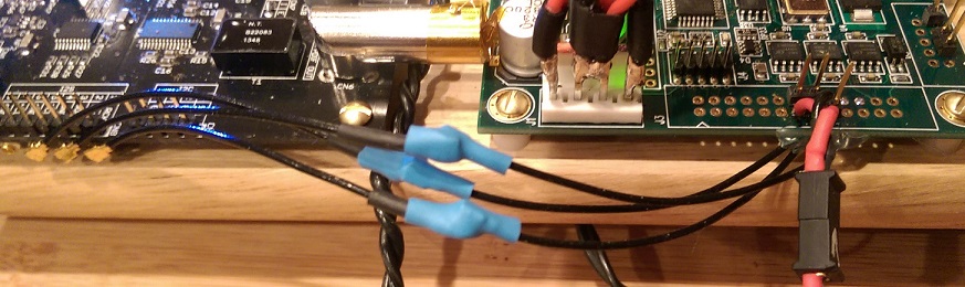

I added u.fl sockets on the bottom of the I2S headers... then use short male-female u.fl cables to match to the u.fl cable pigtails I soldered onto the DAM isolated I2S inputs... see attached pix.
I also included a picture of my R-Pi->DAM setup... it uses Ian's R-Pi adapter, so also fed via u.fl.

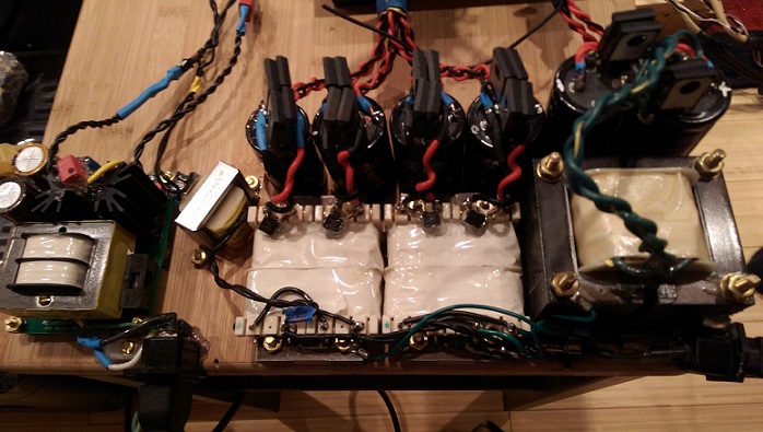

I have a number of power supply & output stage upgrades planned, but darn it, the thing sounds so good right now that it is sapping my will to do any of these! I am using a fairly high 13.5v+- input to the currently stock DAM right now, these are fed from a supply with good quality over-spec'd fast recovery diodes and 47,000uf Jensen 4-pole caps per rail.
I plan to do the upgrades in a fairly measured way, on one, then the other, so I can have some point of reference for each. I've done what I expected to be upgrades on other gear in the past that were not, so I try to do them in a way that allows me to assess and regroup if needed.
Battery power is on the menu as one of the last courses, but I'm trying to get them to sound as good as I can with AC-sourced supplies first.
Greg in Mississippi
P.S. The 9 different supply rails are not all used right now, but will all be used as I upgrade the power networks. Note that the supply diodes and caps by themselves cost about 2x that of a DAM board, but I believe that one's power can never be too good!
