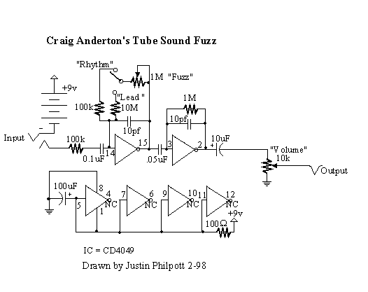

If S/N ratio of the guitar is the focus, an on-guitar preamp can help a bit, making the signal bigger, and lowering its impedance, before sending it out into the hostile world via the guitar cable....

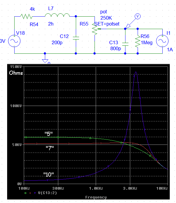

The *pickup* is 4k resistive bass to low-mids and ~~100k resistive at its top-peak, roughly 3kHz. That upper peak is the most annoying, though it is not wide.
As Gnobuddy keeps saying, as soon as the axe knob comes off of "10" a lot of this reactance is swamped-out by the pot. Half down you can just pencil "50k" and nobody can show you wrong. Those in-between 5 and 10 points deserve attention, but not too much. If it mattered, we'd put the first stage IN the guitar. Microphones did that before WWII.
That's IMPEDANCE, not resistance---resistance doesn't change with frequency, as far as I know.
PRR is right. The impedance peak of 100k or more at around 3kHz resonant frequency is in fact a pure resistor of several 100k . That is the real part of the complex impedance and a matter of circuit losses, 10k of dc resistance being one contributor. With zero DC resistance and no losses at all the ideal parallel resonant tank would have an infinite impedance.
...resistance doesn't change with frequency, as far as I know.
That's probably the definition (the marginal cases don't matter).
Impedance is both resistance and reactance. Only the real resistance hisses. However the effective resistance in a maze of parts can be different at different frequencies. In this case the pickup is a tuned circuit and sure can have several resistance values.
First plot. Apparent resistance vs frequency for a guitar input network at several pot settings. The level part of the Z is the R. In the lows it is just the 4k DC resistance. But it is also "level" at the top of the 3.5kHz peak. This hisses like a ~~100k resistance.

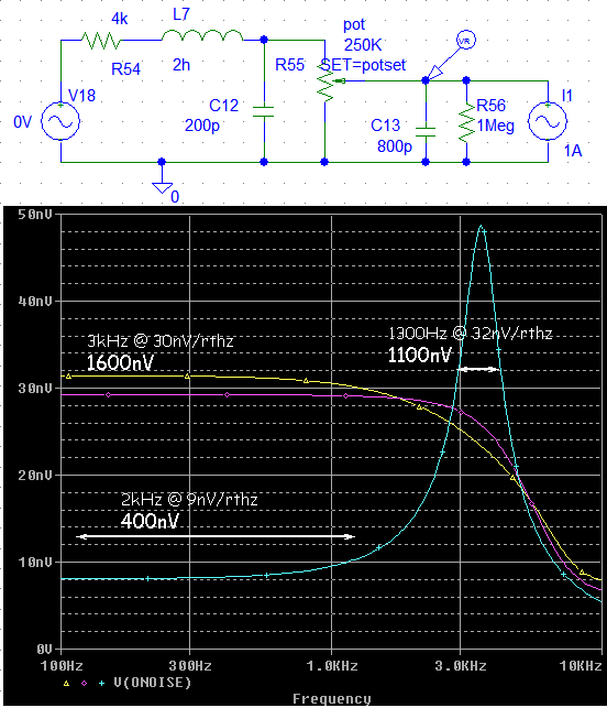

Not trusting my eyeball, I found a noise plot function in my sim. It does well on passive networks (active part models don't always have the details). Second plot shows ONOISE, referred to pickup internal generator, at several pot settings. At "10" the LF hiss is very low. It rises to a peak at 3.5kHz.
Taking a rough integration over frequency bands we have a narrow but high peak amounting to a microVolt, with most else amounting to a half-uV.
The turn-down noise is flat at 1.6uV. This is the noise *referred to source*, inside the pickup. Referred to the amplifier input the "5" hiss would be 2X less or 0.8uV. (in 5kHz bandwidth not the 20kHz band often assumed in hi-fi) So yes the 12AX7 and TL072 are not "noiseless", giving like 4dB Noise Figure.

Another cup of tea is the residual noise with vol pot at min, i.e. amp input shorted. In that case voltage noise of TL072 with 18nV/sqrt(Hz) makes an audible difference compared to OPA1654 with 4.5nV/sqrt(Hz). For regular playing the guitar this is a minor effect - but to be frankly - I like it dead quiet when turning down the vol knob and just for that reason I use OPA1678 in my pre-amps.
