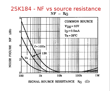

So I looked up the 2SK184 (JFET) datasheet. It includes a graph of noise figure vs source impedance (attached). It turns out that for this FET, noise figure is very good for source impedances between 10k and 200k, roughly speaking, and still quite good at 1M source impedance.
Still: noise figure isn't the same thing as effective input noise voltage. A 2 dB noise figure at 200k source impedance means more noise than the same 2 dB noise figure at 10k source impedance. For this JFET, a conservative design approach would be to make sure the input cap reactance doesn't exceed 10k within the frequency range of the guitar...which would require a rather large input cap of about 200 nF (0.2uF)!
I would have liked to calculate the 2SK184's noise figure of merit (noise voltage spectral density / noise current spectral density), but neither of those parameters is listed in the datasheet.

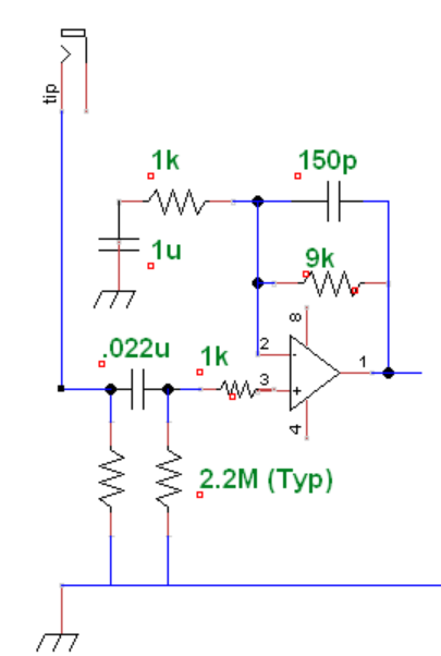

I wonder if that is the goal of this scheme:

The noise figure vs source impedance graph I posted earlier (from the JFET datasheet) gives you an idea how this works. At very low signal source impedance, the source itself has very good SNR, so the noise from the JFET is significant, and so the noise figure of the JFET isn't great. Between roughly 10k and 200k source impedance, the JFET is incredibly good, adding virtually no extra noise of its own - it's very well suited to such signals. Above 1 mega ohm or so, the JFET is starting to get noisy, and the noise figure worsens - because the JFETs input noise current is now starting to cause problems by interacting with the large source impedance.

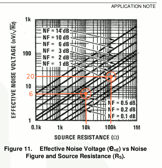

One of the noise-related links you posted earlier included the attached image, showing noise figure curves against source impedance.
A bare guitar pickup is in roughly the 10k source resistance ballpark at very low frequencies. A 500k guitar volume pot set to 85% rotation (half resistance) causes a source impedance of roughly 125k. I've plotted those two points against the 1 dB noise figure curve. They tell us what sort of noise input voltage we need for a very good guitar preamp.
Looking first at the 10k value, the corresponding noise voltage spectral density is about 6 uV / root Hertz. Find an op-amp this good or better, rip out the guitar volume control, wire the op-amp direct to the single pickup, and realistically, you can't do any better in terms of noise.
Most guitarists would much rather have a volume control on the guitar than a couple dB less hiss. That means the guitar source impedance might go higher than 100k - and, from the graph, the corresponding noise voltage spectral density is around 20 nV / root Hertz.
This is right around the TL072's specified noise voltage of 18 nV / root Hertz!
So the "bad" TL072 is actually virtually perfect if your guitar has a volume control, and you actually use it. The venerable and unloved TL072 gets you all the way to an excellent 1 dB noise figure, and you cannot do significantly better than that at any cost - there's only 1 dB of improvement possible, and a 1 dB change is barely detectable by the human ear.

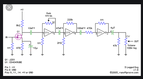

The Three Legged Dog schematic is attached - this was designed and published on the Internet by the guys behind Runoff Groove, so I don't think there are any copyright issues in posting it here. The 'Dog uses a JFET input buffer cum gain stage, followed by two CMOS 4049 digital gates (biased to operate in linear mode) to generate the distortion. All stages are AC coupled to each other.

After a lot of thinking and experimenting and simulating, I've come to the conclusion that the key to better-sounding guitar distortion is that the duty-cycle of the output waveform varies with time, from note attack to final decay.
This happens naturally in a valve guitar amp, because of the way grid current flow affects the DC bias conditions on each amplifying stage, in a way that varies with input signal amplitude.
A single op-amp diode clipper stage doesn't exhibit this effect at all - it produces mathematically precise clipping with a fixed duty-cycle though the entire guitar note, and this makes for a much more monotonous sound, at least to my ears.
The three good-sounding distortion circuits I've mentioned in this post all use "imperfect" distortion elements - JFETs, digital logic gates, BJTs. The AC coupling and imperfect nature of the devices causes DC bias voltages to shift with incoming signal strength; this in turn causes the output duty cycle to vary. And, whaddya know, these sound more like a real guitar amp, and less like the boring buzz from most distortion pedals.
