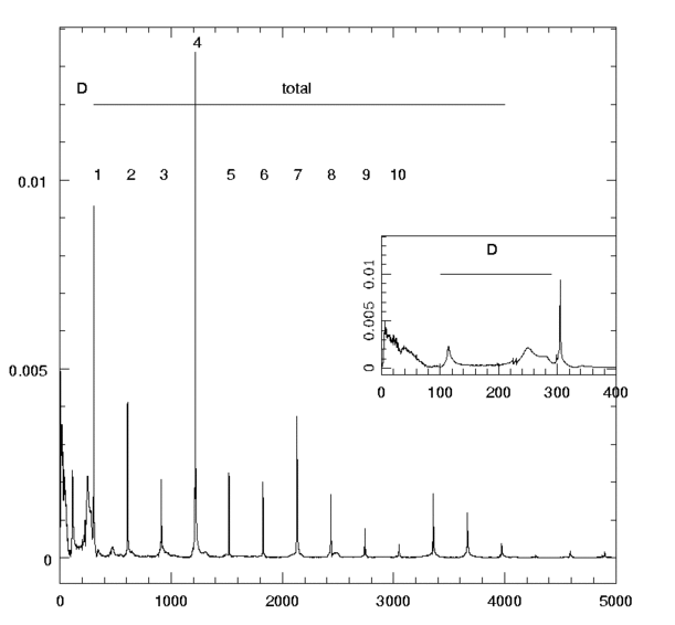

Real music is far better at covering up harmonic distortion than pure sine wave test signals are. In other words, it's harder to detect amp distortion when listening to music; it's easier to hear amp distortion using a sine-wave test signal.
The reason is simple - real music already contains many, many harmonics and other overtones. For instance, look at the attached FFT of a single plucked (acoustic) guitar note.
In that image, I see 15 overtones (16 spikes total) strong enough to be seen above the noise. The 4th harmonic is stronger than the fundamental (a common characteristic of guitars, because we don't pick the string near its mid-point.) The 7th harmonic is quite strong, and even the 11th harmonic is surprisingly strong.
So if our amplifier now adds a little bit of its own 4th harmonic, say, it gets mixed in with the 4th harmonic already present in the guitar note itself - your ear/brain is not going to hear anything new.
If the amp produced enormous amounts of 4th harmonic distortion (25%, say), you would hear a change in timbre of the guitar note. But small amounts of amp harmonic distortion will just go unnoticed.
By contrast, a pure sine-wave test tone has no harmonics of its own. So if the amplifier generates a little THD, there is a much better chance of your ear/brain noticing it.
That spectrogram shows an instrument (acoustic guitar) which sounds pretty "clean" - it doesn't have strong harmonics, compared to many other classical musical instruments. A violin, say, or a clarinet, has far stronger overtones. And a full orchestra or band puts out so many frequencies all at the same time that it's not at all easy for the ear/brain to pick out small amounts of amplifier distortion.

P.S. Guitar pluck FFT taken from here: Guitar Pluck

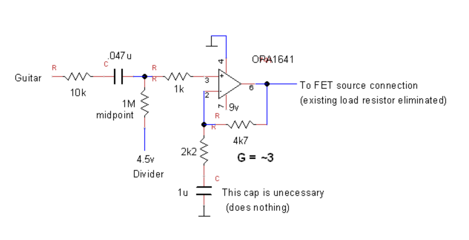

Here's what replaced the first stage FET buffer in the MT-2. All the resistors in the schematic wound up being Vishay 0.4w thin film, since they are high quality, low noise, and have the 1/8w body size which fit well in this cramped unit.
There was a noticeable noise improvement with just the resistor changes. The first version was set to G=2 in the interest of keeping the feedback resistor values low. The improvement over the resistor change was minimal.
The gain was increased to G=3 and abracadabra, the noise has been reduced to about 2/3 what it was. Surprisingly, there was no need to reduce the bypass output. In fact, with either gain version, the output was slightly attenuated. Moreover, the 220k Rf on the second stage opamp was left alone, since all the controls functioned about the same as stock. At some point maybe that will be upgraded with an OPA1611 on a DIP to SIP adapter, which I found reasonably priced. Leaving well enough alone for now.
Thanks to everyone for the myriad suggestions and comments.
..All the resistors...Vishay 0.4w thin film...noticeable noise improvement...gain was increased to G=3 and abracadabra, the noise has been reduced to about 2/3 what it was.
Wonderful! Congratulations on a successful outcome! :cheers:

Your "does nothing" cap affects bass roll-off. Adjust to taste.
It was shorted and there was no audible difference in bass roll-off with the low E. I did not bother to investigate. In fact, I should never had added it in the first place. There is no high-pass filter in the original FET buffer.
