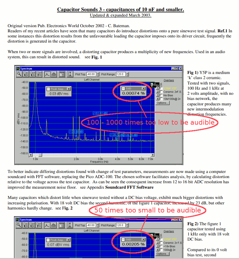

...... substituting one type of cap for a different (invariably more expensive) cap of the same value makes no audible change at all, despite legions of technically ignorant audiophiles making such claims.
I seem to distinctly recall an article (circa 1980) written by one Walter Jung that describes the clearly obvious improvement made to a Dynaco preamp by substituting film caps for the ceramics and electrolytics that were stock. Walter is no "technically ignorant audiophile" as he was one of the chief designers at Analog Devices and clearly one of the most brilliant electronics minds in audio.
...one Walter Jung...one of the most brilliant electronics minds in audio.
Absolutely brilliant people - including scientists and engineers - often hold superstitious beliefs that are contrary to all physical evidence.
As just one example, Linus Pauling was a genius, and a Nobel Prize winner in chemistry. He believed mega-doses of vitamin C protected one from the common cold. As the years rolled by, there was a growing mountain of evidence that this simply was not the case. Pauling never lost his superstitious belief in vitamin C's magic curative properties, though.
Walter Jung was an analog electronics genius. I would gratefully take electronics lessons from him any day. But if he claimed to have seen a unicorn in his backyard, I would want to see photographs, video, fur, scat, and a DNA analysis showing a hitherto unknown creature before I believed in his unicorn.
Magic capacitors are in the same category. There is a simple objective way for true believers to show that magic caps work, which doesn't involve magic ears, faith, appeals to genius, and unverifiable subjective experiences.
I explained that method in an earlier post in this thread. The equipment required is reasonably simple. Any number of research labs could easily do the experiment. In fact, plenty of research labs have studied capacitor behaviour - some caps are indeed better than others, but only at very high frequencies (far into the RF band), or at nearly DC (far below audible frequencies.)
If the magic caps work, why hasn't anyone done the experiment, and published the data? Play Beethoven or Thin Lizzy or Guns 'n Roses or Diana Krall, or all of them, through two RC networks with identical time-constants; one with a magic cap, one with a plebian plane-Jane cap. Subtract one signal from the other, amplify the result, show that there is a difference, and that the difference signal is no more than, say, 40 dB below the original signal.
Because there is no Yeti-DNA in sight, I don't believe in Yetis. If any number of celebrities swore they'd seen Yetis, I still wouldn't believe they existed until I saw the DNA analysis results.
It's the same story with magic caps - it doesn't matter how many audio celebrities say they heard the sound of the magic Yeti-capacitor. With no objective data showing magic audio properties of very expensive caps, I don't believe in magic caps.

I do appreciate the scientific approach, however, of Bateman's "Capacitor Sounds 4 - capacitances from 100 nF to 1 mF."
It appears from the graphs of most components, distortion and noise differences occur exponentially at either end of the spectrum, or both.
Virtually nobody will hear the difference between a ceramic disk cap and a polypropylene. There are too many variables starting with the way an instrument is played or a recording is produced, and ending with room acoustics. Players may very well be compensating for shortcomings in the instrument, amps or speakers, unbeknownst to them.

A preamble: Thousands of carefully conducted double-blind listening tests were conducted by trained researchers during the era when Hi-Fi was still a science, before it degenerated into superstition. The results were then statistically analyzed to verify if they were the result of random chance, or not.
As far as I know, after all those experiments, nobody has ever shown that people can detect less than about 1% - 0.5% THD. And that is only when listening to pure sine-wave test signals. (When listening to music, much higher levels of distortion are completely undetectable.)
Allowing a big fat safety margin, researchers concluded that THD below 0.1% would be the gold standard for Hi-Fi. Any device with such low THD has inaudible distortion - we can't hear any distortion at all, so the device is audibly perfect.
I clicked randomly on one of Bateman's papers from the link dotneck335 kindly posted. Bateman proudly writes about test data from an evil ceramic capacitor: it produced 0.00074% distortion!
This is just completely ridiculous. The measured distortion is more than a hundred times below the Hi-Fi gold standard of 0.1%, and nearly 700 times lower than the lowest distortion people have ever demonstrated the ability to actually detect.
Bateman then applies a mix of AC and DC to the cap to see if he can provoke more distortion. He did, to the tune of - wait for it - a whopping 0.002%. That's fifty times below the gold-standard 0.1%, and 250 times lower than the smallest distortion people have actually been able to hear.
So Bateman's work shows exactly what I've been saying: feel free use the cheapest ceramic caps with confidence in audio circuits, because their performance is audibly perfect; the microscopic distortions they produce are fifty to a thousand times below anything that human beings can actually hear.
Really, where else except in electronics can you get a wonderful bargain like that? A perfect component, for pennies? We are so lucky!
The only audibly flawed components in a modern audio chain are the microphones used to make the recording, the loudspeakers used to reproduce it, and the listening room itself. Even halfway-decent audio electronics has been audibly perfect for decades; that's why I buy 20-year-old Hi-Fi receivers from thrift stores, but put money and effort into buying the most accurate speakers I could afford (and they are still audibly flawed.)
-Gnobuddy
