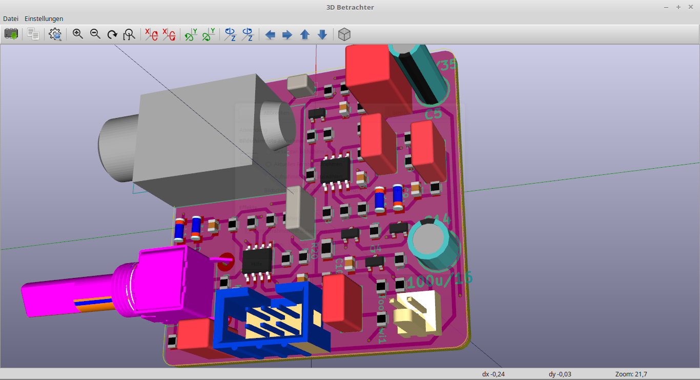

Humbucker Buffer/25k Volume Pot Update
There is no noise at all now so a gate is not required for hiss, at least. It's so low that it seems unreal. There is no discernible difference between the TL071 and the OPA1641 in terms of noise (in this context), but there was an ever so slight sound quality increase with the 1641. I used the Gotoh battery box because the others are rubbish.
Same goes for the capacitor types. I would throw in polypropylene on a top end guitar only. The orange drops are huge and would be a tight fit in most fuzz boxes, and wouldn't fit at all is some. But if there are other boxes in the chain that don't use them, I fail to see the advantage, except for peace of mind, and the awe of seeing the orange color with the covers off.

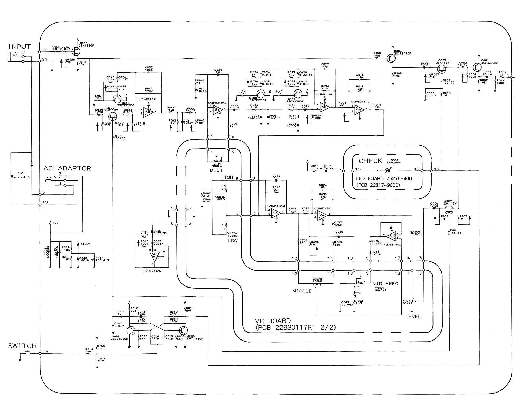

The first opamp in the box was upgraded from 4558 to 2114 which helped very slightly with noise. The 2114 is not recommended for apps that require a unity gain buffer without adding an input resistor, or else burn on startup. In that case the 2068 could be used as an upgrade if it's not feasible to add the resistor.
Further hiss reduction could be achieved with the use of the HB single coil mod, but this would be minimal. Reason being the 500k pot was the major problem at mid resistance point.

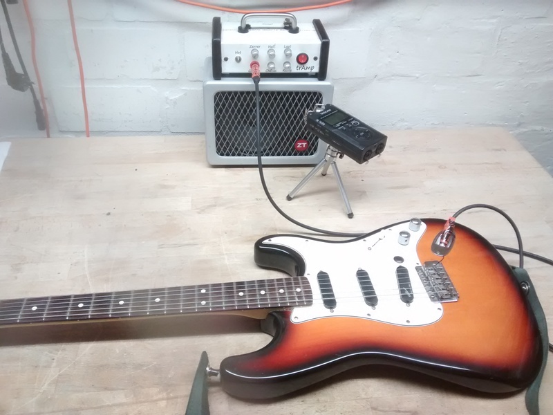

The DADGAD was tried with the fuzz box cranked and sounds pretty good. The neck bowed and had to be adjusted due the relaxed tension. Can't play too many strings just like in any tuning, but if a mistake is made, it won't sound too bad. Moreover, slide may be played with that tuning.
The pickup screws were adjusted for arc and the center two string sound more alive to a significant degree.
