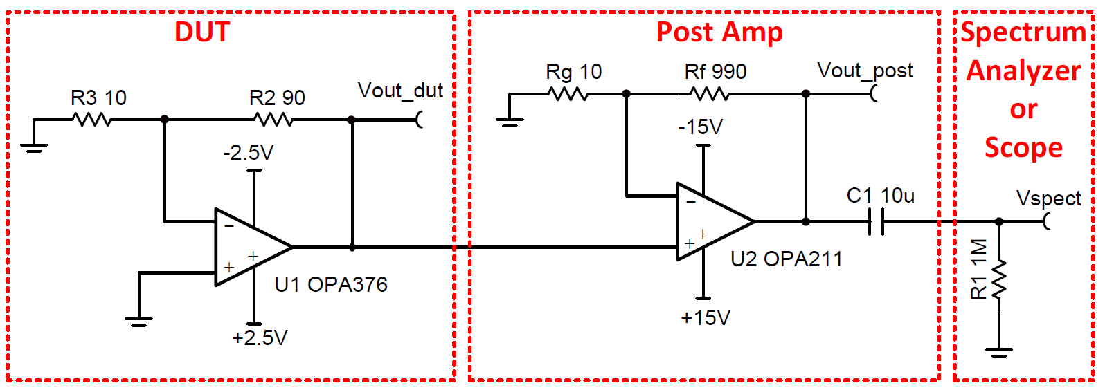

Incidentally, the opamp was blown by leaving out the 1u on the Rg leg. It only works for half-wave. I see the following schematic for a post opamp does not indicate any capacitors in the feedback circuit, just the G=100 resistor pair; The explanation the one brother proffered (waaaay back in this post) has not sunk in yet. Perhaps it had something to do with my low G=3 and the low rail voltage. Or is it esoteric knowledge all techs should know?

Hmm. Very odd. Leaving out that capacitor can sometimes have unwanted side effects, but blowing the op-amp is not one of them. I wonder if something else killed the op-amp?
Op-amps inherently work all the way down to DC, zero Hertz. If you leave out that capacitor, the voltage gain at DC is the same as the voltage gain at AC. This has the side effect that the internal (DC) offset voltage of the op-amp is amplified by the same amount as the incoming AC signal.
This in turn will push the output quiescent voltage away from zero volts. If, and only if, the input offset of the op-amp is big enough, it can swing the output so far off centre that it starts to clip one half of the waveform, or even just stays stuck full high or full low.
But this is not a destructive situation for the op-amp - it's no different than a big peak input signal swinging the output all the way to its positive or negative limit.
Op-amps are frequently used in circuits where they do, indeed, need to operate all the way down to DC (for example, in a voltage regulator circuit.)
But if we're using an op-amp for audio, we do not need response to DC. Not only that, we do not want response to DC - all it does is create more noise, make the circuit sensitive to infrasonic signals, and maybe cause so much output offset that the circuit doesn't even work properly.
So in this situation, we add that capacitor in series with Rg. Voltage gain is 1 + (Rf/Rg); if Rg now includes a capacitor in series, the impedance of (Rg+cap) increases as frequency drops. That means the voltage gain starts to fall when the frequency drops low enough. "Low enough" means when Rg equals the capacitive reactance of that series cap.
By the time the frequency goes all the way to zero Hz, the cap's reactance is infinity, and the circuit's voltage gain is just unity (1). This means the output offset voltage is no bigger than the op-amps own input offset voltage - which is usually a few millivolts or less. We've killed two birds with one stone - we got rid of the DC offset, and we got rid of the infrasonic noise problems too.
...the following schematic for a post opamp does not indicate any capacitors in the feedback circuit, just the G=100 resistor pair...
I wasn't familiar with either of those op-amps, so I had to look up their datasheets.
The OPA376 has a spectacularly low input DC offset of 25 uV, worst case. Set for a voltage gain of x10, with no cap to roll that off at DC, worst-case output offset is still only ten times 25 uV, or a mere 250 uV. Only one-fourth of a millivolt!
The second op-amp (OPA211) has 125uV max input offset voltage. Worst case, that will add to the 250 uV offset from the preceding OPA376 stage. So we have a worst-case 375uV input offset, times a voltage gain of one hundred, for a worst-case output DC offset of 37500 uV, which is only 37.5 mV. Tiny, in other words.
So yes, that circuit will work fine, as long as you use the specified op-amps. Substitute a generic op-amp for the ultra-low-offset OPA376, though, and the circuit will likely stop working altogether.

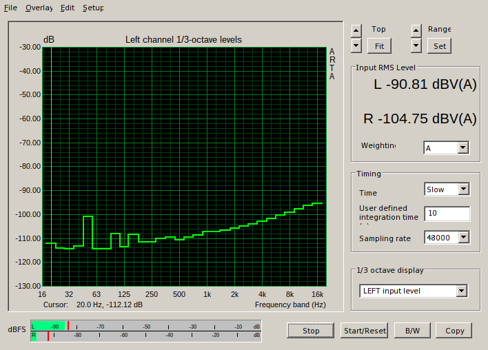

The 376 was the DUT for noise. There is no input. The second has G=100 so if the noise of the DUT is below the noise floor of the scope, it will now show up. The Boss MT-2 probably wouldn't need this.....
Someday I would like to set up a jig to test specifically for noise. I envision creating the entire circuit how it will be ultimately used, and roll parts from there until there is "no" noise.
Thanks for the explanation.

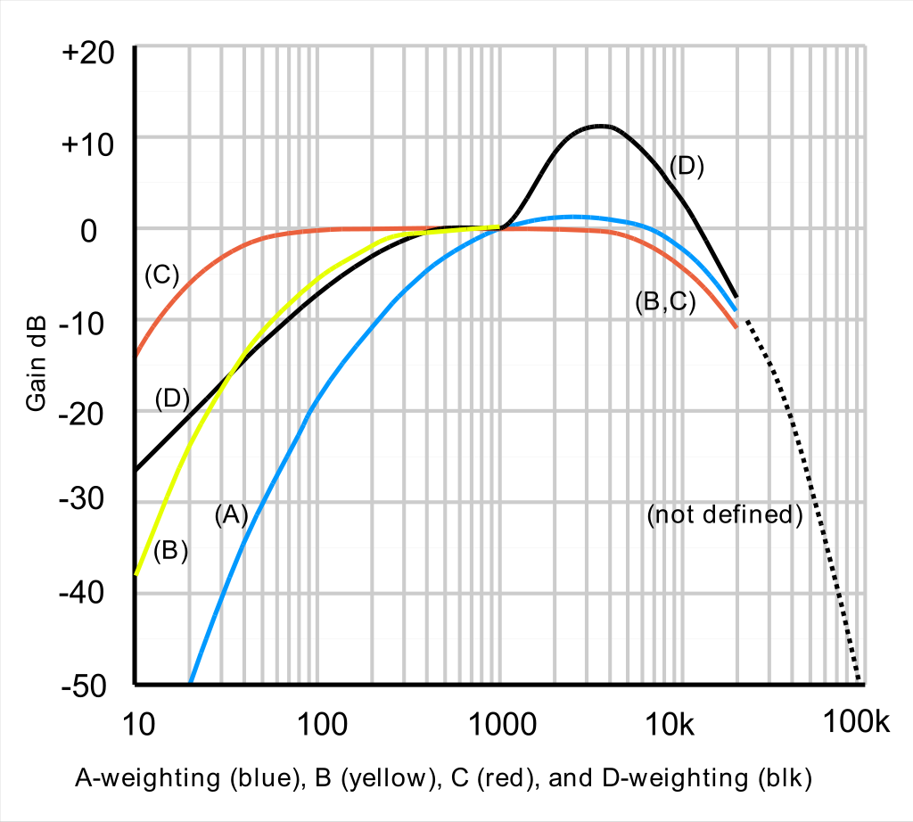

The amplified noise you see on your scope does not necessarily correlate to the noise you will hear. This is due to the fact that your scope has 100x more bandwidth than your ears. To achieve some comparable numbers you should better use a soundcard and a software like ARTA. The plot appended depicts output of my MOSFET amp where the input amp of the soundcard is set to minimum gain. With no additional amplification simply by turning up the gain knob of the soundcard I can resolve down to microvolts of noise.

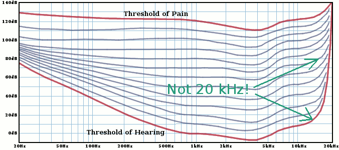

That depends on your ears. Generally I would suggest 20kHz being enough. And if we consider guitar amplification: Typical 12" guitar speakers end at about 5~7kHz.
A good approach is the a-weighting filter that is used since decades for such measurements.
So what do you consider the perceivable bandwidth and sensitivity of ears to noise?
0.01-22,000Hz. But in this context, the amplitude, and then treating the source, are the issues. Guitar amps are unable to reproduce the extremes, just by looking at speaker response graphs.
Yet we are talking about an amp that if you blow wind through your mouth on the first opamp or stage, it can be heard through the speakers. That's why ceramic caps other than COG are avoided. Stress-induced outbursts: Microphonics in ceramic capacitors (Part 2) - Precision Hub - Archives - TI E2E support forums
The color noise samples (White, Pink, Brown, Blue, Violet, Grey) I listened to all sound like the noise I hear out of the speaker, depending on how the EQ and gain are set. Colors of noise - Wikipedia
0.01-22,000Hz.
We can't hear 0.01 Hz under any circumstances, nor can we hear 10 Hz.
I found that a clean 20 Hz sine wave sounded like a moth fluttering inside in my ear, very unpleasant, and not like a sound at all. There was no definite audible pitch to it, just unpleasant fluttering. 25 Hz was about the same. By 30 Hz, I could hear a definite pitch.
At the other end of the spectrum, healthy ears undamaged by modern living can hear 20,000 Hz - but only if it's turned up loud enough to destroy your hearing, about 140 dB SPL!
I'm not exaggerating. Look at the first attached image. You can see that the the ear's frequency response only widens out to (nearly) 20 kHz at the top (right) corner of the graph - where SPL is far above the threshold of pain, up around 140 dB SPL, far into the range where your hearing is being destroyed.
At more bearable SPL (80 - 100 dB, i.e. from very loud to unbearably loud), the "corner frequency" of the healthy undamaged human ear is more like 12 kHz - 15 kHz.
In fact, many older electronics and acoustics books listed the range of human hearing as 30 Hz - 15 kHz, which, when you look at the actual experimental research data, was more realistic than today's 20 Hz - 20 kHz. We've had a bit of "grade inflation" there, as humanity has progressively lost touch with reality over the years.

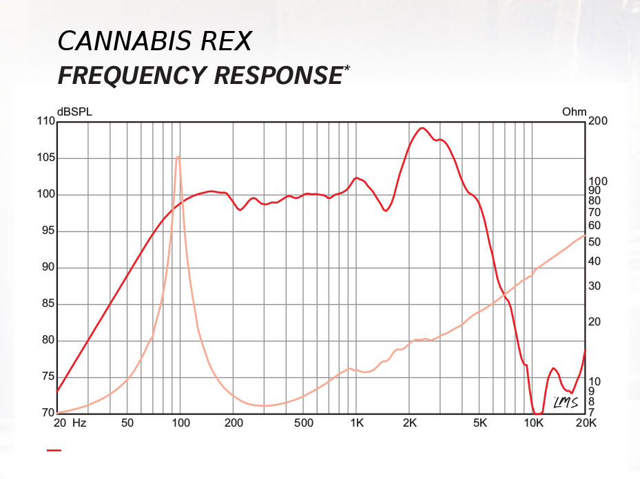

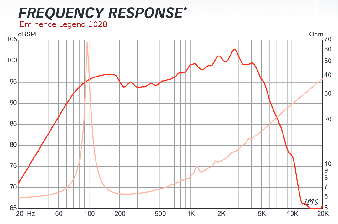

The second image I've attached includes the A-weighting curve Voltwide mentioned. You can see that both bass and treble are heavily attenuated, to mimic the insensitivity of the human ear at these frequencies. There is a peak at around 3 kHz, which is where hiss is most likely to be bothersome, because that's where the (undamaged) human ear is most sensitive. Frequencies below 200 Hz, or above 20 kHz, are heavily attenuated, and won't contribute much to an A-weighted measurement.
The next two images are guitar speaker frequency responses. Neither has much output below 100 Hz, even without A-weighting. Neither has much output above 5 kHz, even without A-weighting.

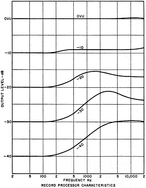

The last image shows the frequency response curves (varying with signal level) of the Dolby B noise reduction system, widely used with cassette tapes in the era before the Compact Disc. Designed by very clever and very educated people using lots of real research data on hearing, the EQ curves were chosen to produce the most significant hiss reduction possible, while keeping the circuitry simple enough to be practical for mass production.
This is done by boosting the most "hissy" frequencies when the recording signal is at a low level (improving S/N ration on the tape), then cutting the same frequencies back down by the same amount on playback, which cuts hiss further, and simultaneously restores a flat frequency response.
The graph shows which frequencies were targeted by Ray Dolby for his Dolby B NR system. You can see that basically they are the frequencies from about 1 kHz up. Full noise reduction (10 dB worth) was available above 4 KHz. Those were the frequencies that produces the most "bang for the buck" in terms of audible hiss reduction.
All this points to the fact that hiss is most audible (and therefore most annoying) in roughly the frequency range between 500 Hz and 5 kHz or so. Above and below that, the human ear is much less sensitive, and low level noises like hiss aren't very audible.
-Gnobuddy
