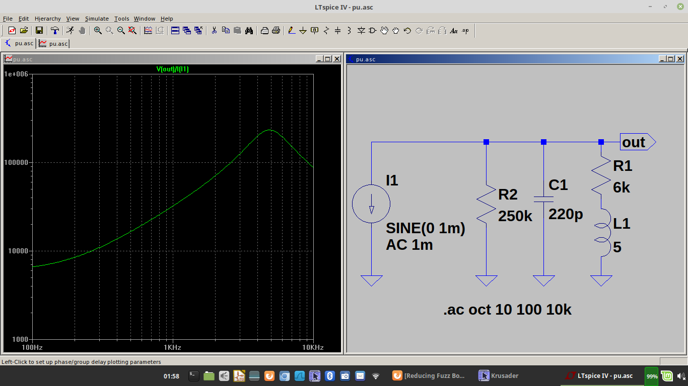

Would you kindly clarify this as it applies to the increase of "white" noise when the volume pot is backed off from 10?
I'll try. In case your pot is wired as a voltage divider between P.U. and and amp input, reducing from "10" increases series resistance of your source to a certain amount. With a JFET input I would not expect much difference, but with a BJT with its input noise current this will be audible. I should mention that for this reason the well respected NE5532 (BJT input) is a bad choice for guitar PU input producing much more noise than the TL072 (JFET input).
A simple LTSpice simulation illustrates impedance vs frequency of a typical magnetic pickup. Note that in the region of resonant frequency around 5 kHz there is an impedance peak limited mostly by the value of the potentiometer.
That is the region where we hear the "white" noise.

I'll try. In case your pot is wired as a voltage divider between P.U. and amp input, reducing from "10" increases series resistance of your source to a certain amount. With a JFET input I would not expect much difference, but with a BJT with its input noise current this will be audible. I should mention that for this reason the well respected NE5532 (BJT input) is a bad choice for guitar PU input producing much more noise than the TL072 (JFET input).
Somehow, somewhere, I suspected noise current might have played a part, but I could not see any if the pickups had no output. Then I wondered if whatever voltage leaks out of the FET gate causes enough current in the circuit that would increase noise. I guess this would be more true with a BJT base current, but again with no voltage being generated from the pickups, I could not see. 😎
So the noise source of interest is caused by the room temperature molecular activity in the volume pot. The "silent" active pickups reduce the length of the winding AND decrease the value of the pot by 20 times.
