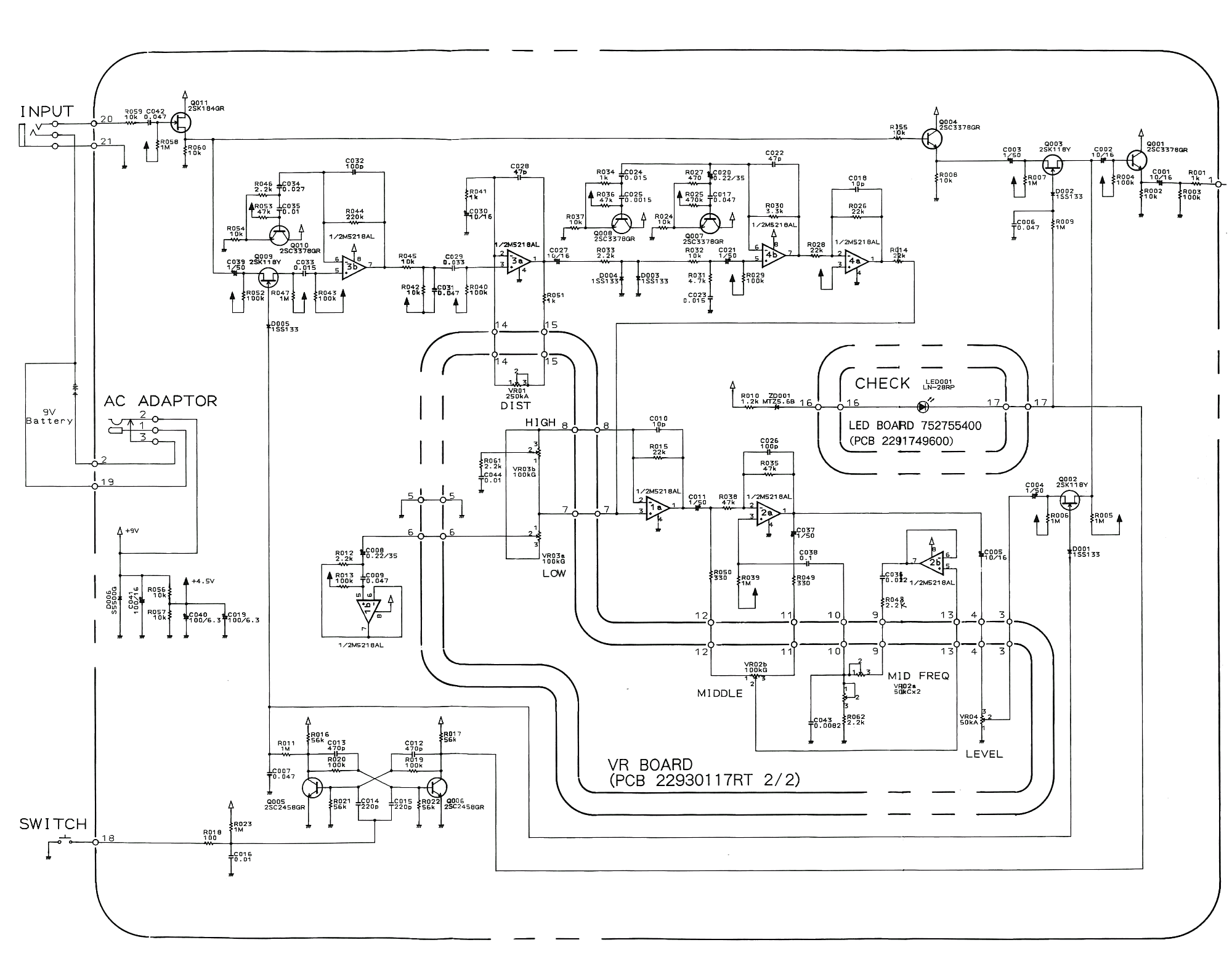

Because full osmosis has not yet materialized, I still have not full understanding of this complex circuit. But I just realized increasing the gain of the first stage will also cause the same increase when the unit is in bypass. Then it would be a fixed boost pedal with no adjustment, unless circuitry is added to compensate.
Off the cuff, it looks like the addition of a divider immediately after C003 would do it. Q001 would buffer the increased resistance. This mod will require trace cutting on the PCB. which is undesirable yet doable.
I might try the opamp in stage one as unity gain buffer and see what happens first, but any noise in stage two will not be buried as recommended previously, especially the 220k FB resistor 044.

We've had numerous op-amps mentioned here, and I thought it might be a good idea to do some actual noise calculations. <snip>
nobody plays metal with their volume knob halve way. Typical Gibson humbuckers have about 8K real impedance, so you can expect about 10nV noise density.
Shorting the 10k input resistor might lower the noise about 3dB.. nothing you can do beyond that, except practice on guitar pick atack, and uae a noise gate.

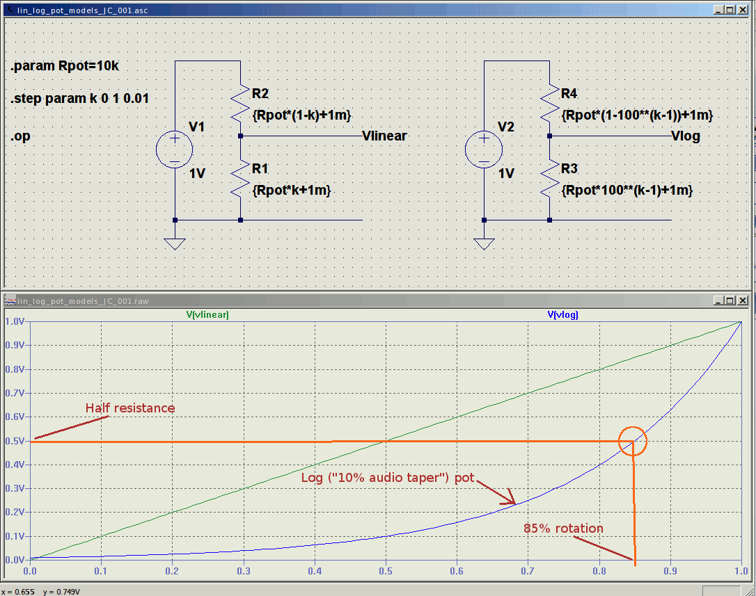

Remember, half-resistance is not half-way down on the volume knob - we're talking about a logarithmic pot.
The typical "10% taper" log pot has one-tenth resistance at half rotation. Half-resistance occurs at about 85% rotation, or less than one-sixth of the way down from maximum. (See attached LTSpice simulation of one linear and one log pot.)
ITPhoenix - who started this thread - said in one of his posts here that he uses his guitar volume control when playing metal, in order to create playing dynamics. (I think that means he plays a less extreme form of metal.)
