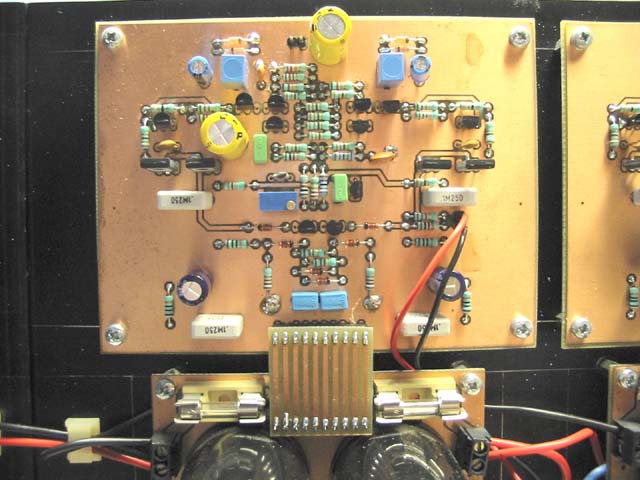

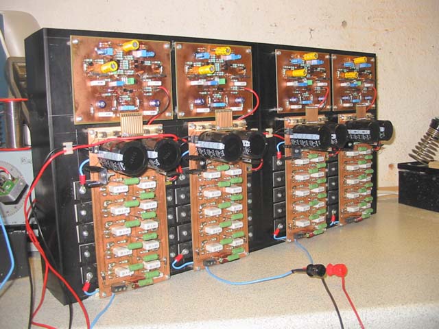

Progress
Here are some pics of the final amp modules
\Jens
