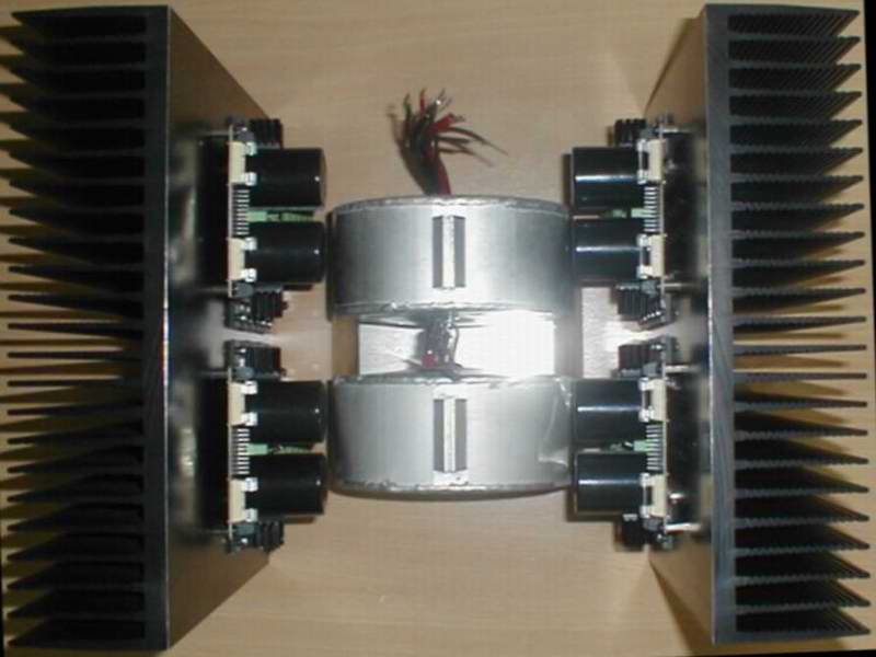

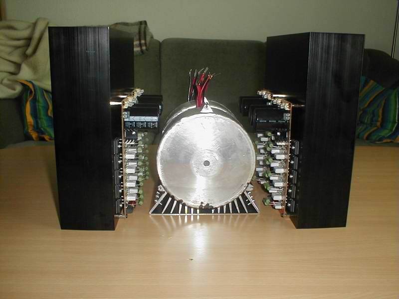

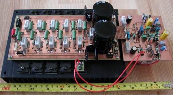

Prototypes done
Hi again,
I got the small signal PCB done today, and good news it's alive !!
Notice the read wires going in the air it's from the 4 thermal compensating diodes, here mounted on the back of one of the output transistors (to get a quicker detection since my heatsinks are 6,8 kg each it will take so long for the thing to heat up that it might cause damage to the transistors)
The small board connecting the two parts will in the final version have a groundplane on one side.
Consept:
General purpuse output board
Whatever input board you want to try out (other than the Leach)
any idears are welcome
\Jens

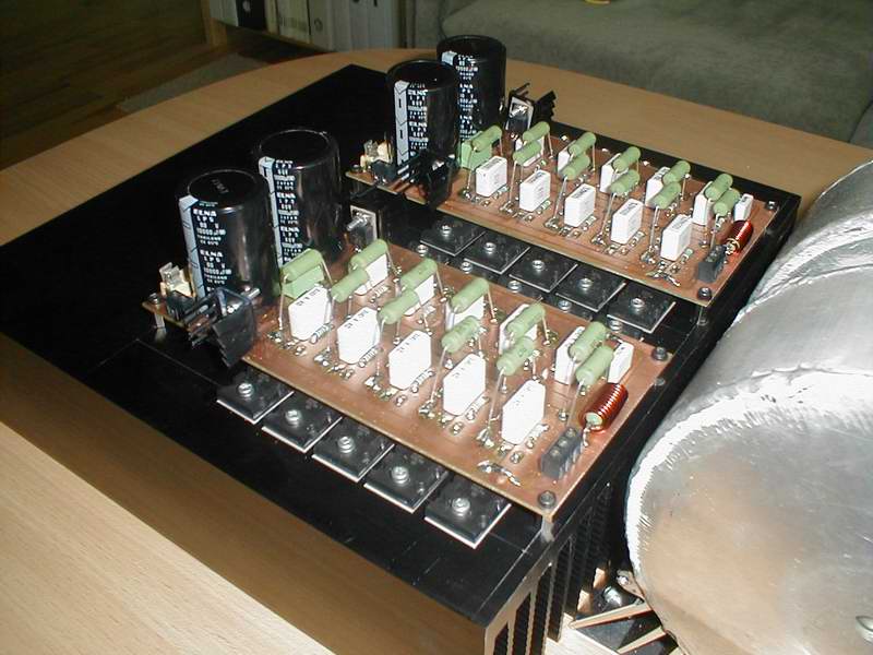

Some numbers and components
Well, i fired it up using:
Rails = 55 V That's what im ending up using, since I have two 800 VA transformers.
BC546B/556B in the input stage (If the originals are to be used (MPSA06/56) they need to be turned 180 degrees form the 546/56 models)
VAS an predrivers are BD139/40 (Will be changed into MJE340/50) when the arrive
Drivers are MEJ15032/33
Outputs are MJL3281A/1302A
Working current in each transistor.
All resistors are 5 % ones exceps the 11kohm they are 1% taken without testing their value.
DC ofset -20 mV
Since school has changed into win2k our test equepment is out of order, so I'll be back with THD measurements and freq response.
\Jens

PCB layout
The prototypes are about
Outputboard
10 * 20 [cm]
Small signal Board
10 * 9 [cm]
Double sided non plated.
I use a HP Laserjet 6L (Older model) and the "film" is som semi transparent paper from the schools bookshop (I'll se if I can find the brand it's about 1/4 US$ per sheet in size A4)
There is groundplane an rails on both sides of the PCB.
Ground plane means that I can make my starpoint in the PSU. (Not designed yet)
I use a program called Eagel for schmatics and PCB, It's really two programs running together, and thereby making sure that schmatics and PCB is correct compared to eachother.
I used a clear coating that you can solder on. (again I'll find the brand, it's from my school's workshop)
Carlmart why do you want all tracks wider ? I mean the input stage draws about 3 mA, no reason for a 250 mill track for that I think.
Thanks for any reply
\Jens

Hi
Today the first two of four outputboards got mounted on the heatsink, they both worked 🙂
I'm working on the final layout of the small signal PCB's, they will problably be ready in two weeks or so.
One question though:
The outputinduction, how big does it need to be ? I tried to freq. sweep the amps, and the response seem to flat until about 25 khz. I'd like it to go a bit higher, say about 50 khz or so.
\Jens

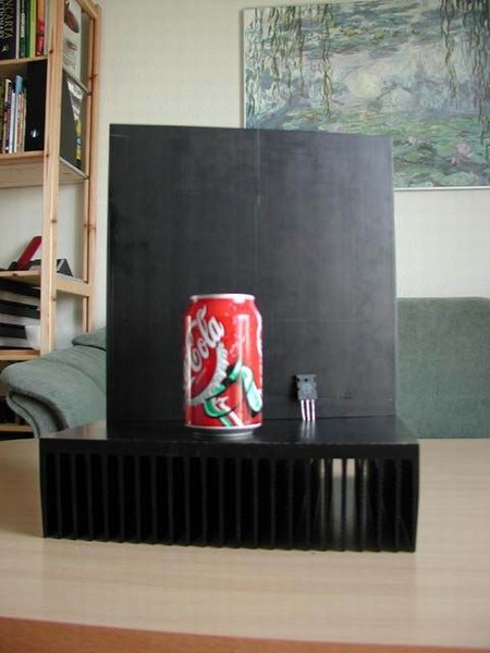

Hi
Well I don't know the brand of the heatsinks, I just ordered them from aavids danich destrubitor, I only know that it's a standard profile made in custom lenghts for me 🙂
Yes the amp will have four channels, I took the advice from a couble of people in the forum.
I mean to use it for Bi - amping, and for bridging when it's party time.
\Jens
