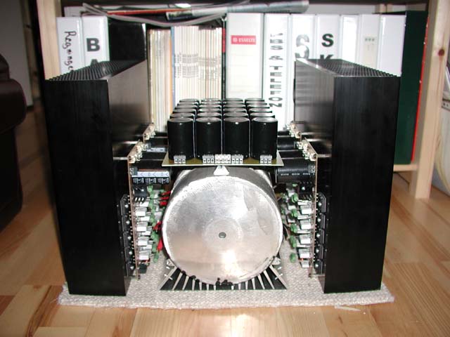

Supply board
Today I made the sypplyboard.... There will be a bank of 6 * 10000µF 80V caps pr. channel. In all 240 mF.
I also have 20000µF on each outputboard. I hope it will be enough to make a decent railquality.

OT: Heat sinks
Hi Jens.
I just surfed by this thread. Where did you get the heat sinks shown in the picture?

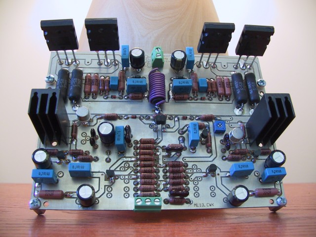

Hi everyone...A while ago I made my own version of the leach amplifier that incorporates the output transistors and rectifying capacitors onboard. It is single sided and fairly easy to build for diy'ers. I just set up a very basic website with pictures and layouts...feel free to use them, but please send my pictures of your final amps...

I finished soldiering my boards and tested them, and they work fine. I am going to send them out to a board production place and get a few boards made.

Listening to ½ an amp
Hi
Great to hear your amp is working Brian, how much are the boards ?
I now have two of four PCB's fully populated ad playing....sweet 🙂
I'll post pic's later.
There are no problems, and the sound is great (I'm problably biased but newer the less it's great)
\Jens
