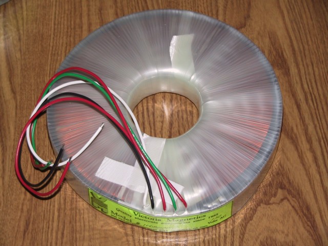

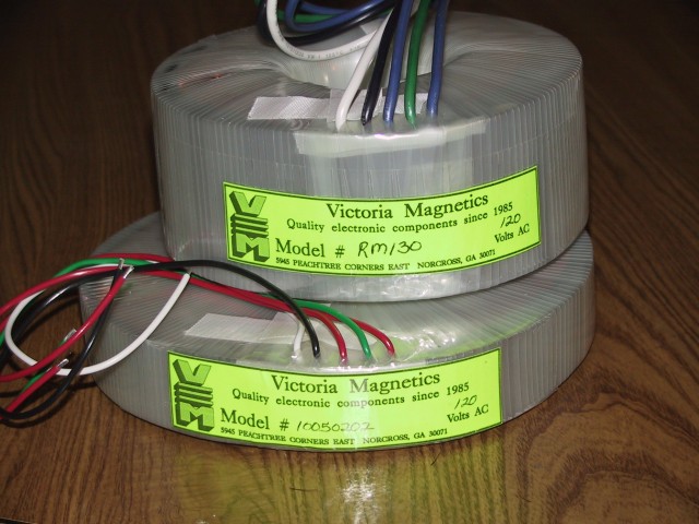

Jens:
>>b) The large caps<<
Right, caps at 0 voltage act pretty much like a dead short when the transformer turns on.
I'm looking at this issue now, I want to use a 1000va or 1500va amp for my 6-10 channel home theater project; I'm worried about inrush.
When looking at relays for output protection and turn on thump, I started thinking of using a capacitor bank, and then switching each set of cap's with a few relays on a timer. If I used DPDP relays, you could even use a fairly large resistor then when the caps get charged, they would self - power the relay to cut out the resistor.
On another thread there are some thermistor examples for the same thing, but I'd like to avoid the heat if possible.
Sorry for disgressing on the thread in answering the question.
The amp looks fantastic, by the way!
