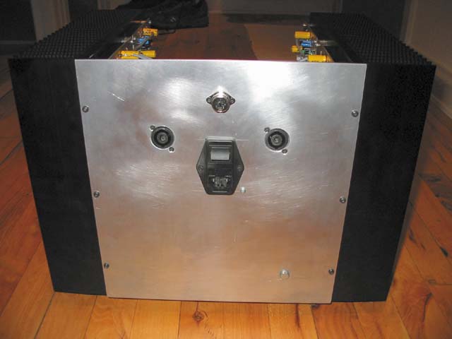

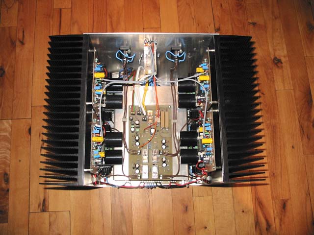

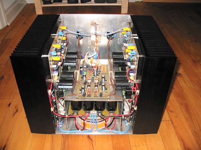

Hi all,
The thing is alive 🙂
I now need to sort out the top and front
\Jens

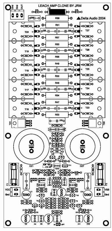

Hello all,
I have had several requests for my version of the Leach Amp, but lost my original layout some time ago due to a hard disk failure (I will now be making weekly backups).
Anyway I have remade the layout on one board with room for 5 sets of output transistors and 10000uF 100V rail caps. (40mm diameter)
Let me know if anybody is interested in a group order for these, and also if you have any requests regarding the PCB.
The PDF pic contains the layout, witch measures 120xx250 mm

Hi JENs,
Your version of leach amp looks good , can I request you to provide me the pdf files of the leach amp so I can do this amp. (of course this is my dream amp).
1. you have used 5 pairs of Output pairs, what was the purpose, can it increase the power or you have done this to handle loads down to 2ohms.
2. what is the max voltage rail you recommend.
3. can I use 2sa1943 & 2sc5200 pairs.
4. can you provide some details of your modified version.
Arasuk
Hi Arasuk,
I have done this to be able to play into smaller loads and to increase the rail voltages while keeping a decent SOA for the output devices.
So far I have only tested it with +-55V, but I’ll be making tests with +-68V when I get the proto PCBs
YES! And MJL4281/4302
Small signal transistors are BC546/556
Vas and pre driver are MJE340/350
Drivers are MJE15034/15035
Extra decoupling caps on board along with zobel network and fuses.
The rest of the components are more or less the original, I'll be making a BOM later when everything is tested
\Jens

Hi Jens,
Thanks for the reply,
1. I remember Mr.Leach pointing out that +/- 58v is the best possible rail voltage. do you think Increasing it will lead for SOA problem.
2. Then using BC546/556 would not be probably better ???
3. About the short ckt prot what values do you reccomend,and have you tested with these values.
4.Does the "diode array" need to be implemented on the heat sinks??? can I replace them with some To220 type diodes or with an BJT.
thanks
Arasuk
I think he means for the setup with two transistors.
I don't understand what you mean, please explain
I have tested them using +-55V, they need to be recalculated with +-68V!
You must place the diodes on the heatsink!! TO220 diodes could work well, for thermal tracking, not sure how the added cap to heatsink will influence the thing though
\Jens
modified leach amp
Hi Jens,
what I mean to about using BC546/556 was, the higher voltage rails might not permit this operation as the MAX Vce of 546/556 is 65v.
About boards,can you post me the pdf files, so I can do this amp.
Thanks,
Arasuk
From my simulations I don’t se a problem with the voltages exceeding the specs for the BC546/56 pair, but should there be a problem, I’ll just change to the MPSA92/42 pair. (They need to be rotated to fit the pinout, but I can live with that)
I will post the PDF’s needed for this project later, but first I need to verify a proto board as this is a new layout.
I will probably get some boards made, so if you are interested please let me know. Price will be around 60 US$ per board If I order 10. More boards will make it cheaper per board.
I am busy at work at the moment, so please be patient it will be some time before I can offer documentation.
\Jens
Hi Jens,
I think I need to do the hard way to fix the Diode array, Coming back to the O/P Transistors I will go with 4 pairs.
I would redesign the Short Ckt for Load of 3 ohms , so that I dont have problems of the The sudden Kick in of the prot ckt.
I Think If i am not wrong, we can use BC 550/560 low noise transistor for the Input current mirros. This would be the best choice for the input stage, of course the remaining stays the same BC546/556.
lowering the value of R51 & Gnd Hum may be reduced,
Reduce the value for the base resistors,& DO you think I can Reduce The Emiter resistor value for 0.15 ohms with matched O/P pairs.
Arasuk

Your design looks very good, Jens.
Apparently there's a ground plane that is not designed here, so here goes a question. Are the grounds split into "clean" and "dirty" grounds to be joined at a star point?
If they are not, splitting them could get further benefits to the project.
Carlos
